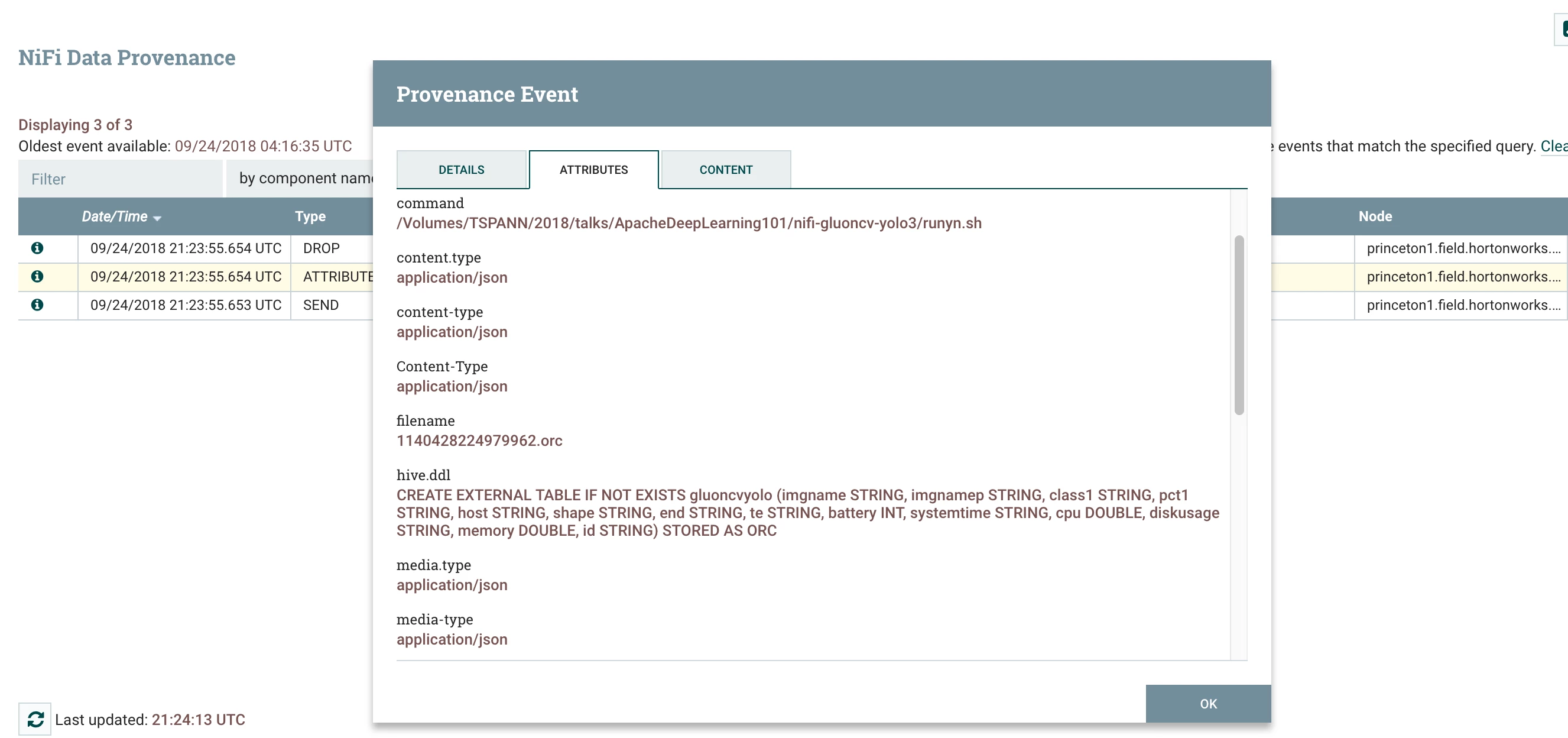

#1 Provenance - lets me see everything, everywhere, all the time with the data and the metadata.

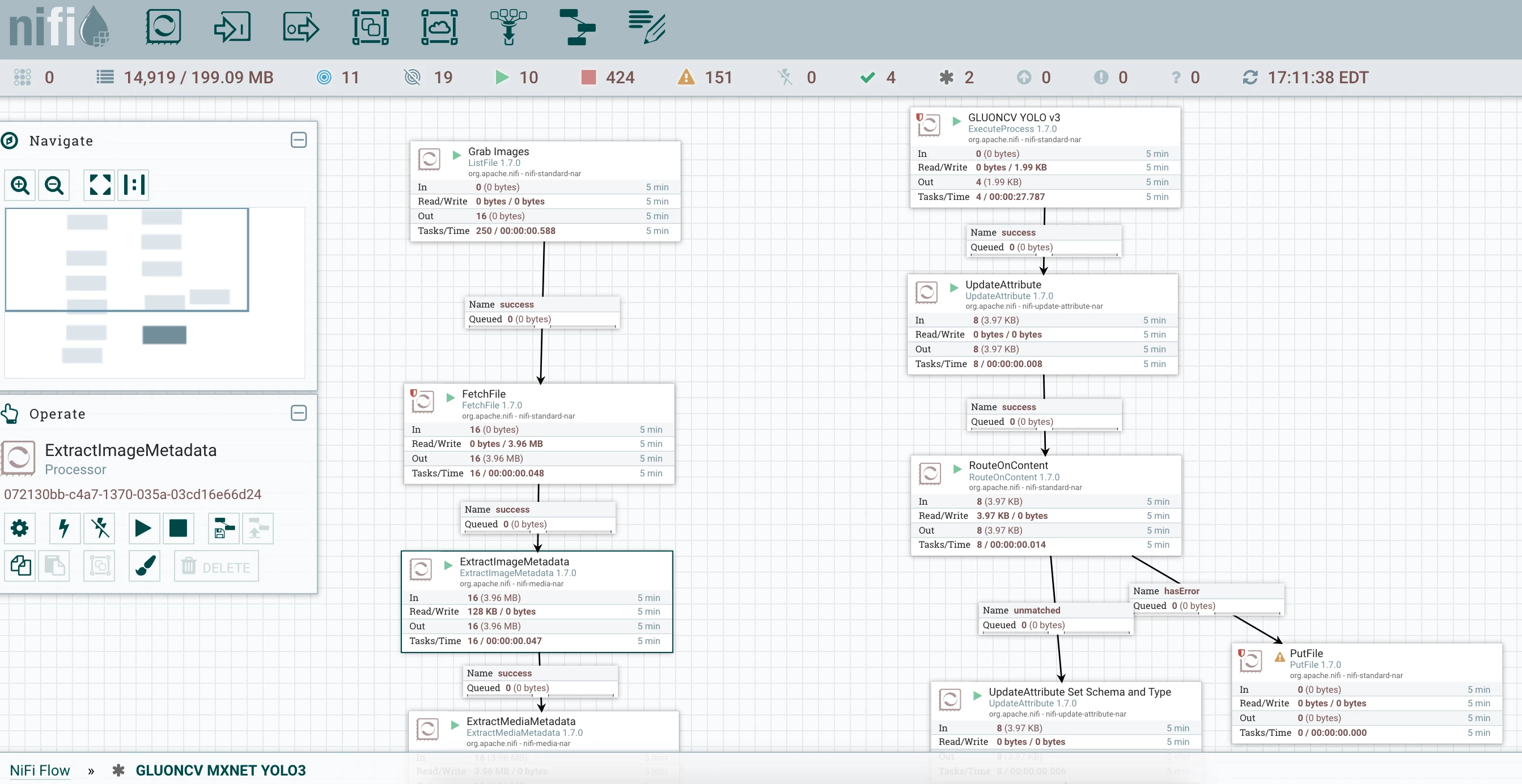

running gluoncv yolo3 model
I wrap my Python script in a shell script to throw away warnings and junk
cd /Volumes/TSPANN/2018/talks/ApacheDeepLearning101/nifi-gluoncv-yolo3
python3.6 -W ignore /Volumes/TSPANN/2018/talks/ApacheDeepLearning101/nifi-gluoncv-yolo3/yolonifi.py 2>/dev/null

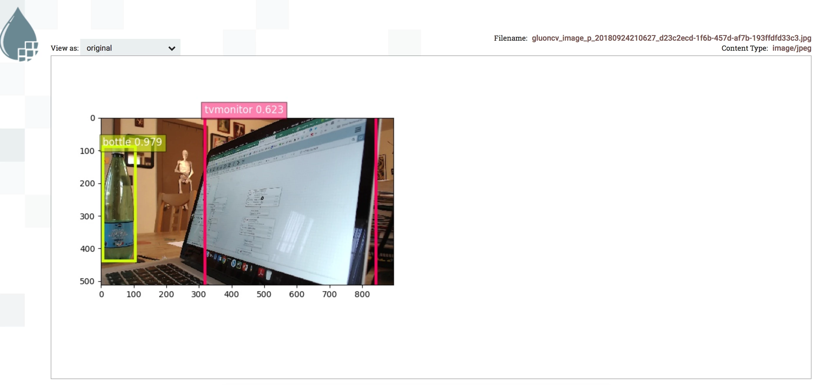

Example Processed Image Output
It found one generic person, we could train against a known set of humans that are allowed in an area or are known users.

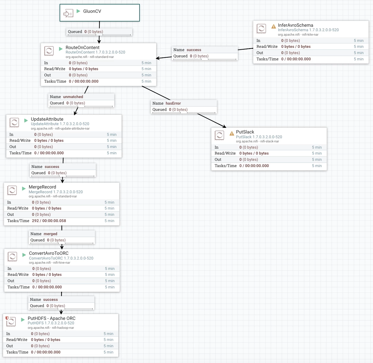

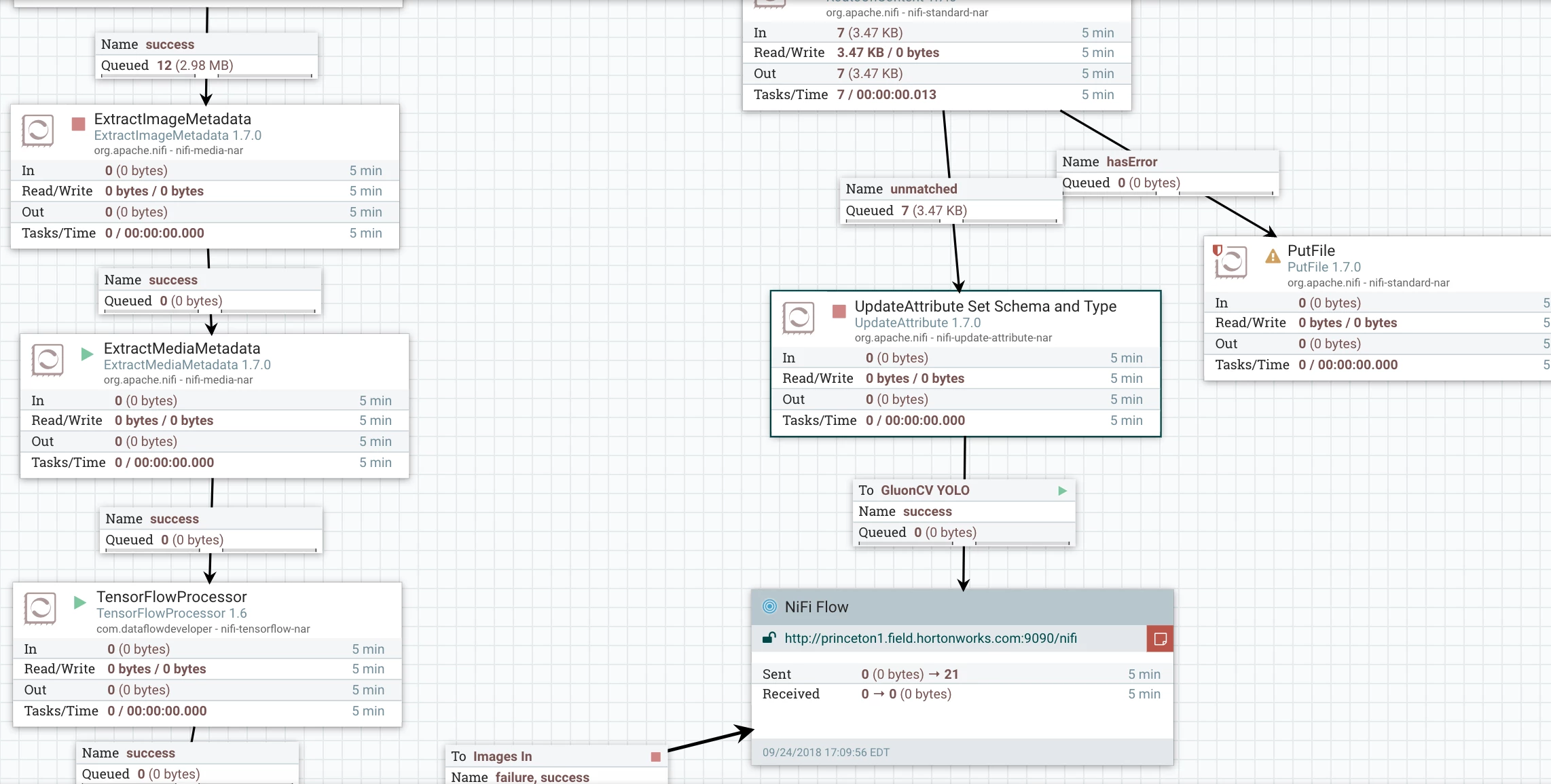

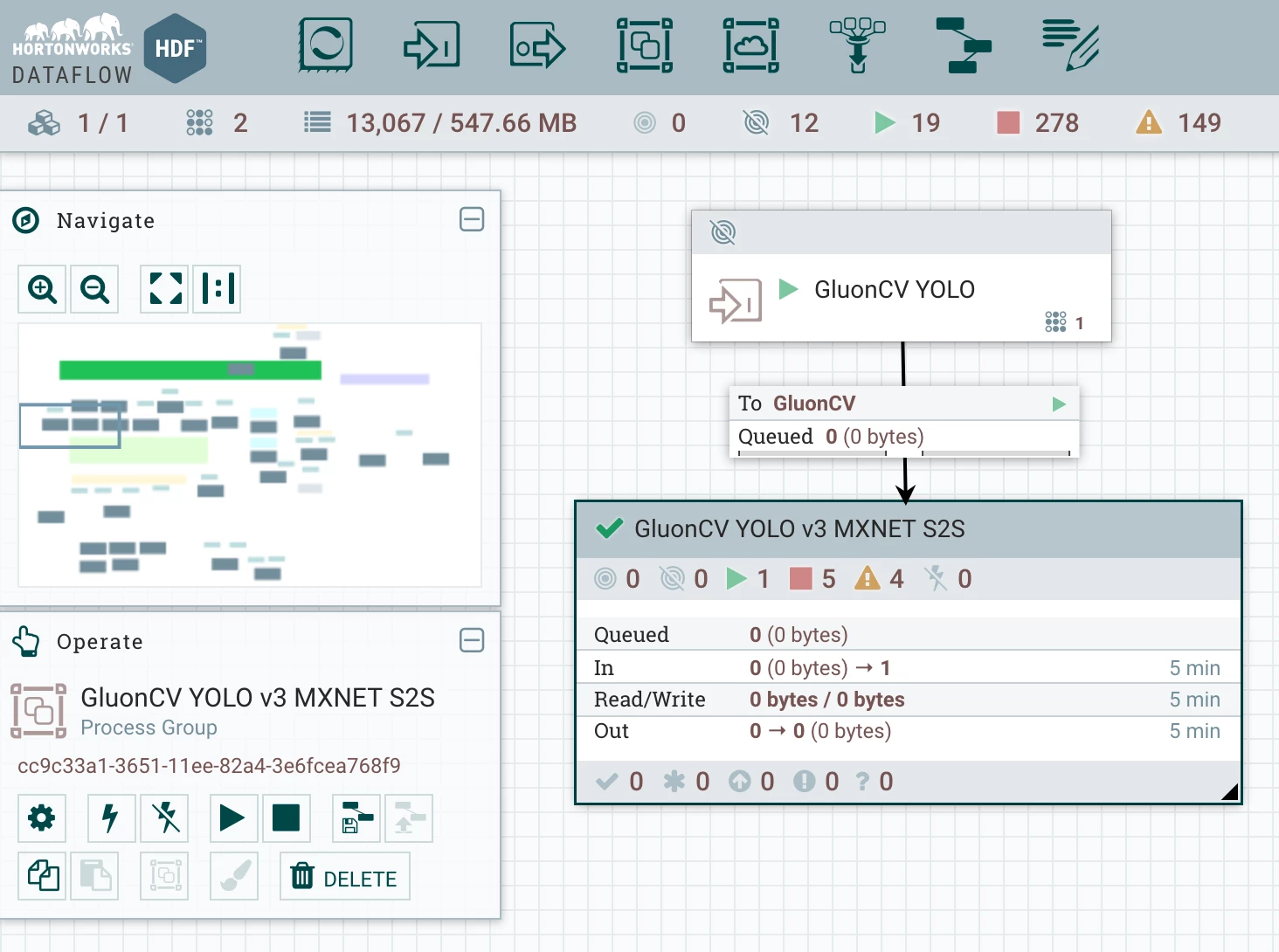

nifi flows
Gateway Server (We could skip this, but aggregating multiple camera agents is useful)
Send the Flow to the Cloud
Cloud Server Site-to-Site

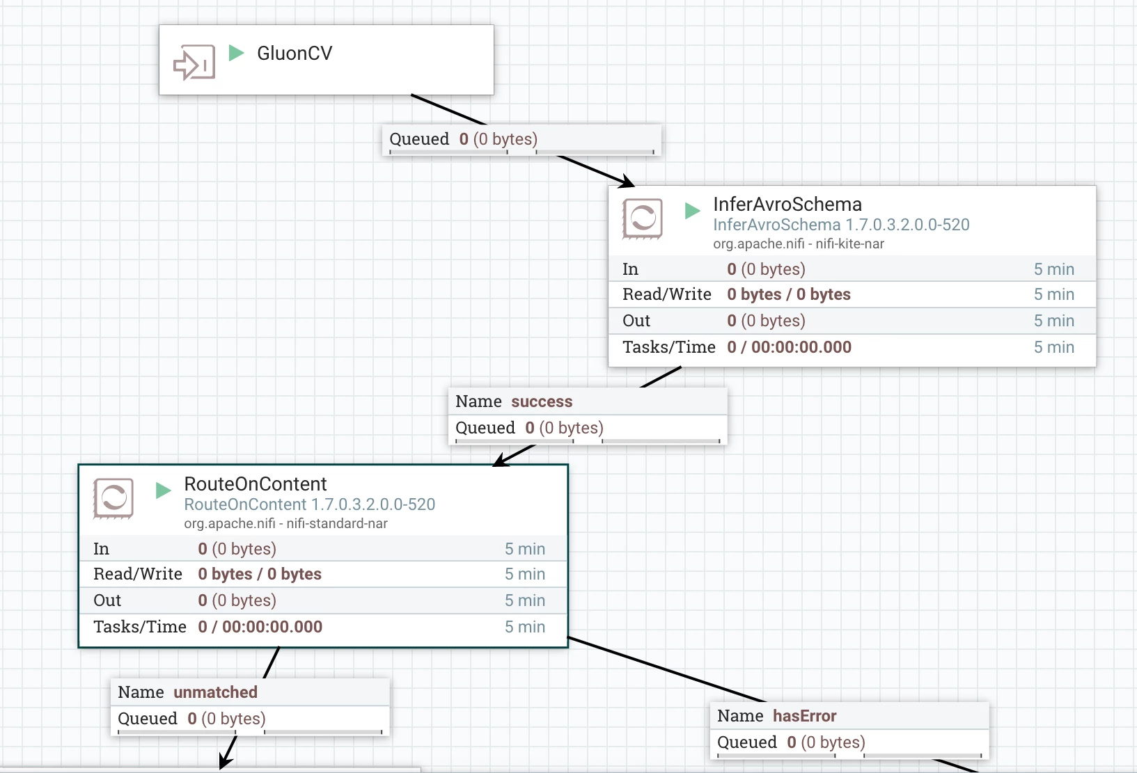

After we infer the schema of the data once, we don't need it again. We could derive the schema manually or from another tool, but this is easy. Once you are done, then you can delete the InferAvroSchema processor from your flow. I left mine in for your uses if you wish to start from this flow that is attached at the end of the article.
flow steps
Route When No Error to Merge Record Then Convert Those Aggregated Apache Avro Records into One Apache ORC file.
Then store it in an HDFS directory. Once complete their will be a DDL added to metadata that you can send to a PutHiveQL or manually create the table in Beeline or Zeppelin or Hortonworks Data Analytics Studio (https://hortonworks.com/products/dataplane/data-analytics-studio/).

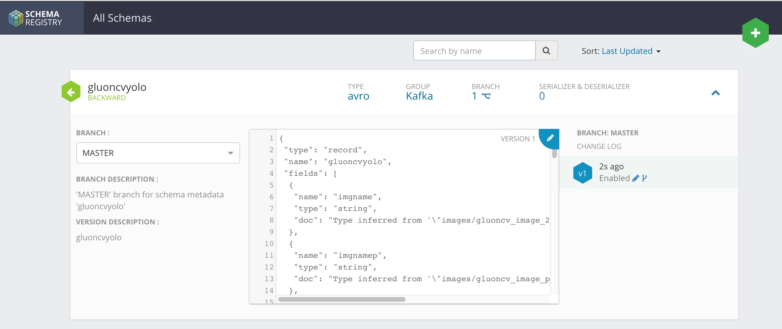

schema: gluoncvyolo
{ "type" : "record", "name" : "gluoncvyolo", "fields" : [ { "name" : "imgname", "type" : "string", "doc" : "Type inferred from '\"images/gluoncv_image_20180924211055_8f3b9dac-5645-49aa-94e7-ee5176c3f55c.jpg\"'" }, { "name" : "imgnamep", "type" : "string", "doc" : "Type inferred from '\"images/gluoncv_image_p_20180924211055_8f3b9dac-5645-49aa-94e7-ee5176c3f55c.jpg\"'" }, { "name" : "class1", "type" : "string", "doc" : "Type inferred from '\"tvmonitor\"'" }, { "name" : "pct1", "type" : "string", "doc" : "Type inferred from '\"95.71207000000001\"'" }, { "name" : "host", "type" : "string", "doc" : "Type inferred from '\"HW13125.local\"'" }, { "name" : "shape", "type" : "string", "doc" : "Type inferred from '\"(1, 3, 512, 896)\"'" }, { "name" : "end", "type" : "string", "doc" : "Type inferred from '\"1537823458.559896\"'" }, { "name" : "te", "type" : "string", "doc" : "Type inferred from '\"3.580893039703369\"'" }, { "name" : "battery", "type" : "int", "doc" : "Type inferred from '100'" }, { "name" : "systemtime", "type" : "string", "doc" : "Type inferred from '\"09/24/2018 17:10:58\"'" }, { "name" : "cpu", "type" : "double", "doc" : "Type inferred from '12.0'" }, { "name" : "diskusage", "type" : "string", "doc" : "Type inferred from '\"48082.7 MB\"'" }, { "name" : "memory", "type" : "double", "doc" : "Type inferred from '70.6'" }, { "name" : "id", "type" : "string", "doc" : "Type inferred from '\"20180924211055_8f3b9dac-5645-49aa-94e7-ee5176c3f55c\"'" } ] }
Tabular data has fields with types and properties. Let's specify those for automated analysis, conversion and live stream SQL.

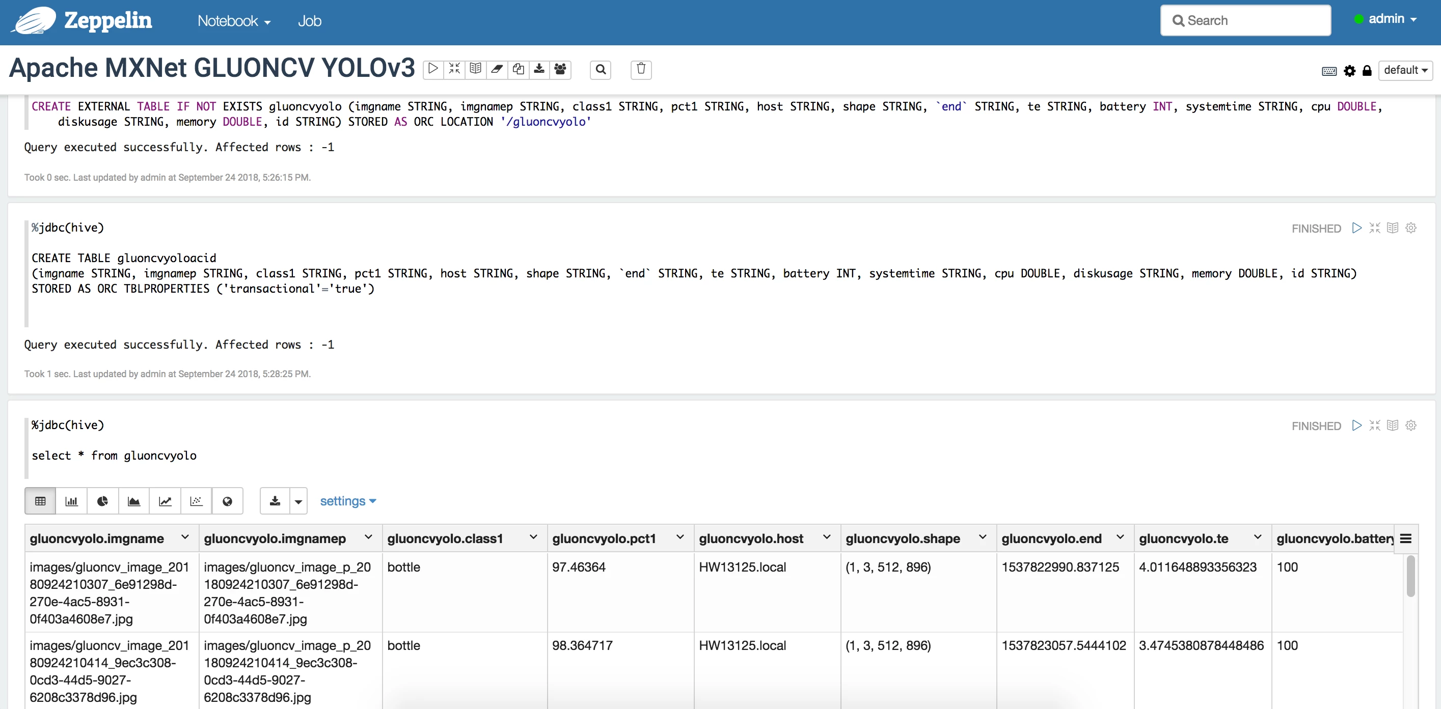

hive table schema: gluoncvyolo
CREATE EXTERNAL TABLE IF NOT EXISTS gluoncvyolo (imgname STRING, imgnamep STRING, class1 STRING, pct1 STRING, host STRING, shape STRING, end STRING, te STRING, battery INT, systemtime STRING, cpu DOUBLE, diskusage STRING, memory DOUBLE, id STRING) STORED AS ORC;
Apache NiFi generates tables for me in Apache Hive 3.x as Apache ORC files for fast performance.
hive acid table schema: gluoncvyoloacid
CREATE TABLE gluoncvyoloacid
(imgname STRING, imgnamep STRING, class1 STRING, pct1 STRING, host STRING, shape STRING, `end` STRING, te STRING, battery INT, systemtime STRING, cpu DOUBLE, diskusage STRING, memory DOUBLE, id STRING)
STORED AS ORC TBLPROPERTIES ('transactional'='true')
I can just as easily insert or update data into Hive 3.x ACID 2 tables.
We have data, now query it. Easy, no install analytics with tables, Leafletjs, AngularJS, graphs, maps and charts.

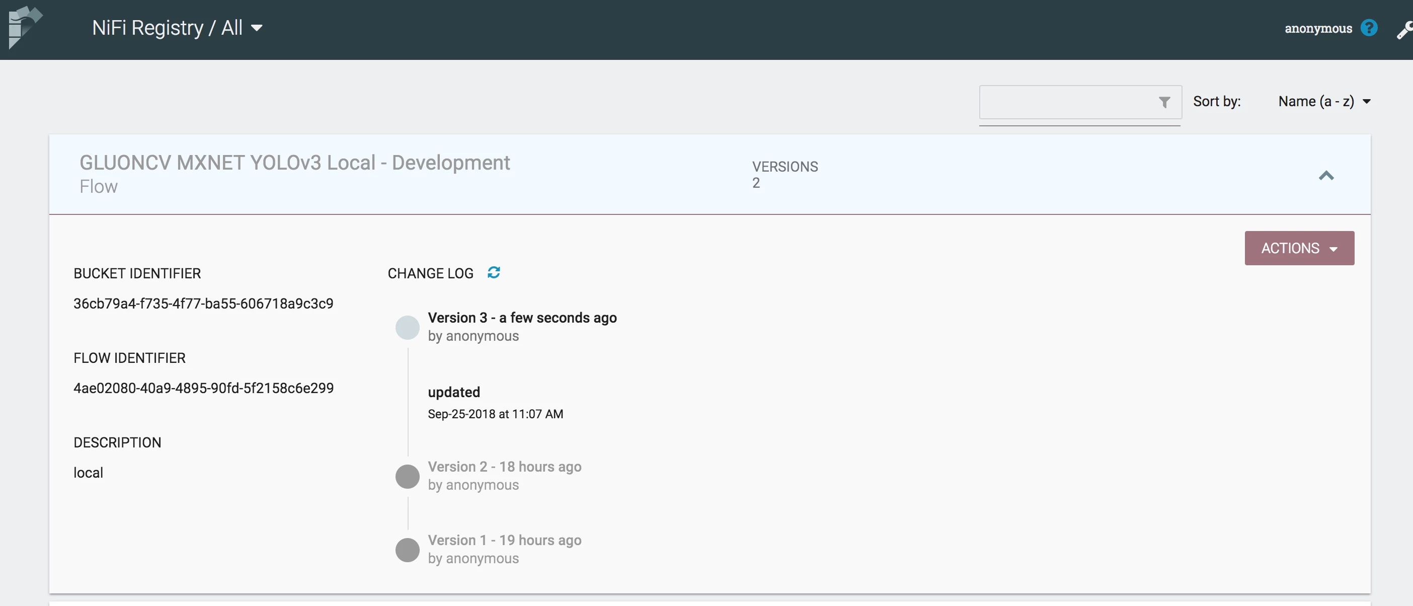

nifi flow registry
To manage version control I am using the NiFi Registry which is great. In the newest version, 0.2, there is the ability to back it up with github! It's easy. Everything you need to know is in the doc and Bryan Bend's excellent post on the subject.
https://nifi.apache.org/docs/nifi-registry-docs/index.html
https://bryanbende.com/development/2018/06/20/apache-nifi-registry-0-2-0
There were a few gotchas for me.
  • Use your own new github project with permissions and then clone it local git clone https://github.com/tspannhw/nifi-registry-github.git
  • Make sure github directory has permission and is empty (no readme or junk)
  • Make sure you put in the full directory path
  • Update your config like below:
<flowPersistenceProvider>
<class>org.apache.nifi.registry.provider.flow.git.GitFlowPersistenceProvider</class>
<property name="Flow Storage Directory">/Users/tspann/Documents/nifi-registry-0.2.0/conf/nifi-registry-github</property>
<property name="Remote To Push">origin</property>
<property name="Remote Access User">tspannhw</property>
<property name="Remote Access Password">generatethis</property>
</flowPersistenceProvider>
This is my github directory to hold versions: https://github.com/tspannhw/nifi-registry-github
