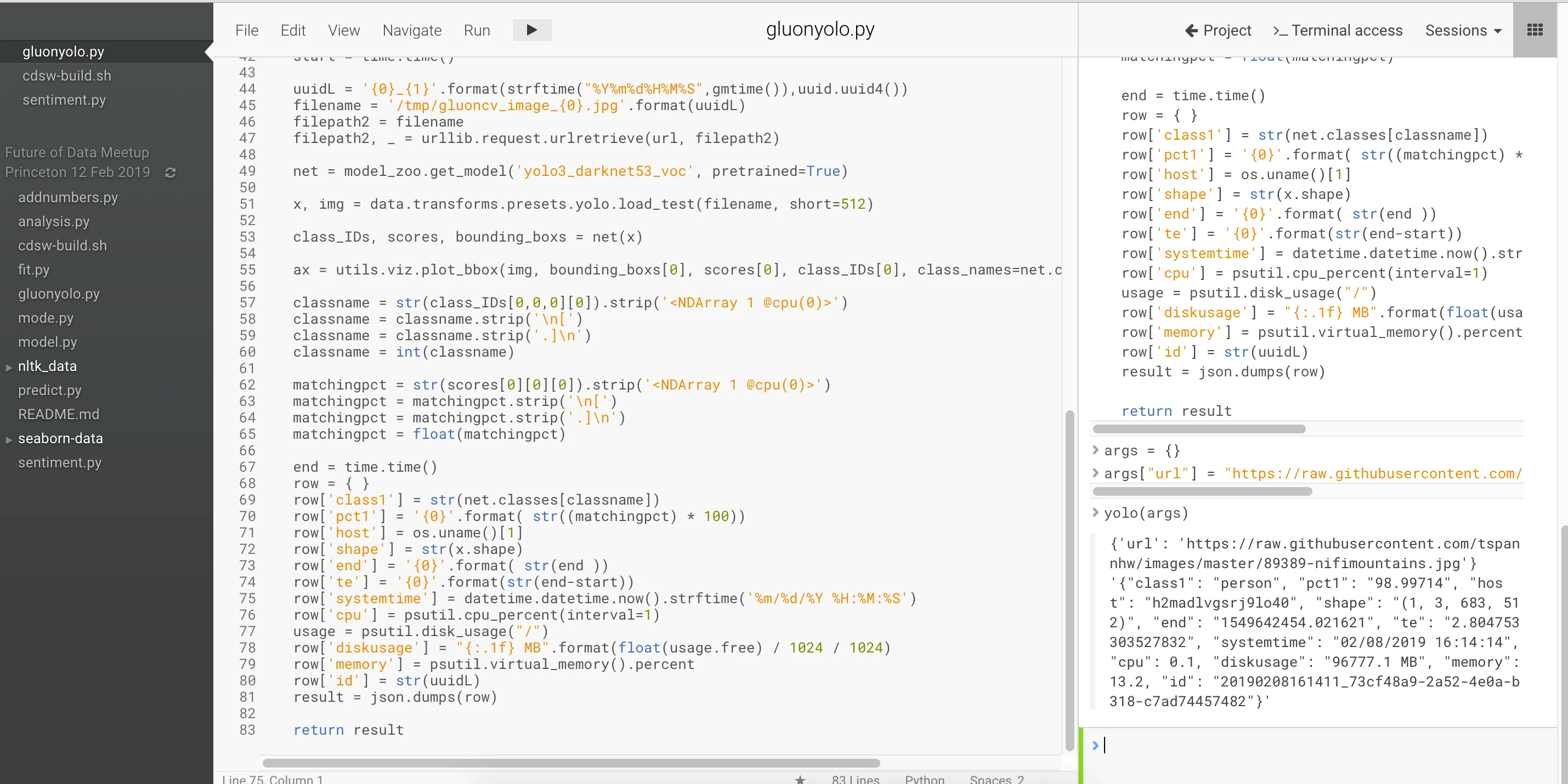

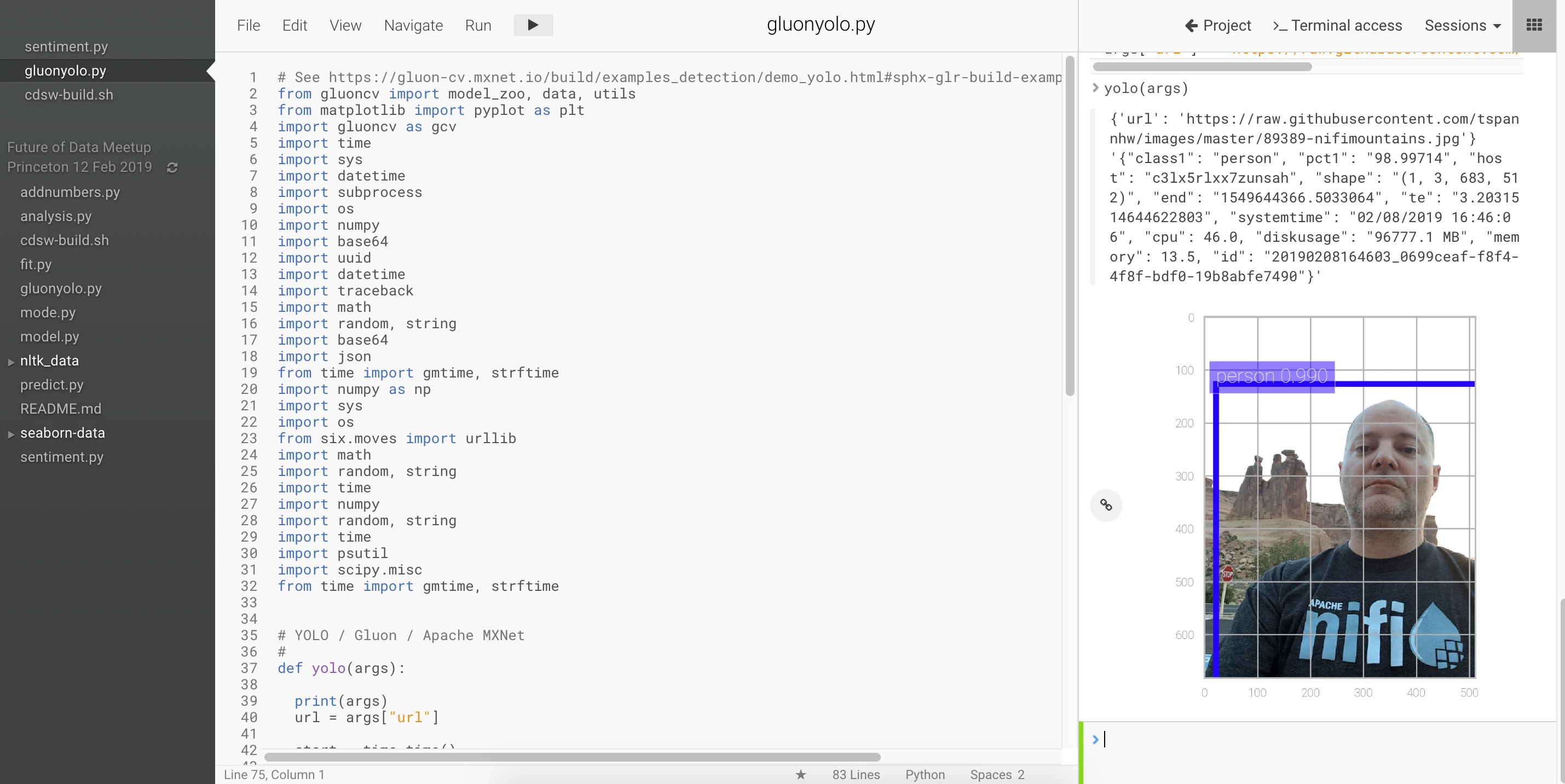

Step 1: Let's Clean Up and Test Some Python 3 Code

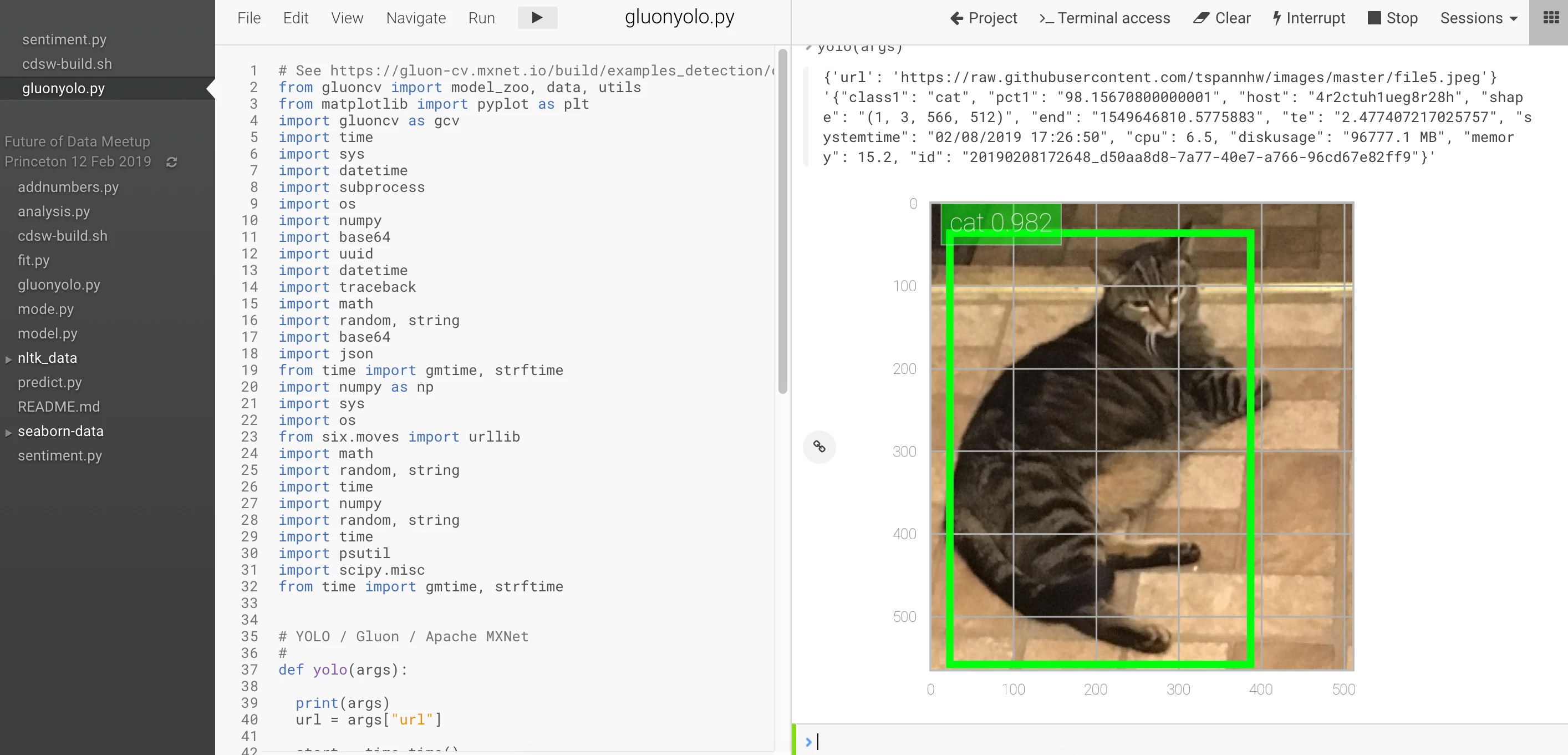

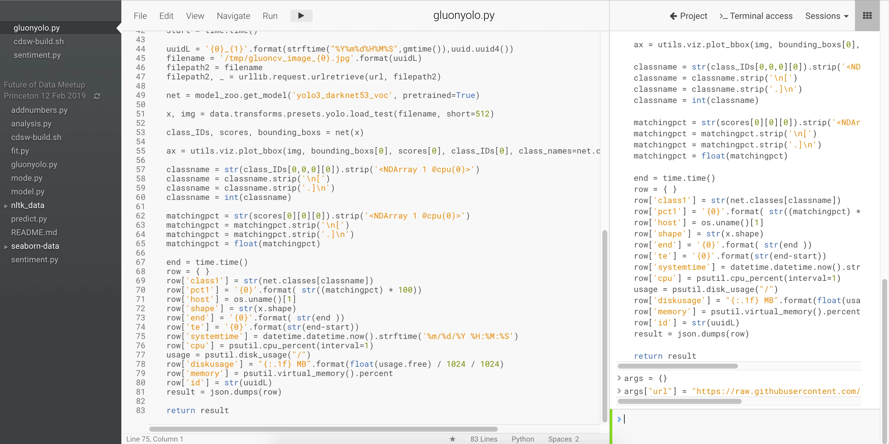

So first I take an existing example Python3 GluonCV Apache MXNet YOLO code that I already have. As you can see it uses a pretrained model from Apache MXNet's rich model zoo. This started here: https://github.com/tspannhw/nifi-gluoncv-yolo3 I paired down the libraries as I used an interactive Python 3 session to test and refine my code. As before, I set a variable to pass in my data, this time a URL pointing to an image.

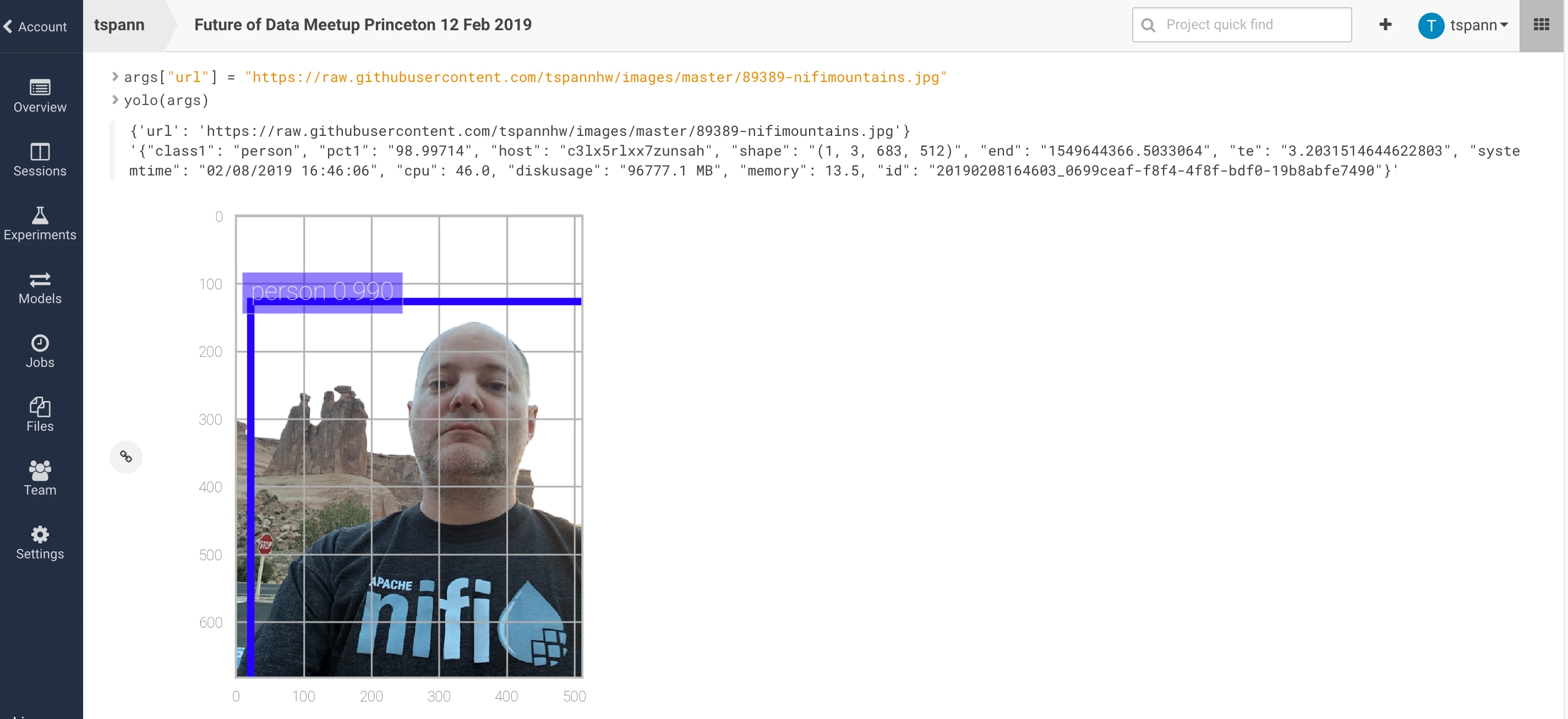

As you can see in my interactive session I can run my yolo function and get results. I had a library in there to display the annotated image while I was testing. I took this code off to save time, memory and reduce libraries. This was needed while testing though. The model seems to be working it identified me as a person and my cat as a cat.

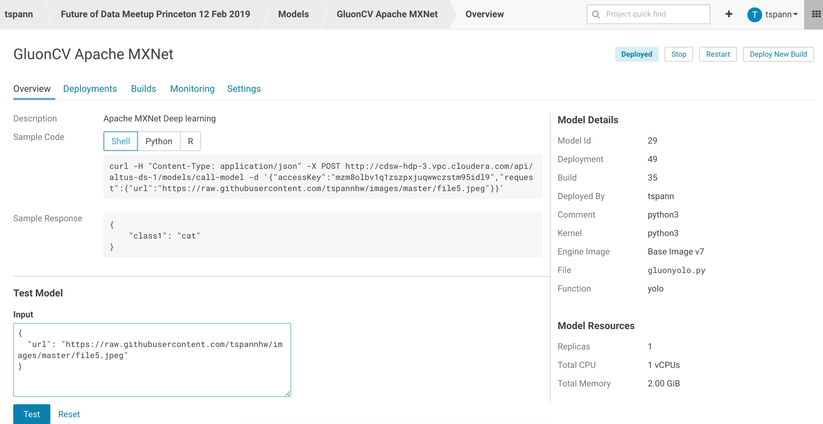

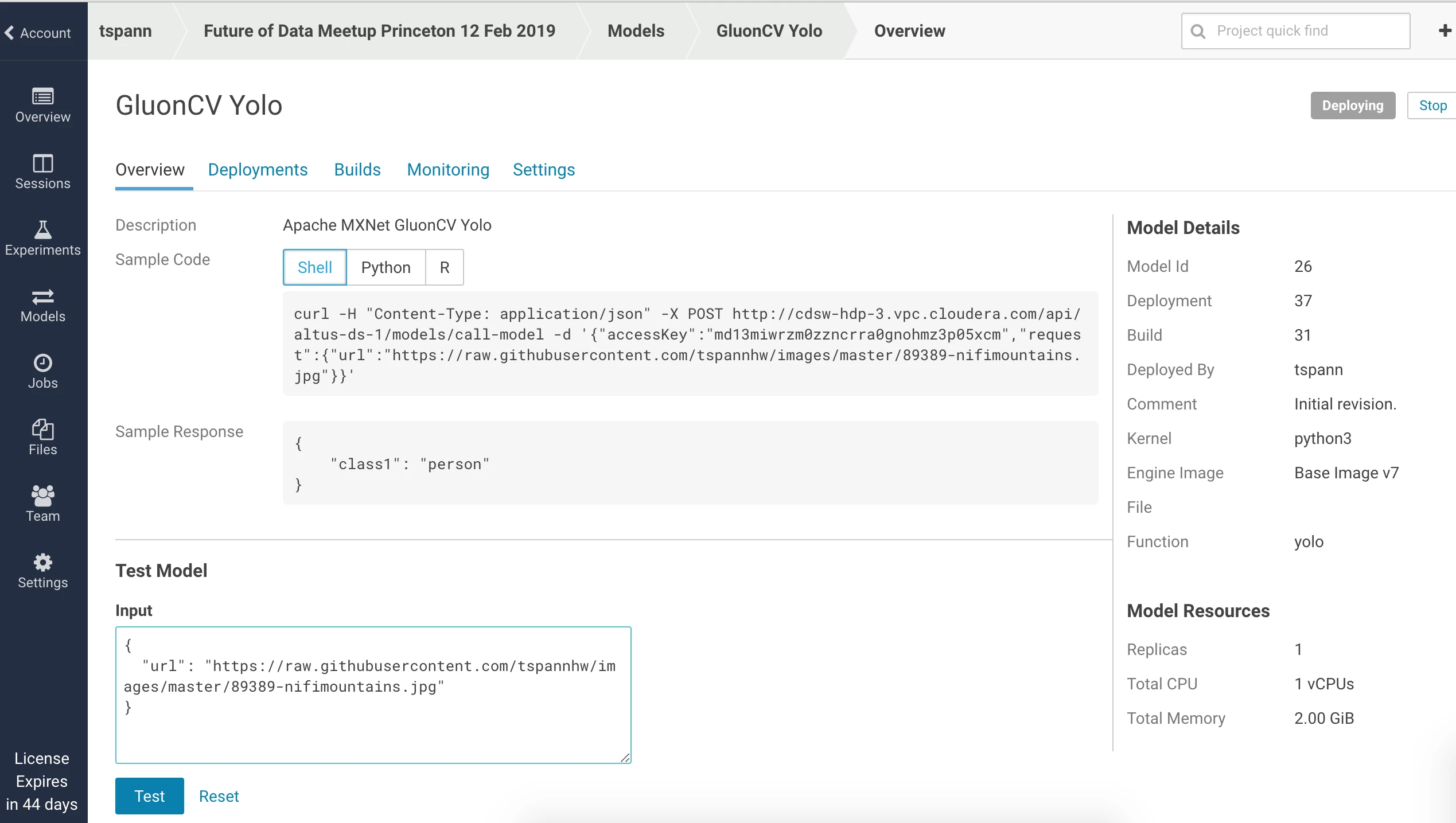

Step 2: Create, Build and Deploy a Model

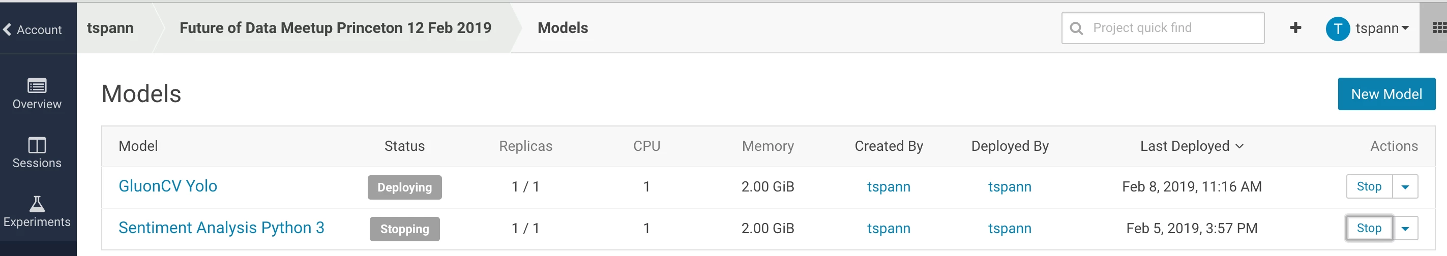

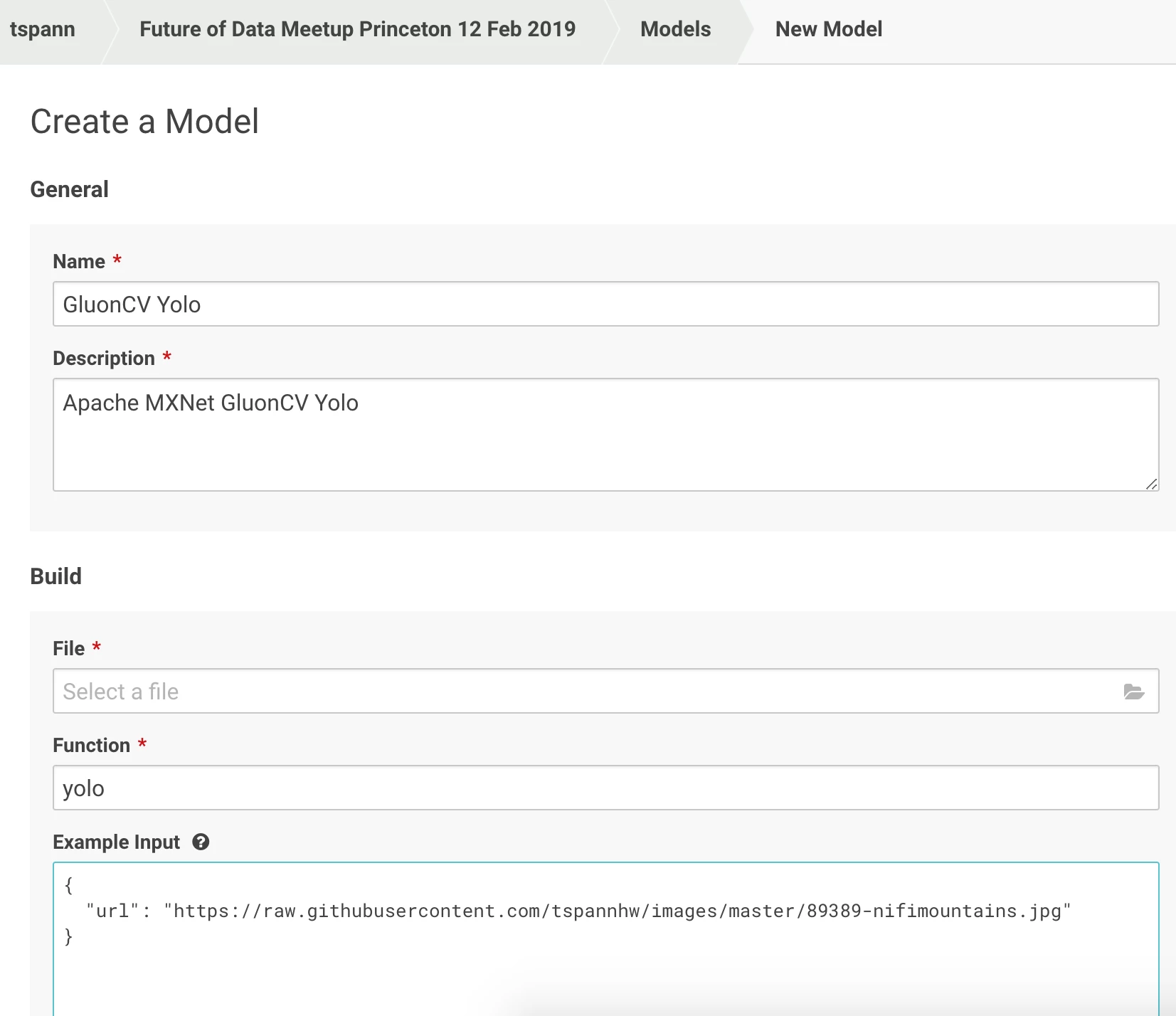

I got to models, point to my new file and the function I used (yolo) and put in a sample Input and response.

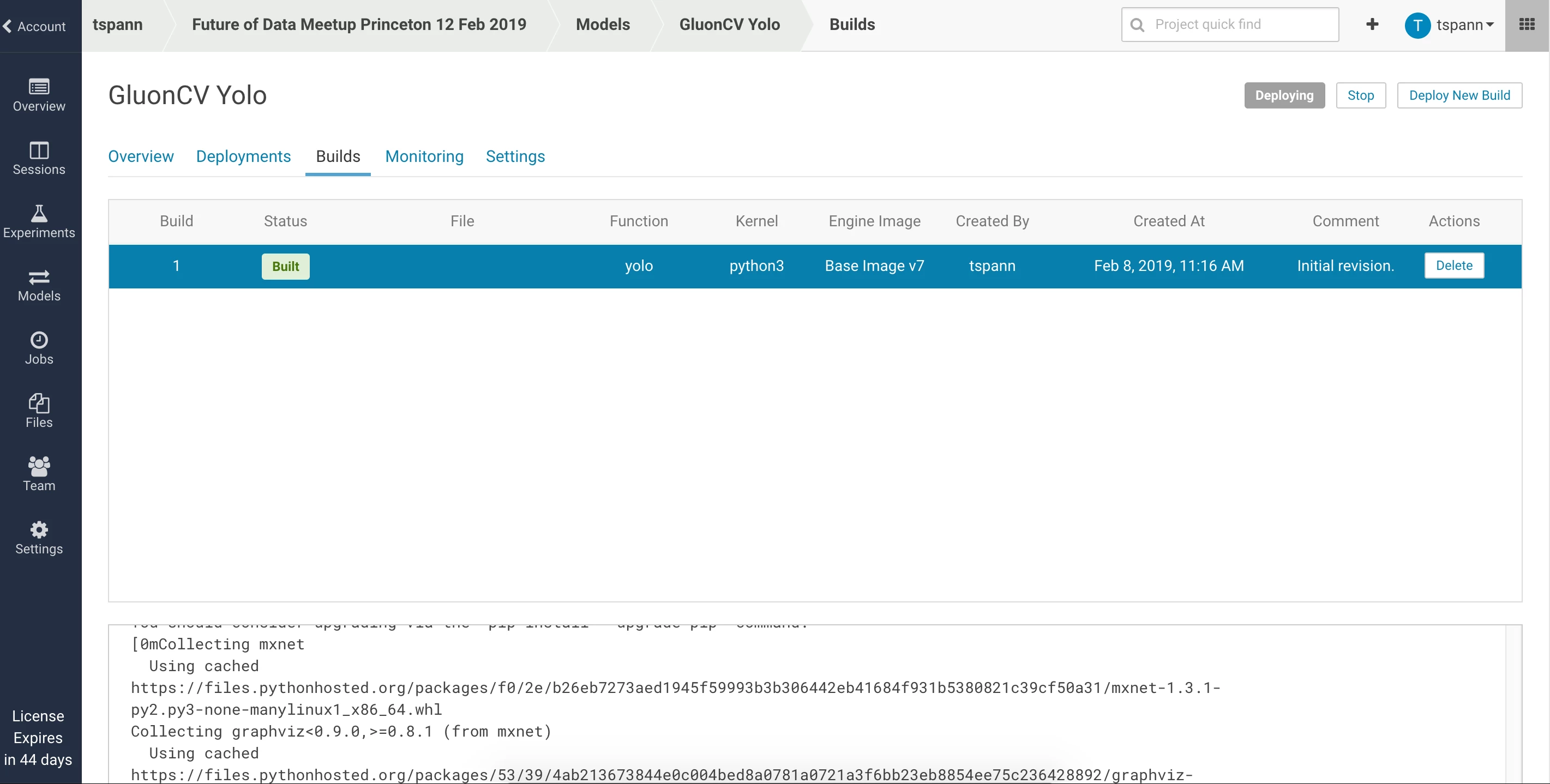

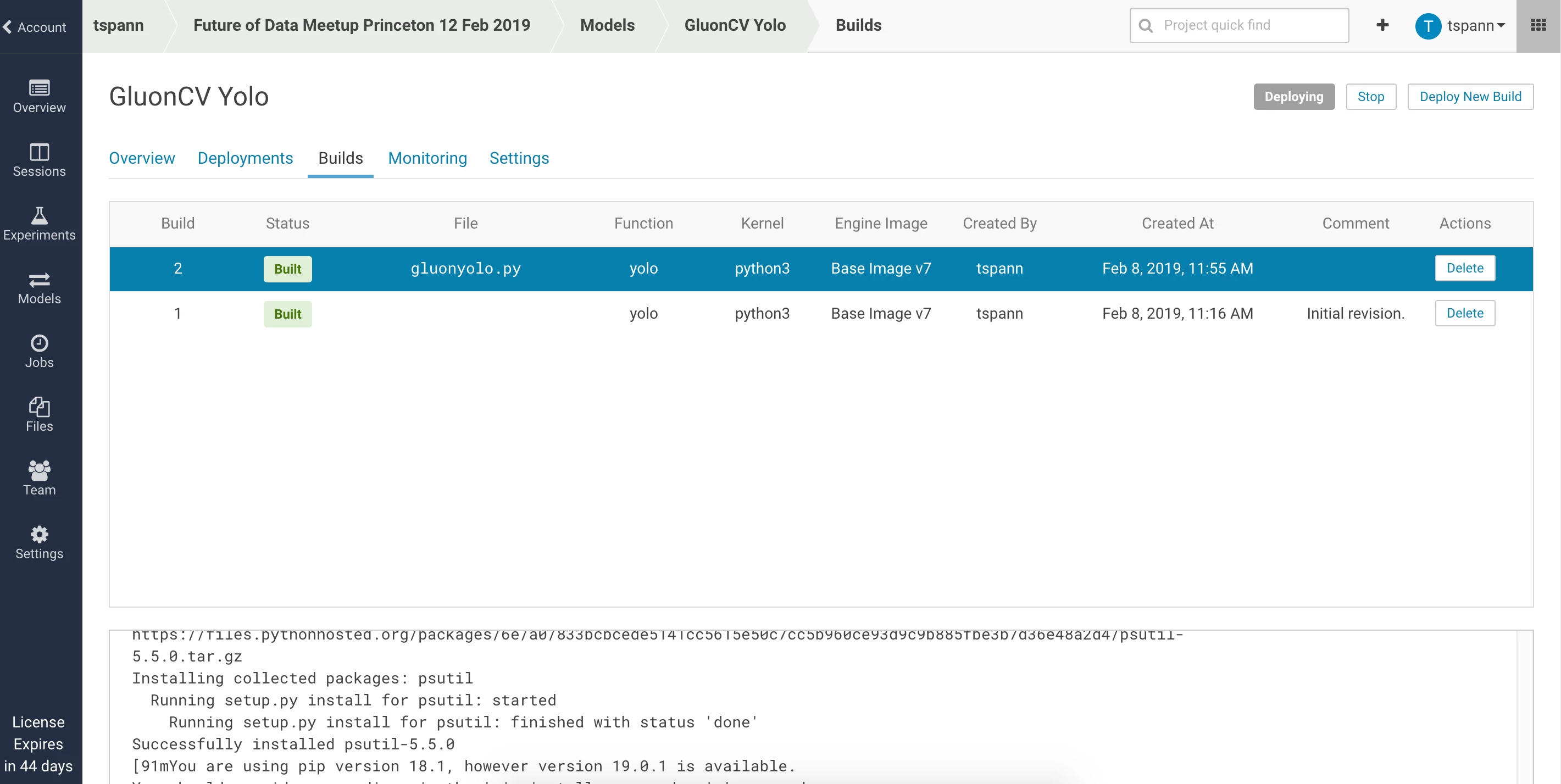

I deploy it, then it is in the list of available models. You goes through a few steps as the docker container is deployed to K8 and all the required pips are installed during a build process.
Once it is built, you can see the build(s) in the Build screen.
Step 3: Test the Model

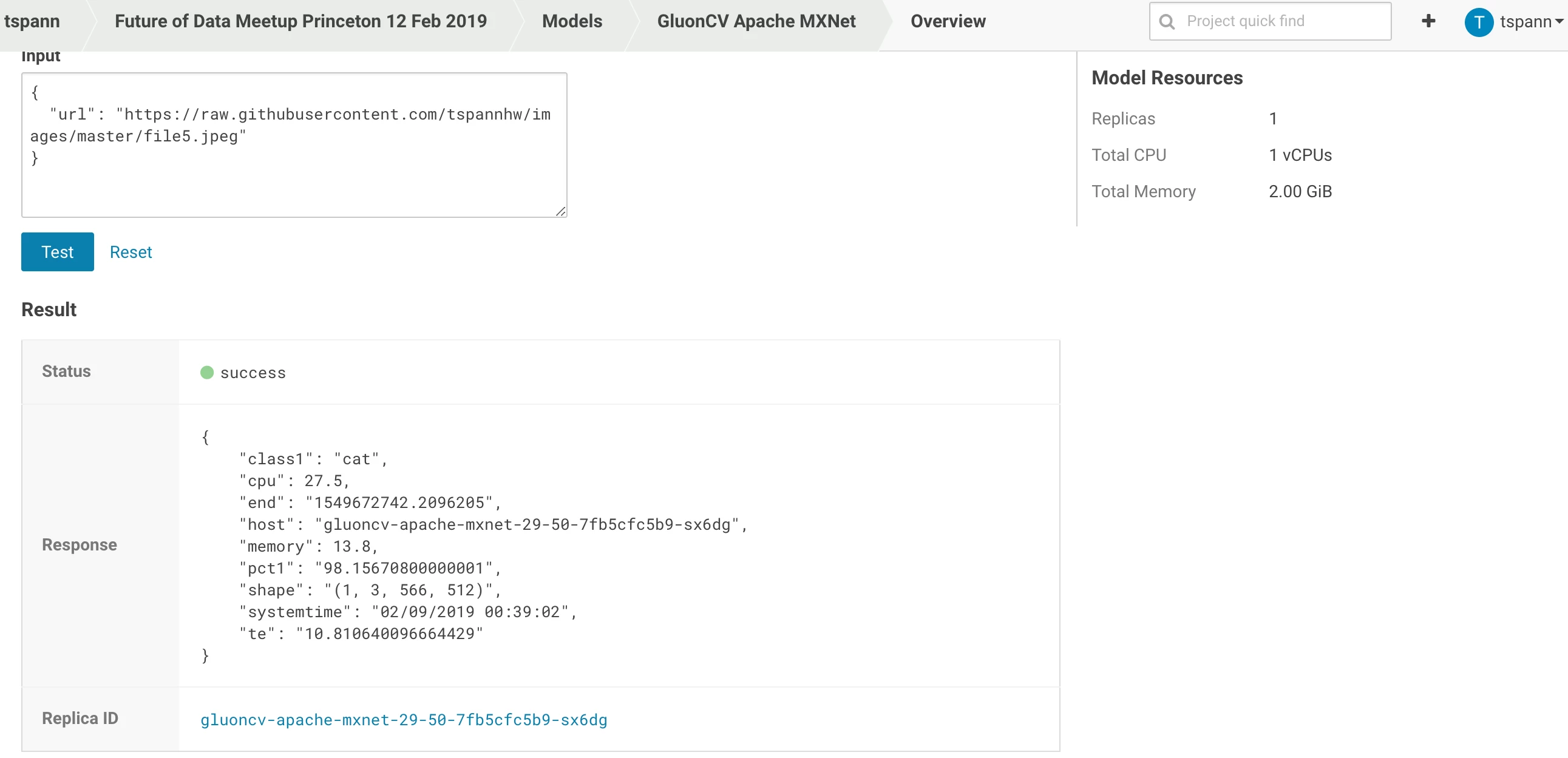

Once it is done building and marked deployed we can use the built in tester from Overview.
We can see the result in JSON ready to travel over an HTTP REST API.

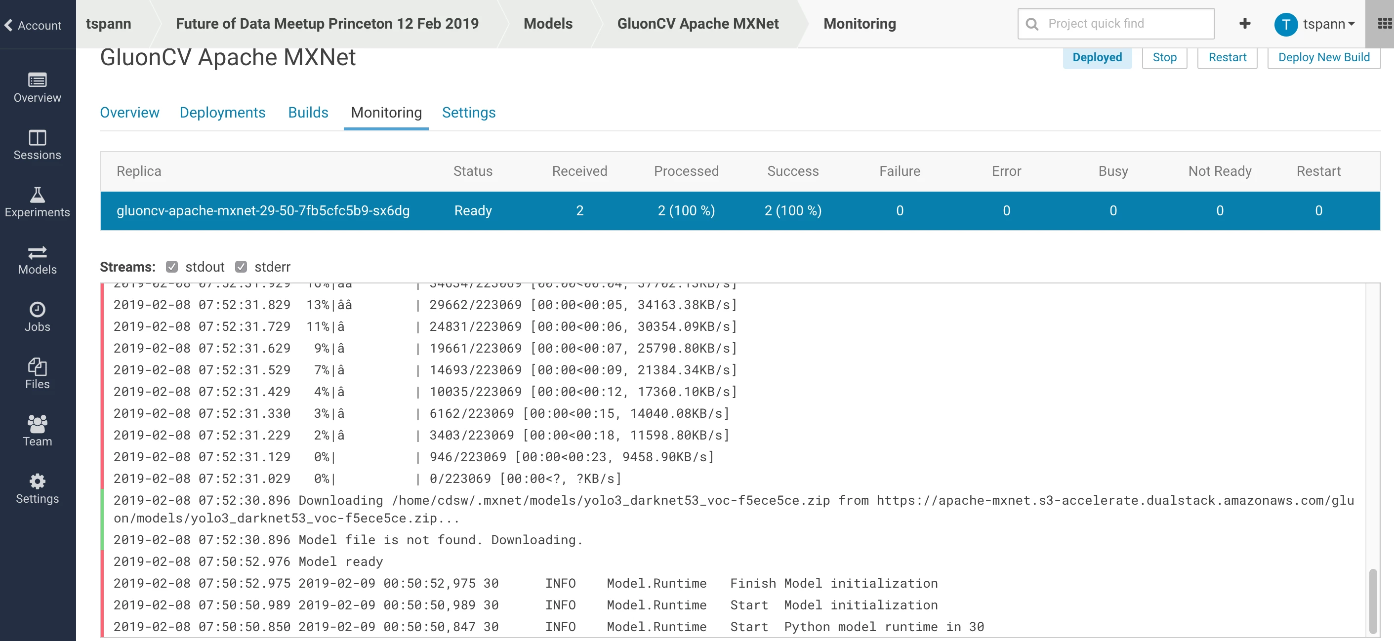

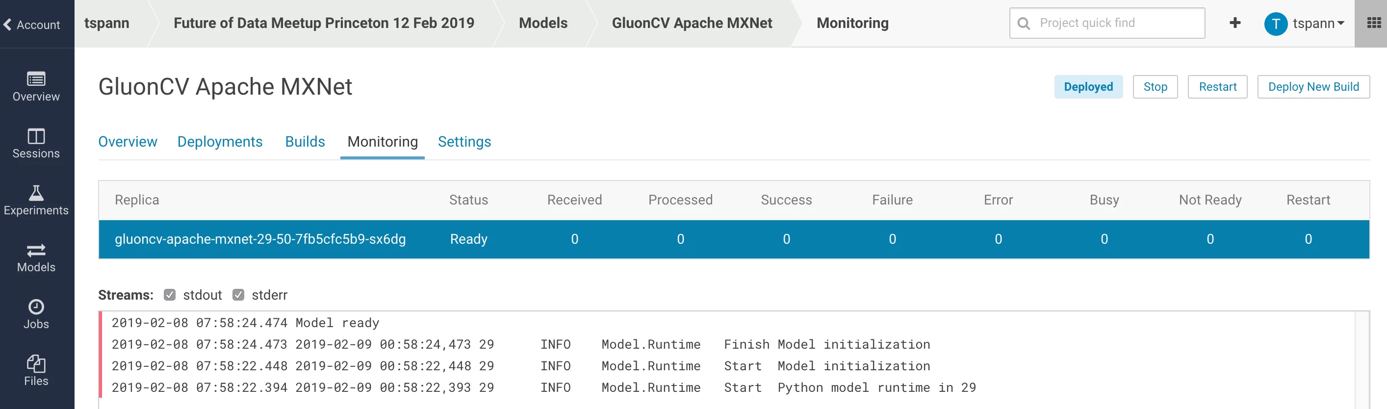

Step 4: Monitor the Deployed Model
We can see the standard output and error and see how many times we are called and success.
You can see it downloaded the model from the Apache MXNet zoo.
If you need to stop, rebuild or replace a model, it's easy.

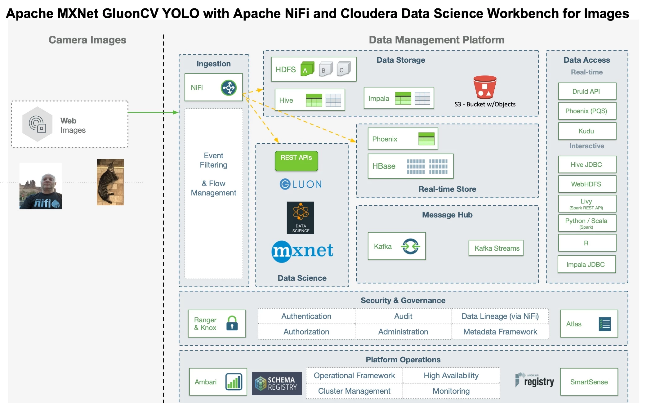

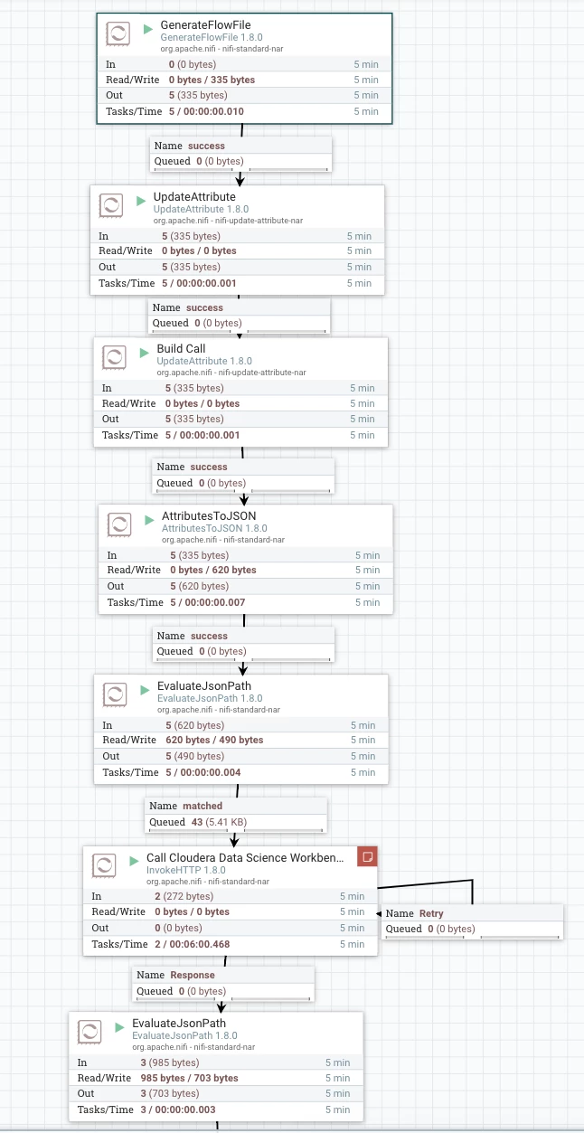

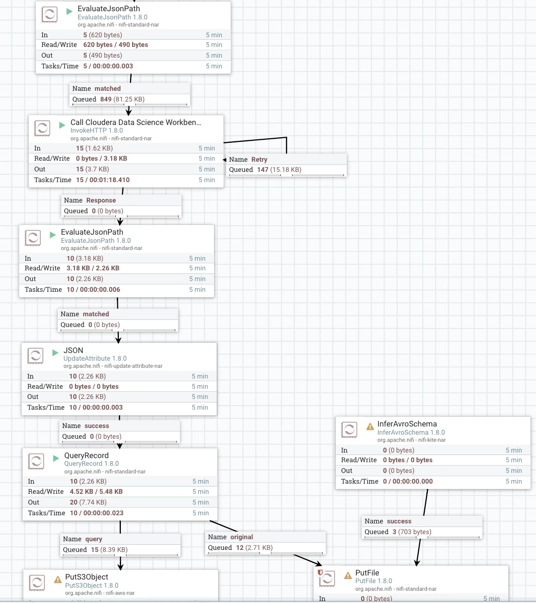

Step 5: Apache NiFi Flow
As you can see it's a few steps to run the flow. I am using GenerateFlowFile to get us started, but I could have a cron scheduler starting us or react to a Kafka/MQTT/JMS message or another trigger. I then build the JSON needed to call the REST API. Example: {"accessKey":"accesskey","request":{"url":"${url}"}}
Then we call the REST API via an HTTP Post (http://myurliscoolerthanyours.com/api/altus-ds-1/models/call-model).

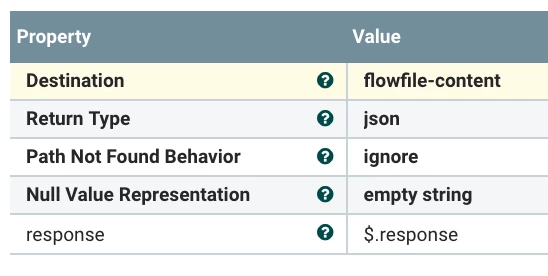

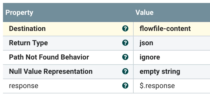

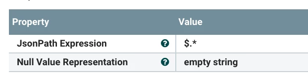

We then parse the JSON it returns to just give us the fields we want, we don't really need status.

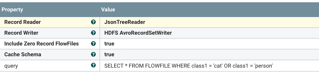

We name our schema so we can run Apache Calcite SQL queries against it.
Let's only save Cats and People to our Amazon S3 bucket.
At this point I can add more queries and destinations. I can store it everywhere or anywhere.

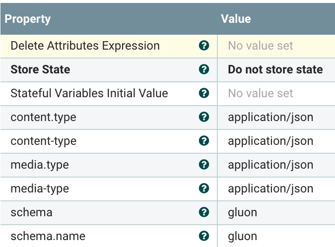

Build a Schema for the Data and store it in Apache NiFi AVRO Schema Registry or Cloudera Schema Registry
{ "type" : "record", "name" : "gluon", "fields" : [ { "name" : "class1", "type" : ["string","null"] }, { "name" : "cpu", "type" : ["double","null"] }, { "name" : "end", "type" : ["string","null"]}, { "name" : "host", "type" : ["string","null"]}, { "name" : "memory", "type" : ["double","null"]}, { "name" : "pct1", "type" : ["string","null"] }, { "name" : "shape", "type" : ["string","null"] }, { "name" : "systemtime", "type" : ["string","null"] }, { "name" : "te", "type" : ["string","null"] } ] }
I like to allow for nulls in case we have missing data, but that is up to your Data Steward and team. If you need to add a version of the schema with a new field, you must add "null" as an option since old data won't have that if you wish to share a schema.
