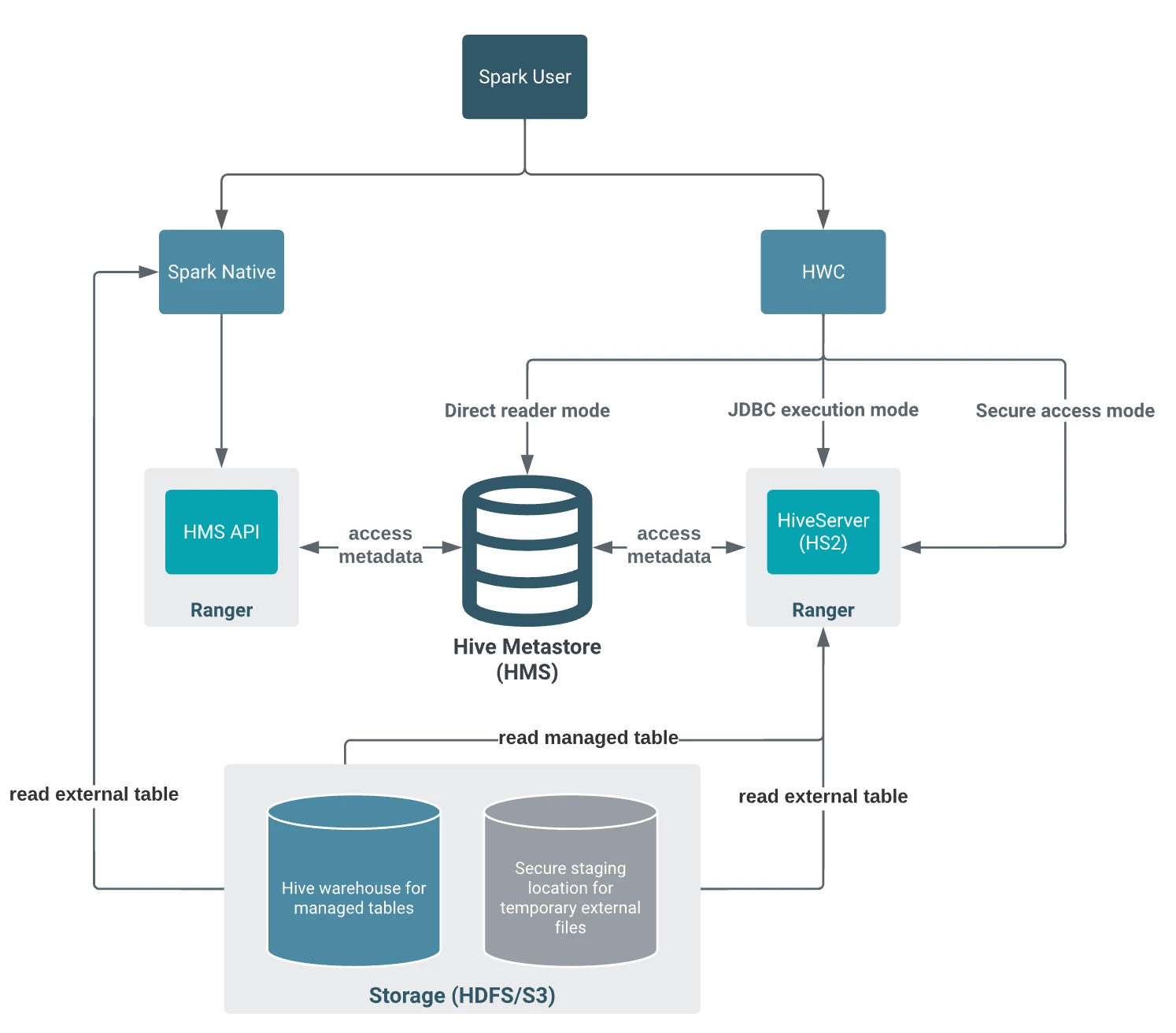

Read modes:
    -> DIRECT_READER_V2: HWC needs connection to Hive Metastore (HMS). Connection to HiveServer2 is not required. Use this only if ETL jobs do not require FGAC. Spark reads the data directly from the managed table location using the transaction snapshot.
      Limitations:
  • Cannot write data using HWC Direct Reader
  • No support for FGAC
  • Supports only single-table transaction consistency. The direct reader does not guarantee that multiple tables referenced in a query read the same snapshot of data.
      Configurations:
      spark.datasource.hive.warehouse.metastoreUri=thrift://<HMS-Host>:9083
      spark.hadoop.hive.zookeeper.quorum=<Zk-Host>:2181
      spark.sql.hive.hiveserver2.jdbc.url=<HS2-Url>
      spark.sql.hive.hiveserver2.jdbc.url.principal=hive/_HOST@<REALM>
      spark.security.credentials.hiveserver2.enabled=true
      spark.sql.extensions=com.hortonworks.spark.sql.rule.Extensions
      spark.kryo.registrator=com.qubole.spark.hiveacid.util.HiveAcidKyroRegistrator
      spark.datasource.hive.warehouse.read.mode=DIRECT_READER_V2
      spark.hadoop.secure.access.cache.disable=true
    -> JDBC_CLUSTER: HWC makes a connection to HiveServer (HS2) to get transaction information. This read mode is secured through Ranger authorization and supports FGAC, such as column masking.
      Limitations:
  • Recommended for workloads with a size of less than 1GB to avoid bottleneck, as data is transferred through a single JDBC connection.
  • Requires HiveServer2 connection.
  • Cannot correctly resolve queries that use the ORDER BY clause when run as hive.sql(" <query> ").
  • Cannot correctly resolve query of a table that has a complex column type, such as ARRAY, STRUCT and MAP: it incorrectly represents the type as String in the returned data frame.
      Configurations:
      spark.datasource.hive.warehouse.read.mode=JDBC_CLUSTER
    -> SECURE_ACCESS: Allows FGAC column masking and row filtering to secure the data of managed (ACID) or external Hive tables read from Cloudera Data Engineering Spark. It is recommended for large workloads and low-latency requirements. HWC creates external tables on a configured staging location when launched. It uses CREATE TABLE AS SELECT (CTAS) to create the tables. Ranger policies are applied and FGAC is enforced during the CTAS operation. Users read external tables in the secure staging location.
      Configurations:
      spark.hadoop.hive.metastore.uris=thrift://<HMS-Host>:9083
      spark.datasource.hive.warehouse.read.mode=SECURE_ACCESS
      spark.datasource.hive.warehouse.load.staging.dir=<staging-dir-path>
The following diagram shows the typical read authorisation process:

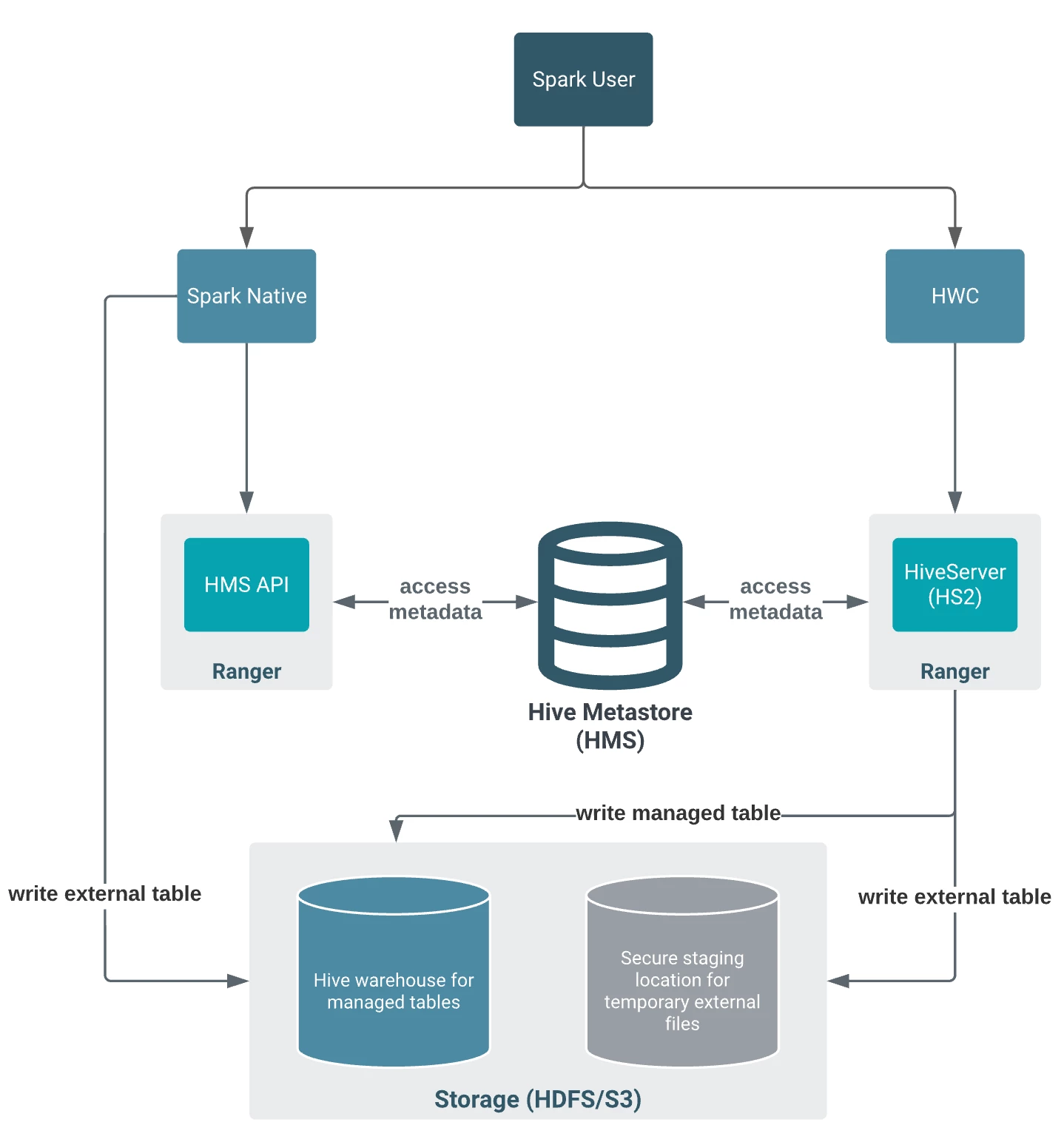

Write modes:
   -> HIVE_WAREHOUSE_CONNECTOR: HWC requires the connection to HiveServer (HS2) to perform batch writes from Cloudera Data Engineering Spark to Hive. HWC writes to an intermediate location as defined by the value of the spark.datasource.hive.warehouse.load.staging.dir configuration.
      Configurations:
      spark.datasource.hive.warehouse.read.mode=secure_access
    -> DATAFRAME_TO_STREAM: HWC does not rely on HiveServer2 for streaming. Instead, it interacts with HMS for transaction management and writes ORC bucket files directly to the table's location. Make sure that the target Hive table is transactional and pre-created before writing to it.
      Configurations:
      spark.sql.warehouse.dir=<Hive-Warehouse-Dir-S3-Path>
    -> STREAM_TO_STREAM: HWC supports streaming data from Spark into Hive tables, enabling real-time data ingestion. However, the target Hive table must be transactional and pre-created before writing to it.
    Configurations:
      spark.sql.warehouse.dir=<Hive-Warehouse-Dir-Path>
      spark.sql.streaming.checkpointLocation=<Stream-checkpoint-dir-Path>
Example:
## Write Using HIVE_WAREHOUSE_CONNECTOR ##
<DF>.write.format(HiveWarehouseSession().HIVE_WAREHOUSE_CONNECTOR).mode("append").option("database",db).option("table",tname).option("fileformat","orc").save()
## Write Using DATAFRAME_TO_STREAM ##
<DF>.write.format(HiveWarehouseSession().DATAFRAME_TO_STREAM).mode("append").option("metastoreUri", "<MetaStoreUri>").option("metastoreKrbPrincipal", "<Principal>").option("database","<db>").option("table","<table>").option("fileformat","orc").save()
## Write Using STREAM_TO_STREAM ##
query = <StreamDF>.writeStream.format(HiveWarehouseSession().STREAM_TO_STREAM).outputMode("append").option("metastoreUri", "<MetaStoreUri>").option("database", "<db>").option("table", "<pre-created-table>").trigger(processingTime='1 seconds').start()
query.awaitTermination()
The following diagram shows the typical write authorisation process.

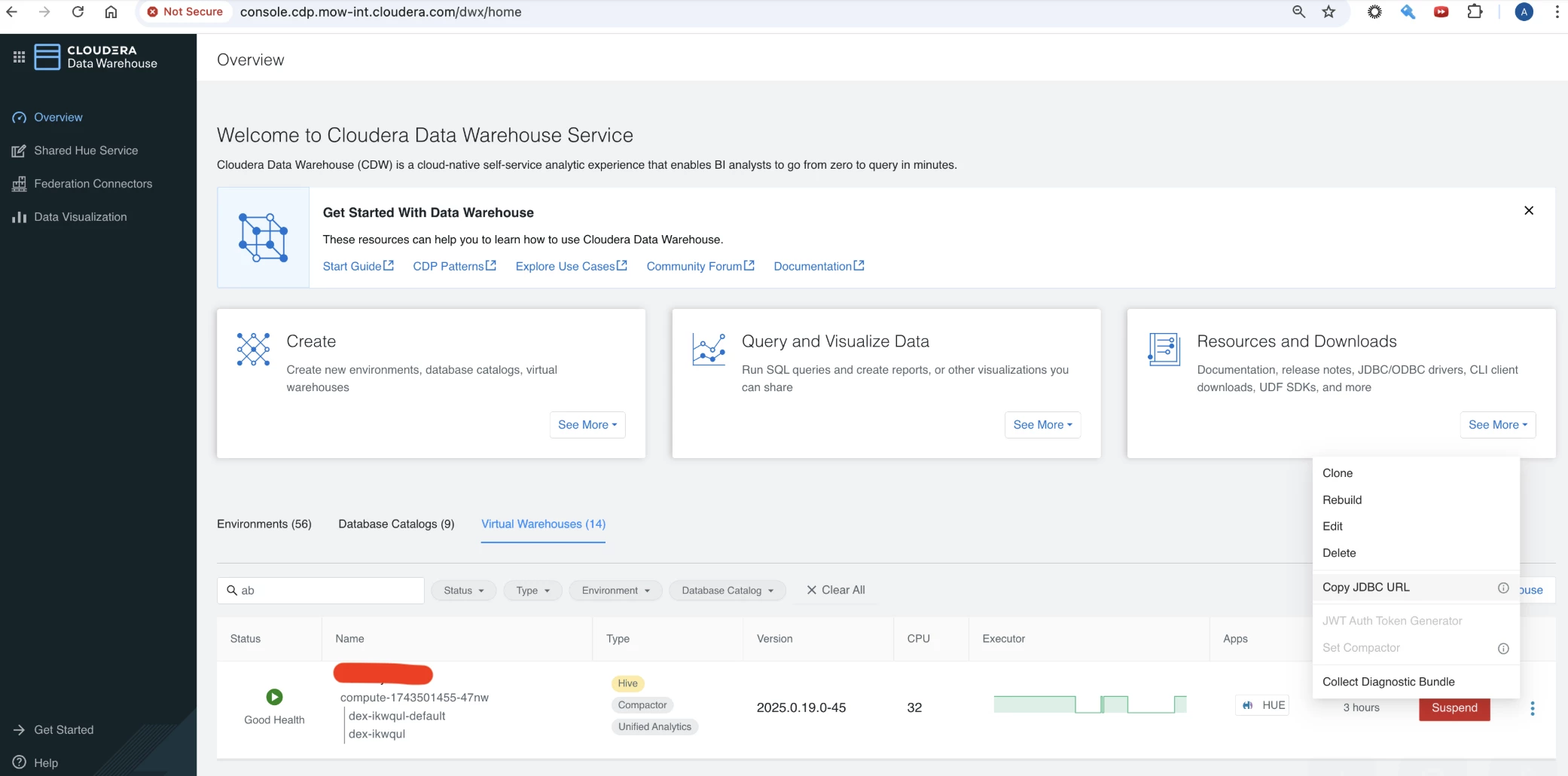

Establishing connectivity to HiveServer2
Based on your infrastructure setup, you can use one of these methods to establish a connection to HS2 required for HWC:
  • Through Data Hub cluster: Cloudera Data Engineering can connect to HS2 provided by the Data Hub cluster. It can also enforce the FGAC policies through Ranger.
  • Through Cloudera Data Warehouse Data Service: Cloudera Data Engineering can connect to the Virtual Warehouse of Cloudera Data Warehouse through HS2. FGAC policies can also be enforced through Ranger. You can fetch the JDBC URl from the Cloudera Data Warehouse UI as shown in the following screenshot: CDW
  • Through Cloudera Base cluster (on premises): Cloudera Data Engineering can connect to HS2 provided by the Cloudera Base cluster as well.
