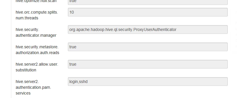

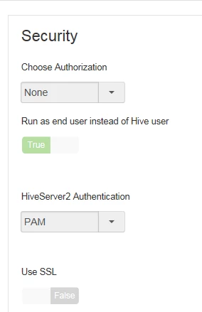

3. Set PAM authentication
In Ambari switch authentication to PAM hive.server2.authentication = PAM
4. Set PAM modules
Different possibilities, what worked for me was login, sshd: hive.server2.authentication.pam.services=login,sshd
