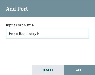

Input Port
The MiniFi flow will send data to a Remote Process Group. The Remote Process Group requires an Input Port. From the NiFi menu, drag the Input Port icon to the canvas.
In the Add Port dialog that is displayed, type a name for your port. I used From Raspberry Pi. You should see something similar to the following:
Click the blue ADD button.

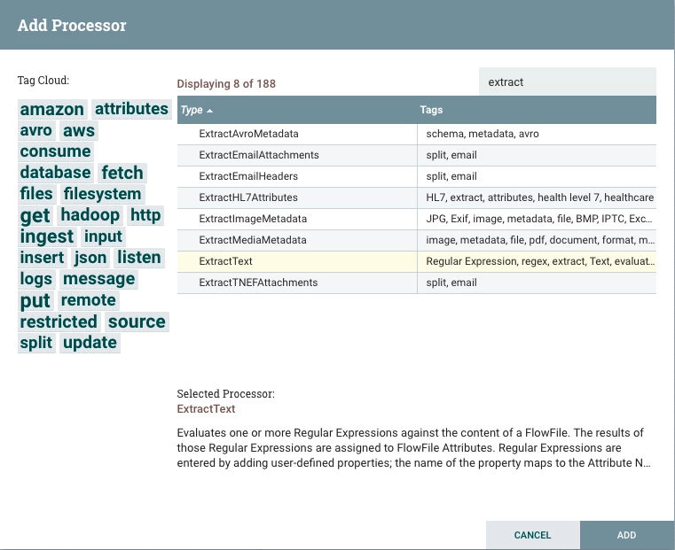

ExtractText
From the NiFi menu, drag the Processor icon to the canvas. In the Filter box, enter extract. You should see something similar to the following:
Select the ExtractText processor. Click on the blue ADD button to add the processor to the canvas.

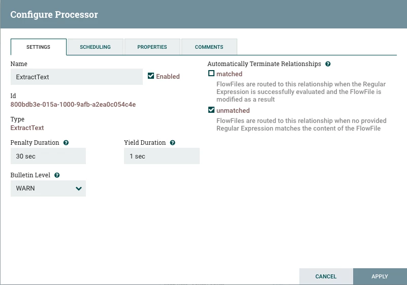

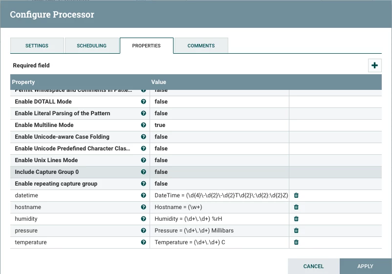

Now we need to configure the ExtractText processor. Right click on the processor and select the Configure menu option.
On the SETTINGS tab of the ExtractText processor, you should check the unmatched box under Automatically Terminate Relationships. This will drop any records which we fail to extract text from. You should see something similar to the following:
On the PROPERTIES tab of the ExtractText processor, there are a few changes we need to make.
First, we want want to set Enable Multiline Mode to true. This allows the Regular Expressions to match across multiple lines. This is important because our data is coming in as multiline data.
Second, we want to set Include Capture Group 0 to false. Each Regular Expression we are using has only a single group. If we left this value to true, each field we extract would have duplicate values which would go unused as <attribute name>.0.

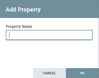

Third, we need to add additional fields to the processor which allows us to define our Regular Expressions. If you click the + icon in the upper right corner of the dialog, you should see something similar to the following:
We are going to add a property called hostname. This will hold the value from the line Hostname = in the data. Click the blue OK button. Now you should see another dialog where you enter the regular expression. You should see something similar to the following:
Enter the following Regular Expression:
Hostname = (\w+)
We need to repeat this process for each of the other data elements coming from the Raspberry Pi. You should have the following extra fields defined as separate fields:
property: hostname
value: Hostnamne = (\w+)
property: datetime
value: DateTime = (\d{4}\-\d{2}\-\d{2}T\d{2}\:\d{2}:\d{2}Z)
property: temperature
value: Temperature = (\d+\.\d+) C
property: humidity
value: Humidity = (\d+\.\d+) %rH
property: pressure
value: Pressure = (\d+\.\d+) Millibars
When you have entered each of these properties, you should see something similar to the following:
Click the blue APPLY button to save the changes.

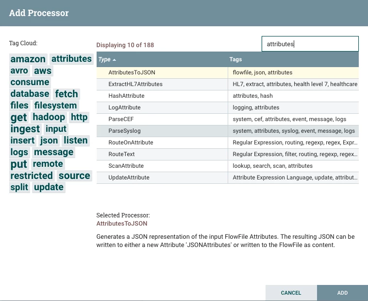

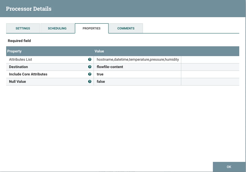

AttributesToJSON
From the NiFi menu, drag the Processor icon to the canvas. In the Filter box, enter attributes. You should see something similar to the following:
Select the AttributesToJSON processor. Click on the blue ADD button to add the processor to the canvas.
Now we need to configure the AttributesToJSON processor. Right click on the processor and select the Configure menu option.
On the PROPERTIES tab of the AttributesToJSON processor, there are a few changes we need to make.
For the Attributes List property, we need to provide a comma-separated list of attributes we want the processor to pass on. Click inside the Value box next to Attributes List. Enter the following value:
hostname,datetime,temperature,pressure,humidity
For the Destination property, set the value to flowfile-content. We need the values to be in the flowfile content itself as JSON which is needed by the PutSolrContentStream processor. Otherwise the flowfile content will contain the raw data (not JSON) coming from the Raspberry Pi. This will cause Solr to throw errors because it is not able to parse request.

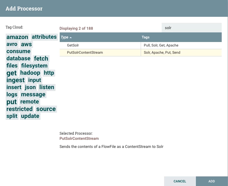

From the NiFi menu, drag the Processor icon to the canvas. In the Filter box, enter solr. You should see something similar to the following:
Select the PutSolrContentStream processor. Click on the blue ADD button to add the processor to the canvas.

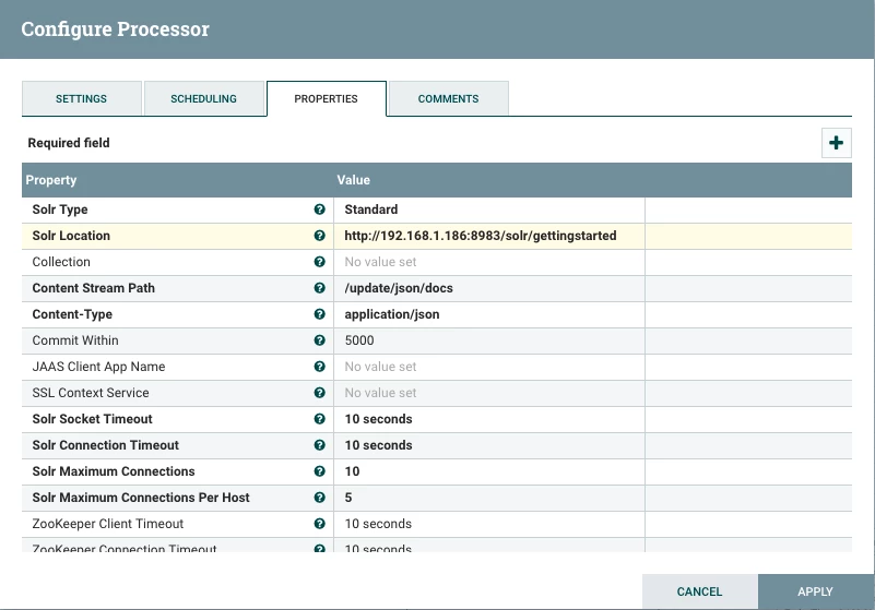

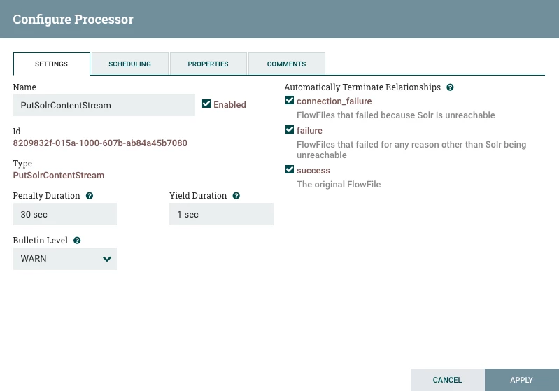

Now we need to configure the PutSolrContentStream processor. Right click on the processor and select the Configure menu option.
On the SETTINGS tab of the PutSolrContentStream processor, you should check the connection_failure, failure, and success boxes under Automatically Terminate Relationships. Since this is the end of the flow, we can terminate everything. You could expand on this by retrying failures, or logging errors to a text file.
On the PROPERTIES tab of the PutSolrContentStream processor, we need to make a few changes.
Set the Solr Type property to Standard. We don't need to run SolrCloud for our demo.
Set the Solr Location to http://192.168.1.186:8983/solr/gettingstarted. You should use the IP address of your computer. When we start Solr up, we'll be using the gettingstarted collection, so it's part of the URL. If we were using SolrCloud, we put put the collection name in the Collection property instead.
The first set of properties should look similar to the following:

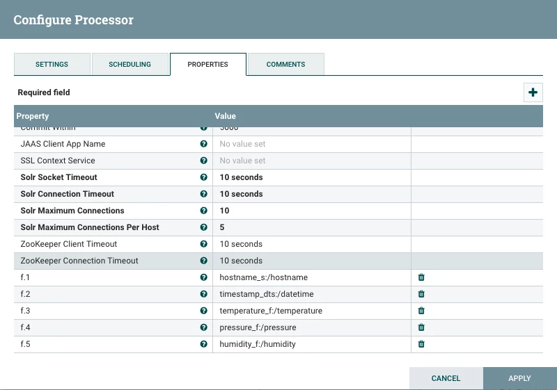

Now we need to add fields for indexing in Solr. Click the + icon in the upper right corner of the processor. The Add Property dialog will be displayed. For the first field, enter f.1 and click the ADD button. For the value enter hostname_s:/hostname. The hostname_s part of the value says to store the content in the Solr field called hostname_s, which uses the dynamic schema to treat this field as a string. The /hostname part of the value says to pull the value from the root of the JSON where the JSON node is called hostname.
We need to repeat this process for each of the other data elements coming from the Raspberry Pi. You should have the following fields defined as separate fields:
property: f.1
value: hostname_s:/hostname
property: f.2
value: timestamp_dts:/datetime
property: f.3
value: temperature_f:/temperature
property: f.4
value: pressure_f:/pressure
property: f.5
value: humidity_f:/humidity

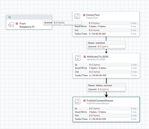

Now that we have our processors on the canvas, we need to connect them. Drag the connection icon from the Input Port processor to the ExtractText processor.
Drag the connection icon from the ExtractText processor to the AttributesToJSON processor.
Drag the connection icon from the AttributesToJSON processor to the PutSolrContentStream processor.
You should have something that looks similar to the following:

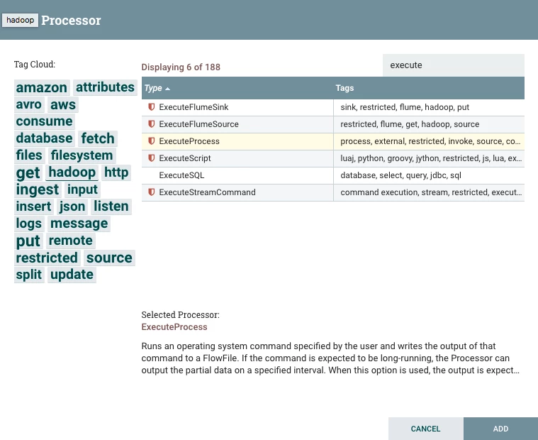

ExecuteProcess
The first thing we need to do is add a processor to execute the bash script we created on the Raspberry Pi.
Drag the Processor icon to the canvas. Enter execute in the Filter box. You should see something similar to the following:
Select the ExecuteProcess processor. Click on the blue ADD button to add the processor to the canvas.

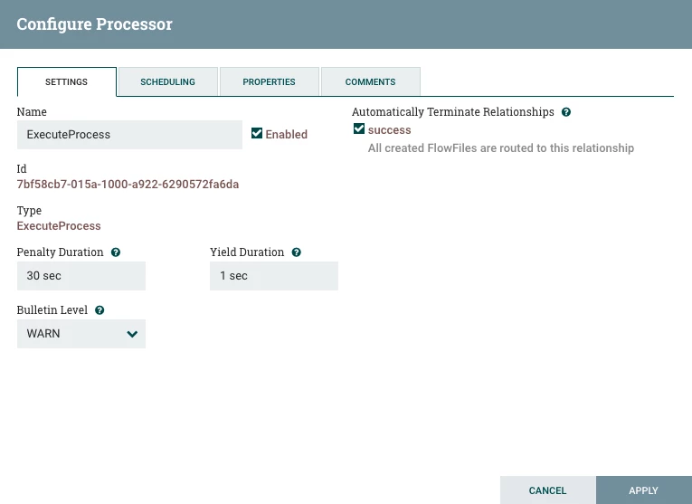

Now we need to configure the ExecuteProcess processor. Right click on the processor and select the Configure menu option.
On the SETTINGS tab you should check the success box under Automatically Terminate Relationships. You should see something similar to the following:

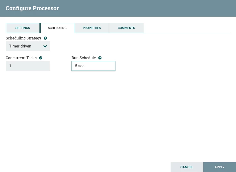

On the Scheduling tab we want to set the Run Schedule to 5 sec. This will run the processor every 5 seconds. You should see something similar to the following;

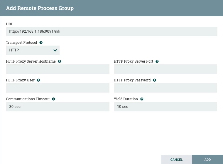

Now we need to add a Remote Process Group to our canvas. This is how the MiniFi flow is able to send data to Nifi. Drag the Remote Process Group icon to the canvas.
For the URL enter the URL you use to access your NiFi UI. In my case that is http://192.168.1.186:9090/nifi. Remember the default port for NiFi is 8080. For the Transport Protocol select HTTP. You can leave the other settings as defaults. You should see something similar to the following:
Click the blue ADD button to add the Remote Process Group to the canvas.

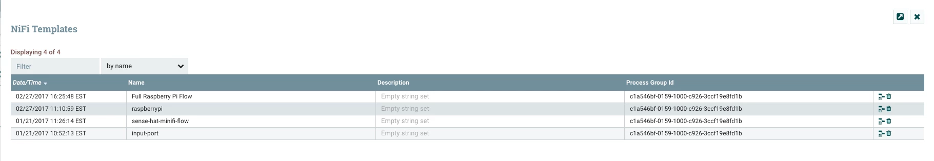

Save Template
We need to save the MiniFi portion of the flow as a template. Select the ExecuteProcess, Remote Process Group and the connection between them using the shift key to allow multi-select.
Click on the Create Template icon (second icon from the right on the top row) in the Operate Box on the canvas. It looks like the following:
The Create Template dialog will be displayed. Give your template a name. I used rasbperrypi and click the blue CREATE button.

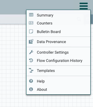

Now click on the main Nifi Menu button in the upper right corner of the UI. You should see something like the following:
Now click the Templates options. This will open the NiFi Templates dialog. You will see a list of templates you have created. You should see something similar to the following:
Now find the template you just created and click on the Download button on the right hand side. This will save a copy of the flowfile in xml format on your local computer.

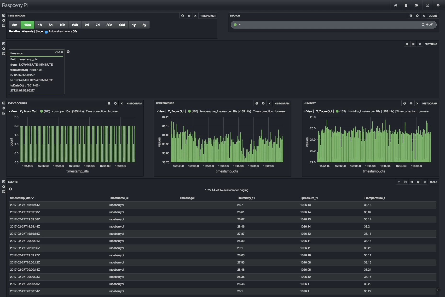

Dashboard
You can easily add Banana to Solr to create a dashboard. Here is an example:
Review
If you successfully followed along with this tutorial, you should have MiniFi collecting data from your Sense HAT sensor on your Raspberry Pi. The MiniFi flow should be sending that data to NiFi on your computer which then sends to the data to Solr.
