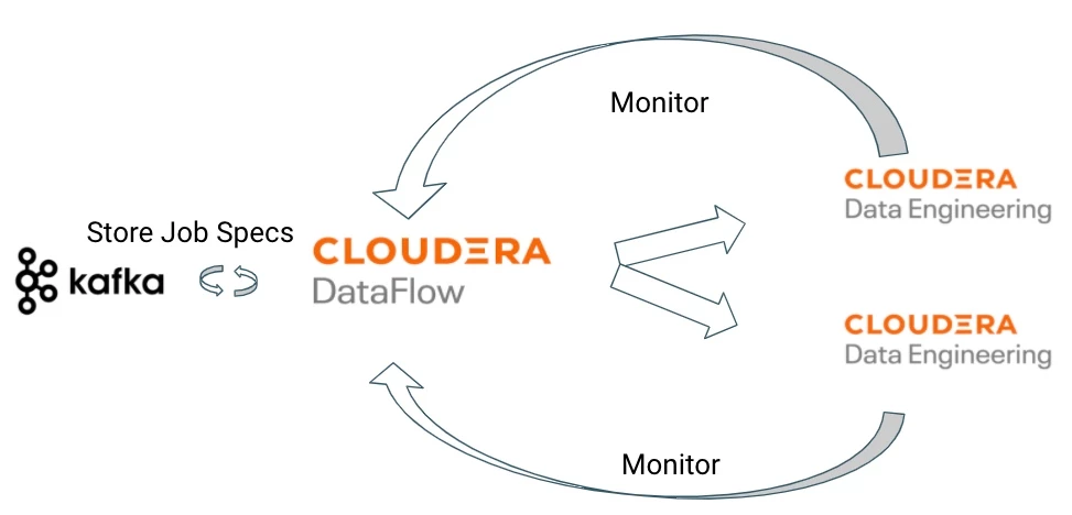

High-Level WorkFlow
At a high level, the NiFi workflow does the following:
  • Exposes a single rest endpoint for CDE job submission
  • CDE workload balancing between multiple CDE clusters
    • If only a single CDE cluster is available, it will queue jobs until compute bandwidth is available
  • Queue jobs if CDE clusters are too busy
    • Jobs will re-run if set in the queue
    • If the number of retry for a job spec is greater than 3 (parameterized), an alert will be triggered
  • Monitor jobs from start to finish
  • Alert if job
    • Fails
    • Run time out of predetermined max run time
      • i.e. jobs run for 10 minutes and max run time for jobs is set to 5 minutes

Once a CDE job spec is sent to NiFi, NiFi does the following:
  1. Write job spec to Kafka ktopic-inbound-jobs (nifi parameter) topic
  2. Pull jobs from Kafka ktopic-inbound-jobs (nifi parameter) topic
    1. New jobs- ktopic-inbound-jobs (nifi parameter) topic
    2. retry jobs- ktopic-retry (nifi parameter) topic
    3. Monitoring jobs- ktopic-job-monitoring (nifi parameter) topic
  3. Fetch CDE API tokens
  4. Check if the primary cluster current run count is less than run_count_limit (nifi parameter)
  5. Check if the primary cluster current starting count is less than start_count_limit (nifi parameter)
    1. If run or start counts are not within limit, retry the same logic on the secondary cluster (if available, secondary-vc-available)
    2. If run/start counts are within limit, job spec will be submitted to CDE
    3. If run/start counts are not within limit for primary and secondary CDE and the number of retries is less than wait-count-max (nifi parameter), job spec will be written to a Kafka ktopic-retry topic (nifi parameter)
  6. Monitoring
    1. NiFi will call CDE to determine the current status of Job ID (pulled from ktopic-job-monitoring)
    2. If the job end is successful, nothing more will happen here.
    3. If the job ends with failure, job spec will be written to Kafka ktopic-fail topic
    4. If the job is running and run time is less than job-runtime-threshold-ms
      1. Write job spec to ktopic-job-monitoring
      2. Else send an alert (nifi parameter)

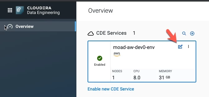

  1. To fetch the token API, click the pencil icon:

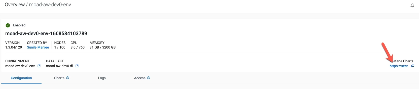

  2. Click on Grafana URL:
    The URL will look something like this:
https://service.cde-zzzzzz.moad-aw.aaaaa-aaaa.cloudera.site/grafana/d/sK1XDusZz/kubernetes?orgId=1&refresh=5s
  • Set the NiFi parameter primary-vc-token-api to the first part of the URL:

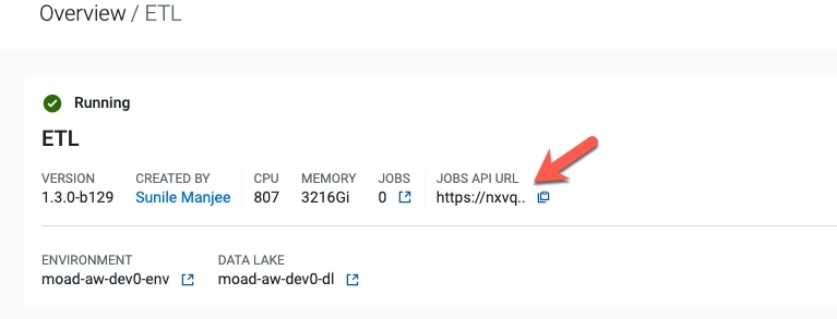

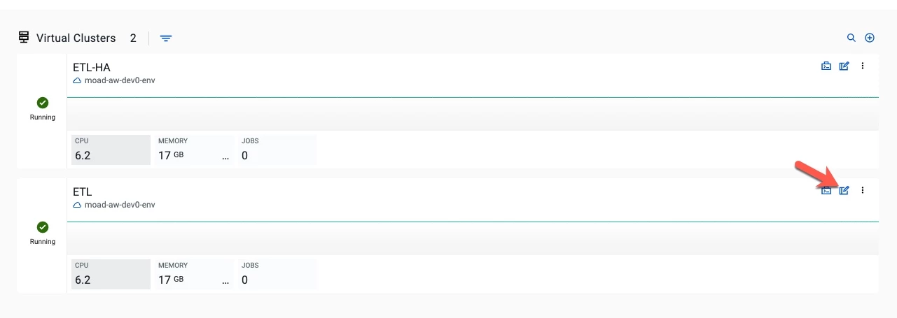

Now get the Jobs API for both primary and secondary (if available). For a virtual cluster,
  1. Click the pencil icon
  2. Click Jobs API URL to copy the URL
    The jobs URL will look something like this:
https://aaa.cde-aaa.moad-aw.aaa-aaa.cloudera.site/dex/api/v1
  • Fetch the first part of the URL and set the NiFi parameter primary_vc_jobs_api. Do the same steps for secondary_vc_jobs_api

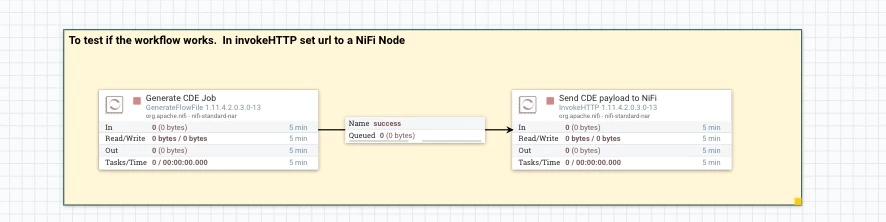

Run a CDE job
Inside of the NiFi workflow, there is a test flow to verify the NiFi CDE jobs pipeline works:
To run the flow, inside of InvokeHTTP, set the URL to one of the NiFi nodes. Run it and if the integration is working successfully; you will see a job running in CDE.
