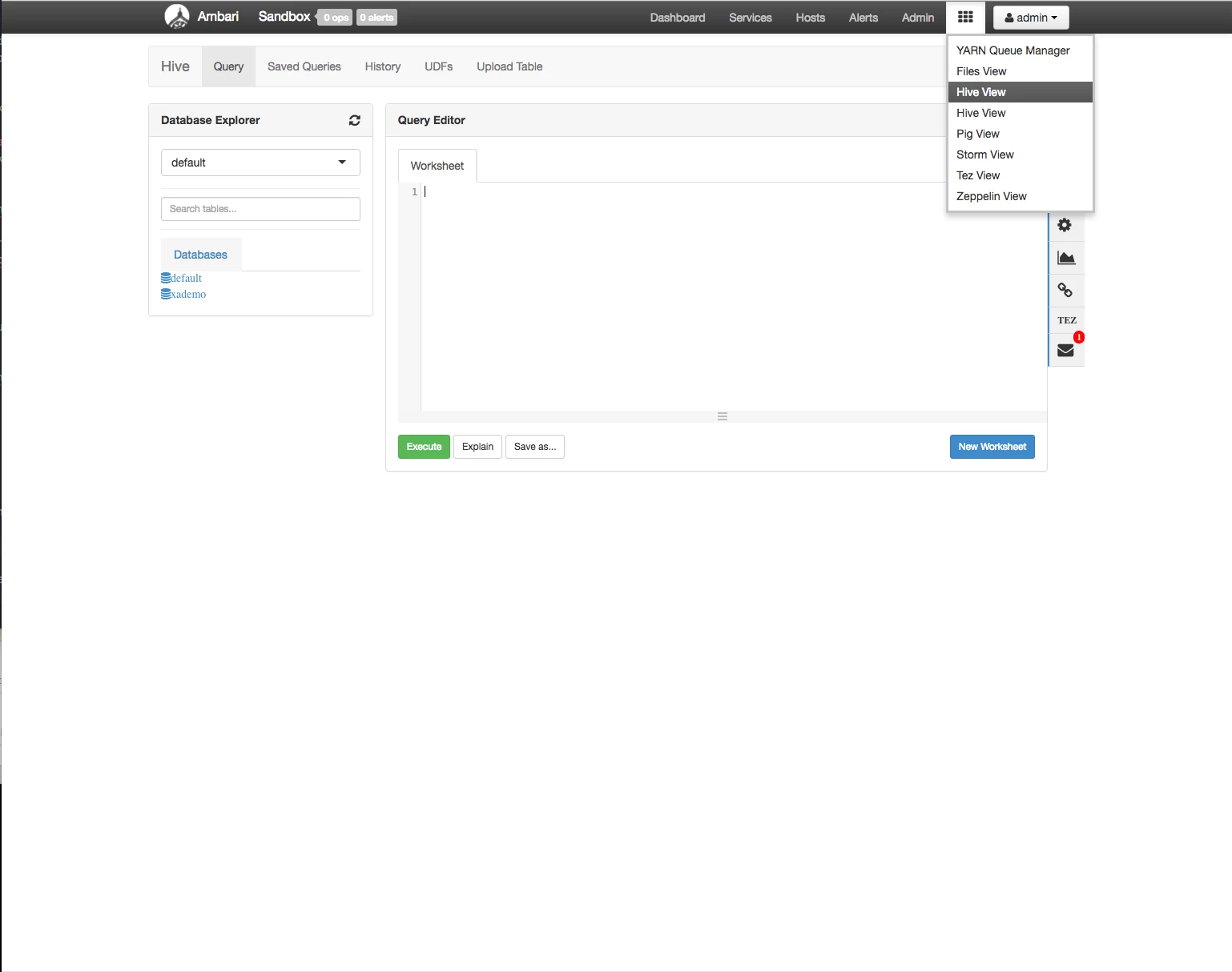

5. Create External Hive table on uncompressed data
We are going to create an external table in Hive to view the uncompressed data. We will do this using the Hive View in Ambari.
The file schema is straight forward. The first line of the CSV is the header line. Normally you would remove that line as part of your processing, but we’ll leave it in to save time.
Enter the following Hive DDL and click the Execute button

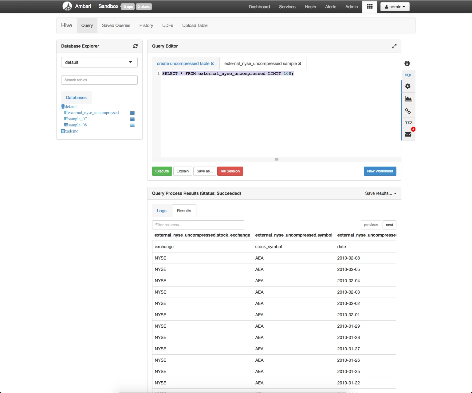

6. Verify you can see the data in Hive
Click the New Worksheet button. Enter the following query:
SELECT * FROM external_nyse_uncompressed LIMIT 100;
You should see something like the following:

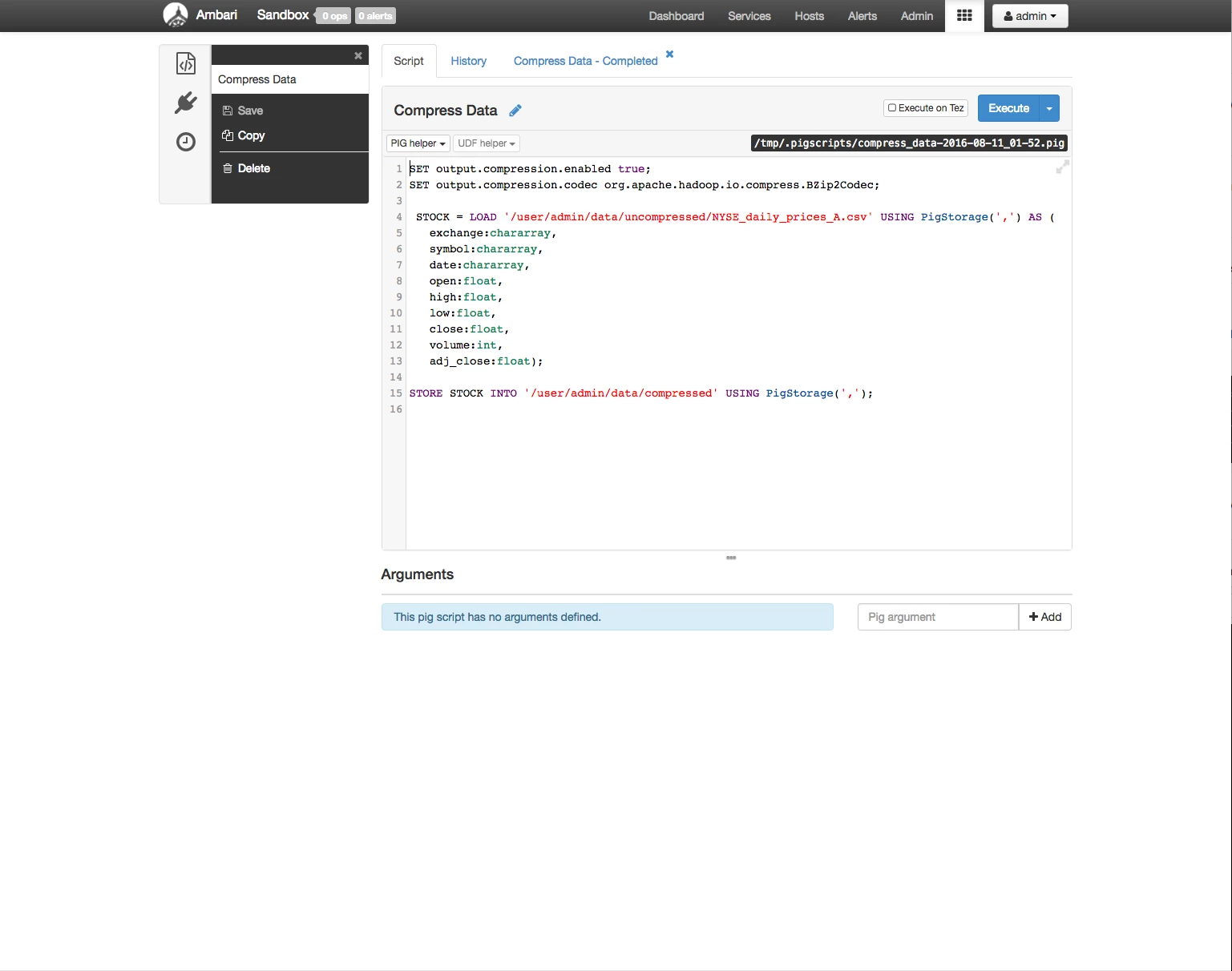

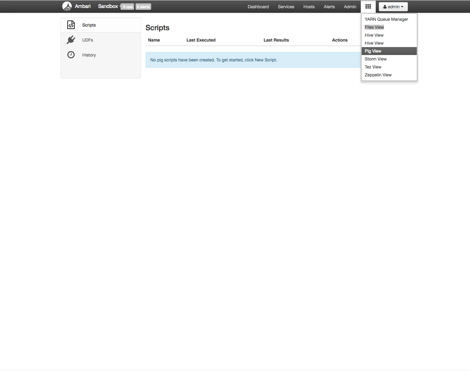

7. Create Pig Script
We are going to use the Pig View to create a Pig script to compress our data on HDFS.
Enter Pig script
SET output.compression.enabled true;
SET output.compression.codec org.apache.hadoop.io.compress.BZip2Codec;
STOCK = LOAD '/user/admin/data/uncompressed/NYSE_daily_prices_A.csv' USING PigStorage(',') AS (
exchange:chararray,
symbol:chararray,
date:chararray,
open:float,
high:float,
low:float,
close:float,
volume:int,
adj_close:float);
STORE STOCK INTO '/user/admin/data/compressed' USING PigStorage(',');
Note: The final output directory can not exist prior to running the script or Pig will throw an error. In this case, the “compressed” directory should not yet exist. Pig will create /user/admin/data/compressed when it stores the output data.

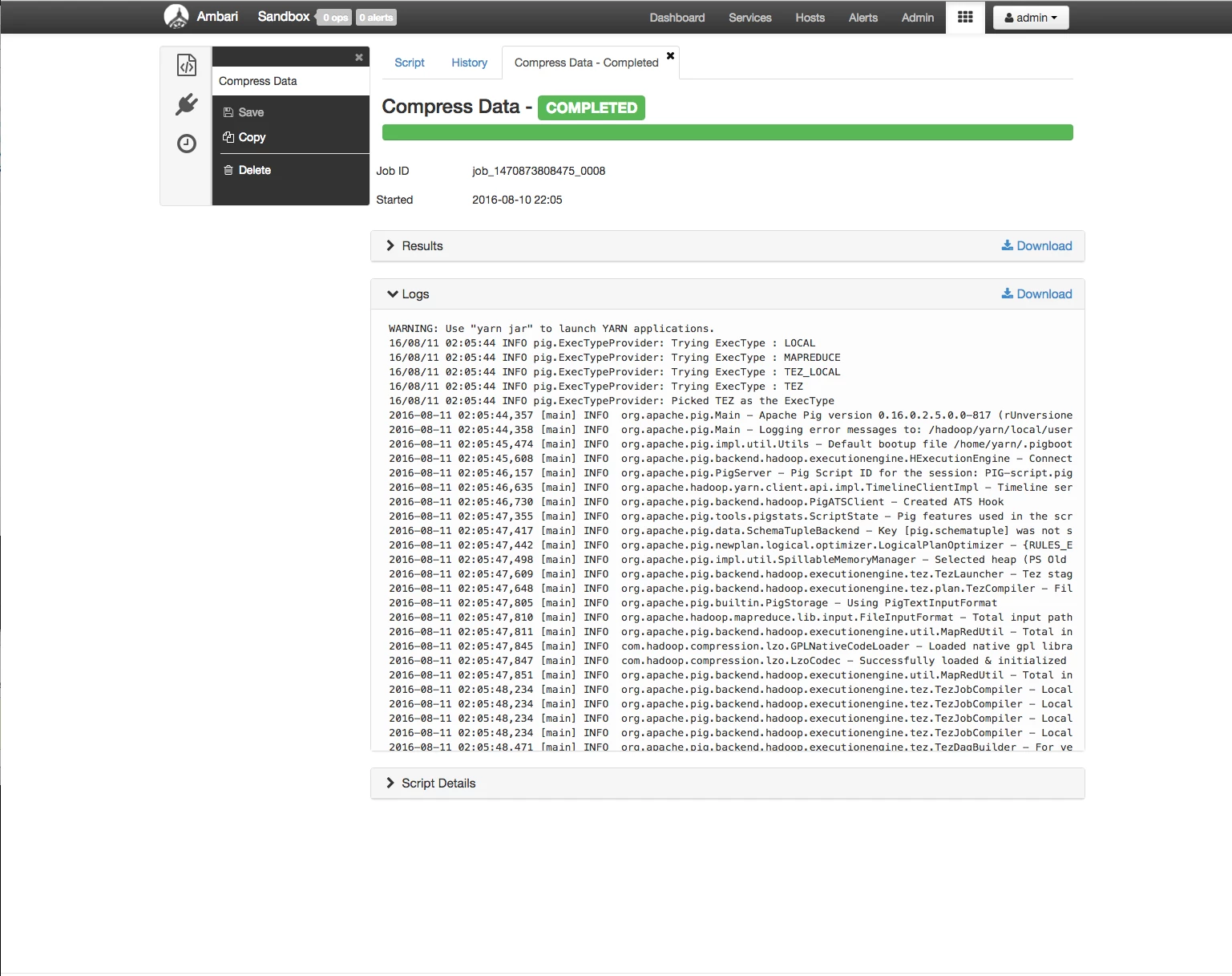

After you have entered the script, click the "Execute" button. When the Pig job finishes, you should see something like this:

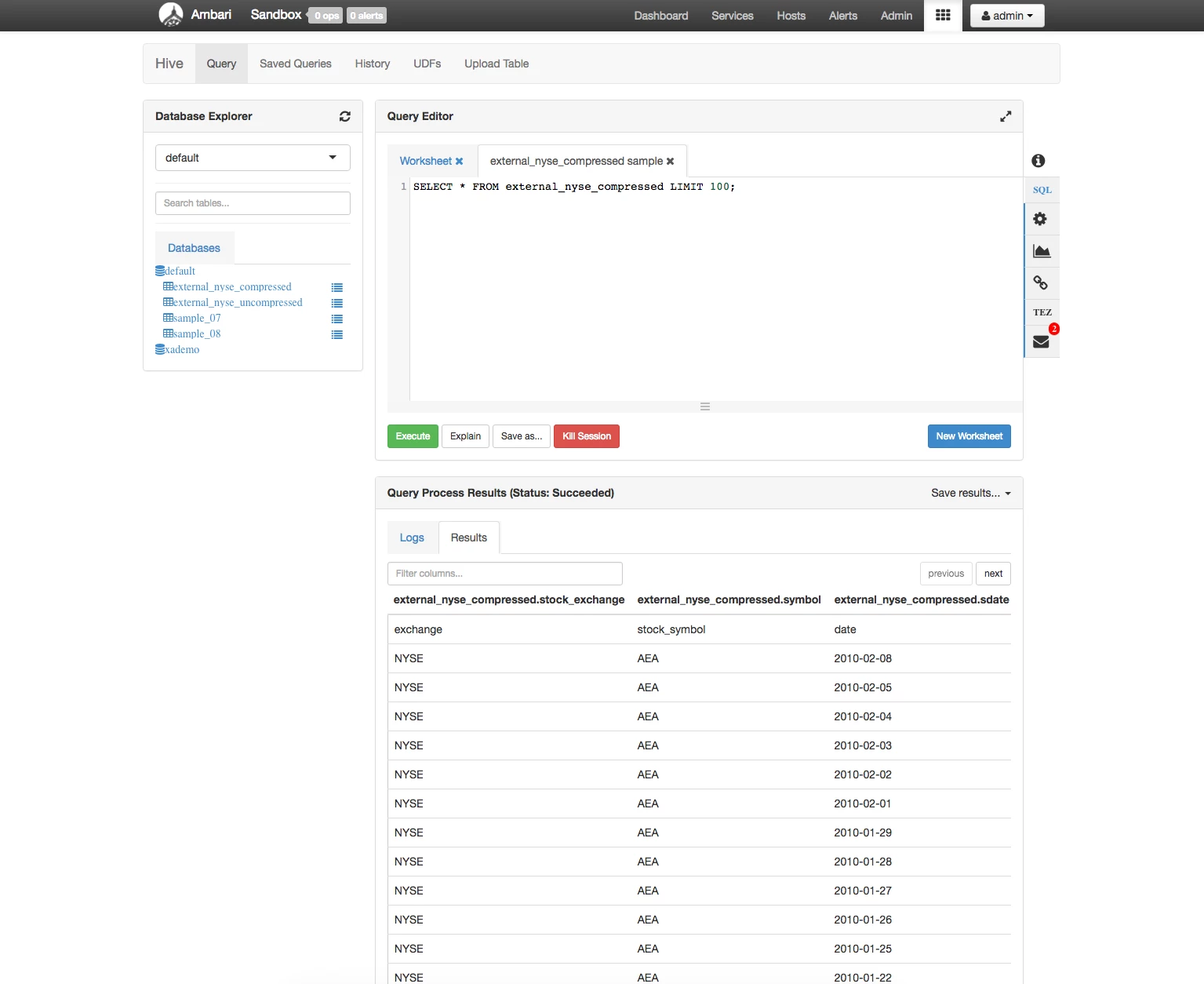

9. Verify you can see the data Hive
SELECT * FROM external_nyse_compressed LIMIT 100;
