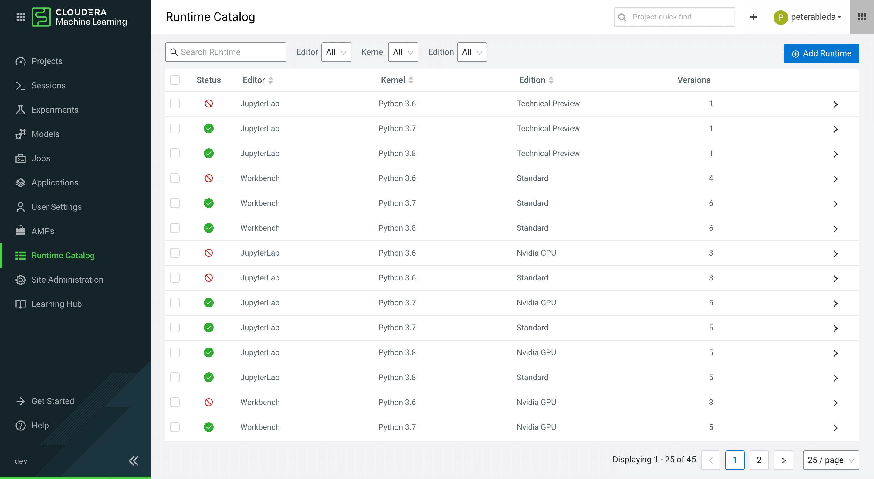

Navigate to the Runtime Catalog for the CML start page, and click Add Runtime.

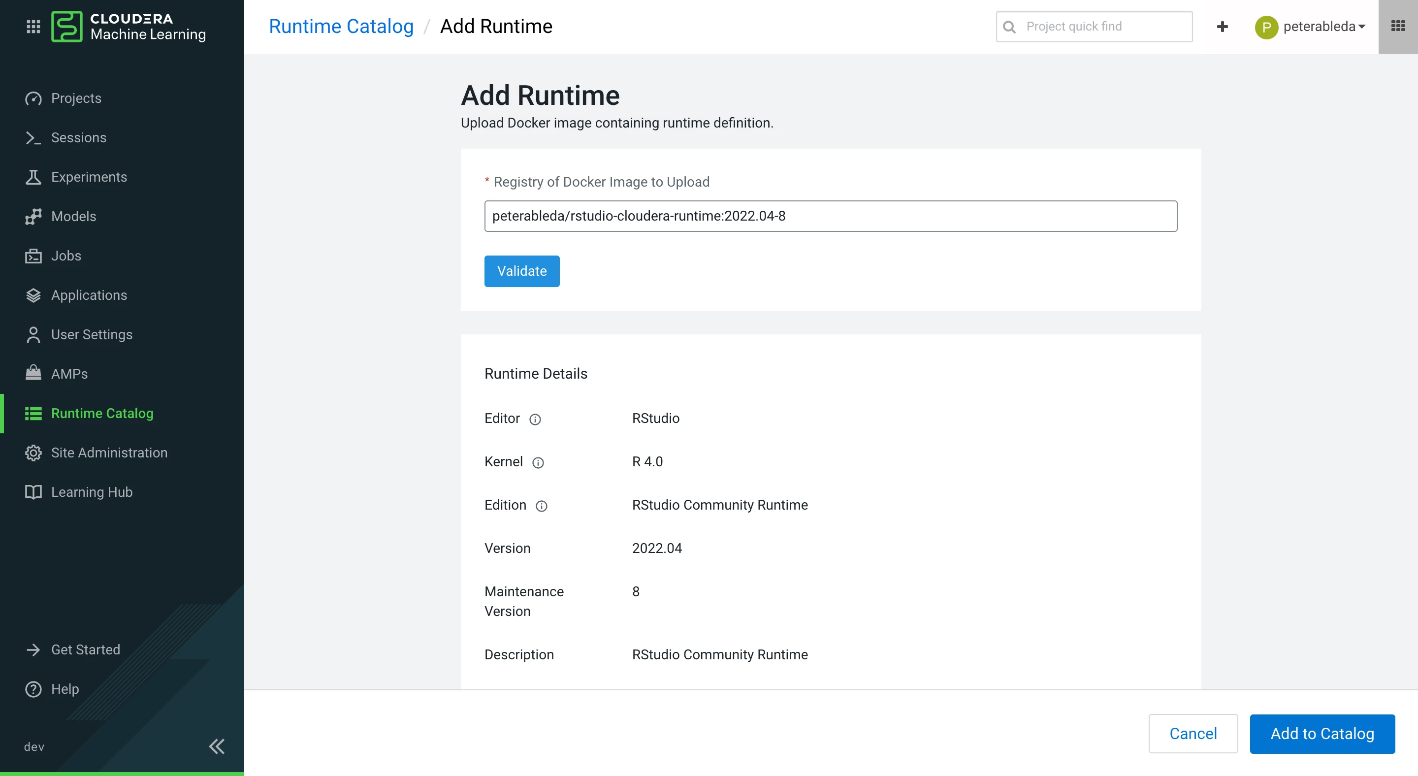

In the next step, paste in the link to the image you pushed in Step 1 and click Validate. Your CML instance will need to have to access this container registry to pull the image. If this is a restricted or air-gapped installation, public container registries might not work and will require a private container registry deployed in an accessible network location. The validation process will confirm the image has the correct labels and can be imported. Click Add to Catalog when you are ready.

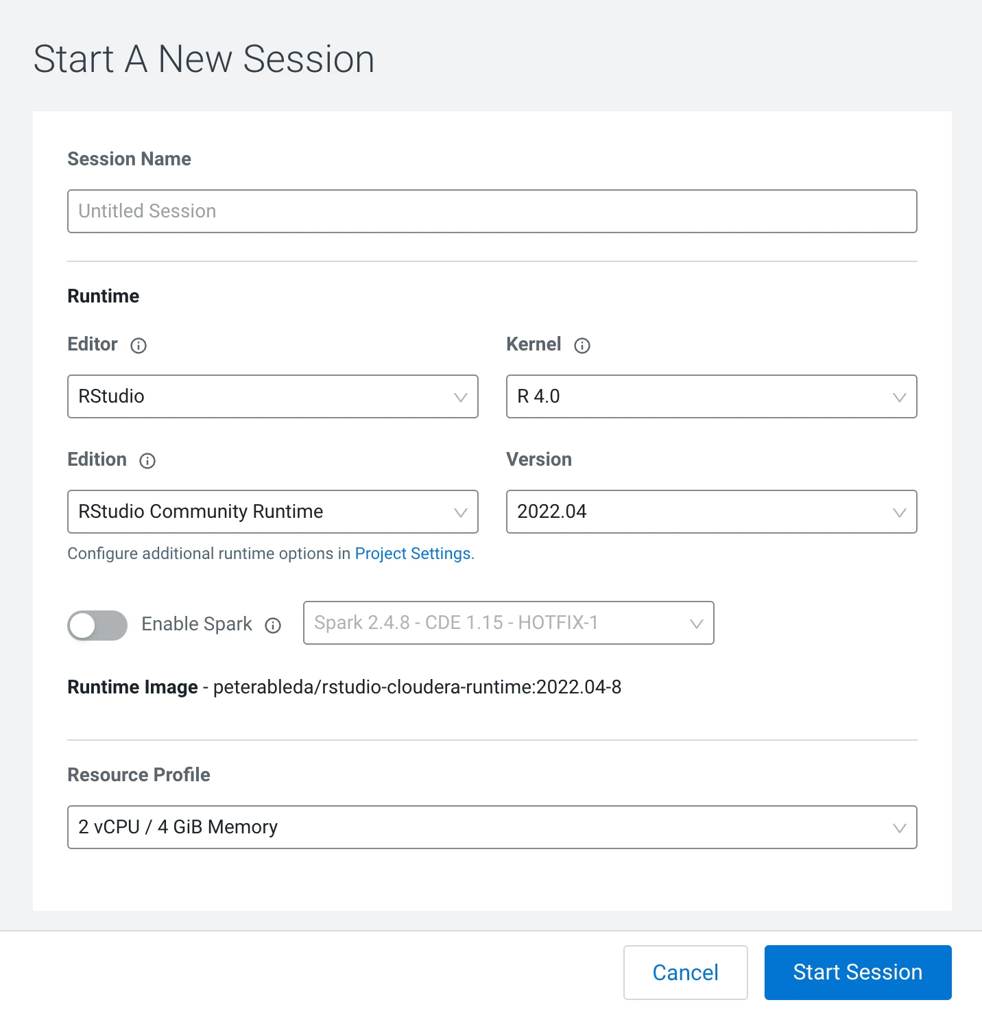

Assuming all went well in the last step, you should now be able to use RStudio as an editor when starting a new session. From the New Session page, select RStudio as the editor:

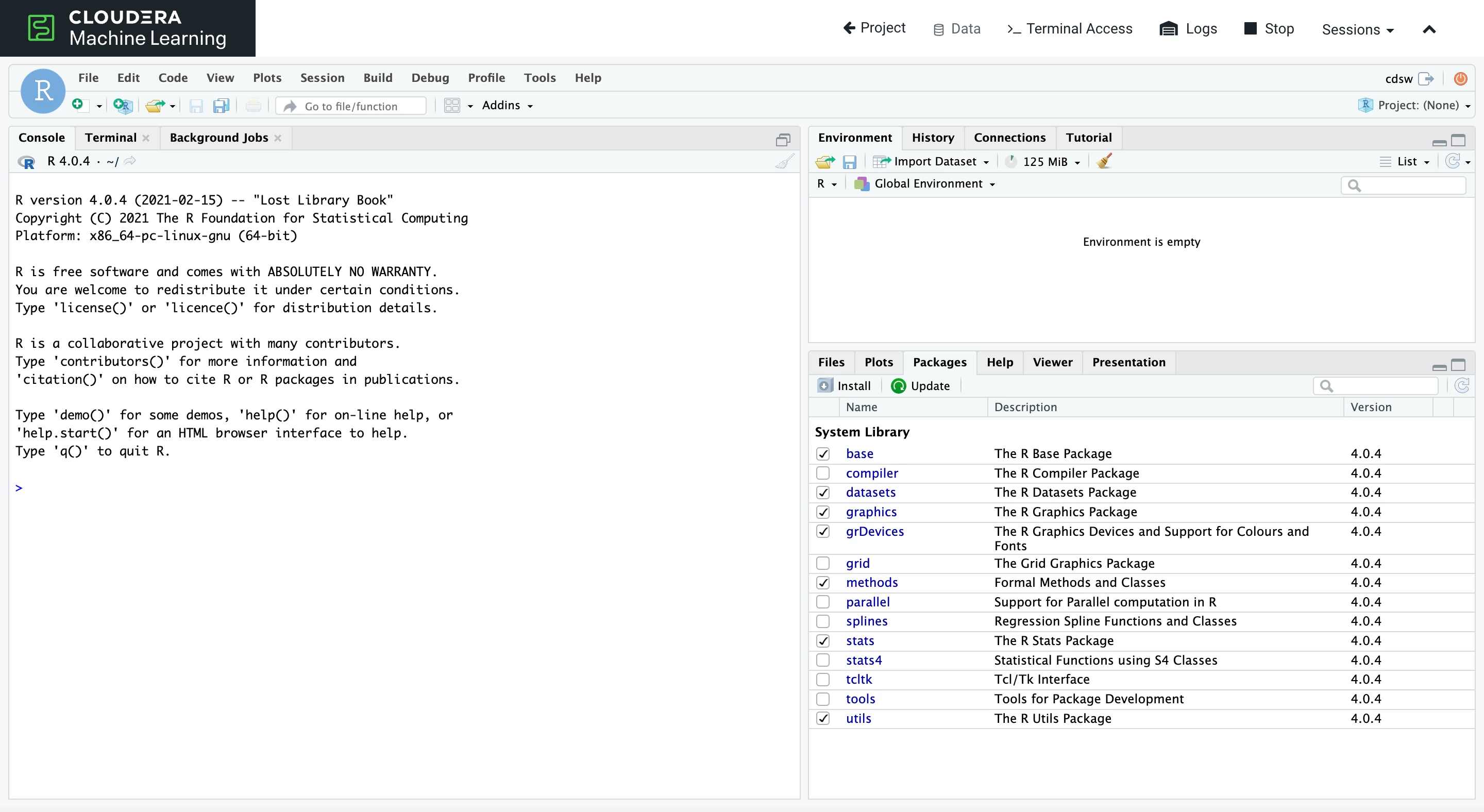

Once the session launches, you will see a familiar view of RStudio embedded into the CML UI, in the same way, JupyterLab is embedded.
