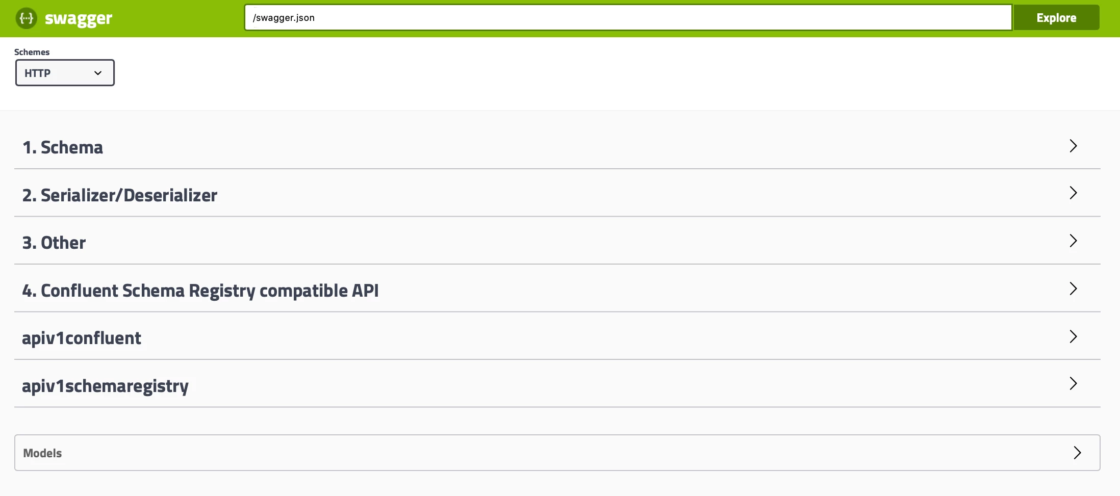

In working with some advanced features (enable/disable compatibility) I was able to find the Swagger API link for my Schema Registry.  The link should look like:
http://hdf.cloudera.com:7788/swagger/#/
Simply add /swagger/ after your Schema UI port and it will take you there.
