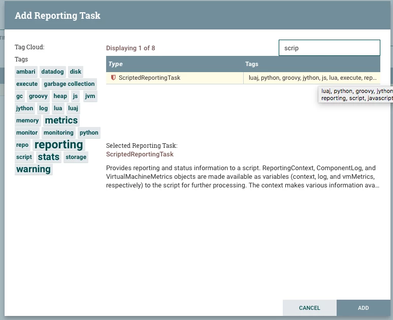

On the Add reporting task dialog, search for ScriptedReportingTask. Double click on ScriptedReportingTask option in the results or select the row and click Add.

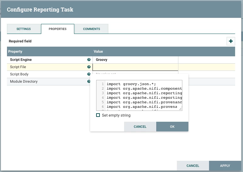

You will see a new ScriptedReportingTask in the reporting tasks list. Click on the pencil icon 12087-pencil.png , to edit the reporting task.
You will see a reporting task window. Select groovy as the Script Engine choice and paste the script below in Script Body. Make sure to change the location of the file where your events will be written to.

Click ok and apply. Click on the "Play " Button to active the reporting task. I had set the scheduling frequency for the task on mine to 10 secs, so i could see the results right away. You can set it to a higher value as needed.
