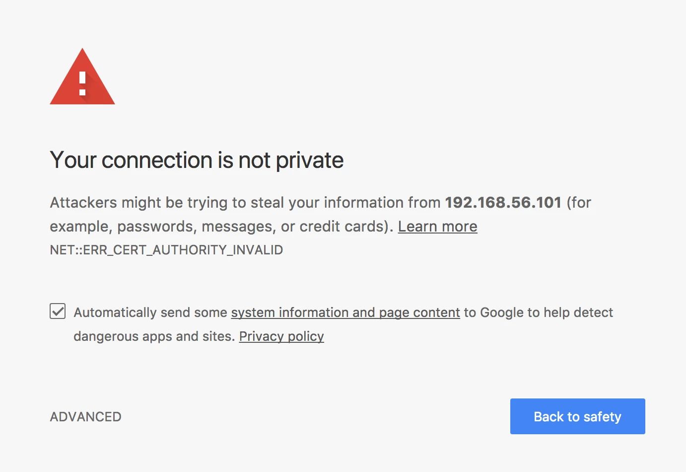

Cloudbreak should now be running. We can login to the UI using the IP address specified in the Profile. In our case that is https://192.168.56.100. Notice Cloudbreak uses https.
Your browser may display a warning similar to the following:
This is because of the self-signed certificate used by Cloudbreak. You should accept the certificate and trust the site. Then you should see a login screen similar to the following:

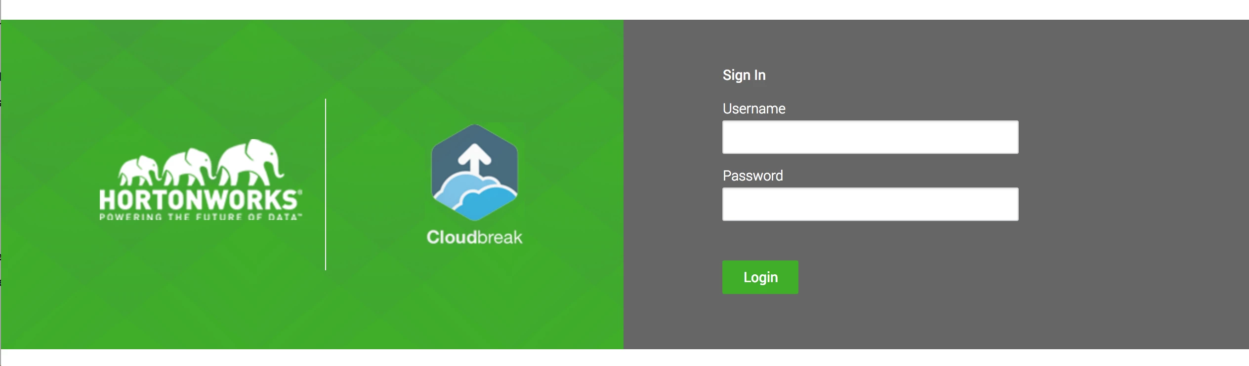

At this point you should be able to see the Cloudbreak UI screen where you can manage your credentials, blueprints, etc. This tutorial doesn't cover setting up credentials or deploying a cluster. Before you can deploy a cluster you need to setup credentials. See this link for setting up your credentials:
