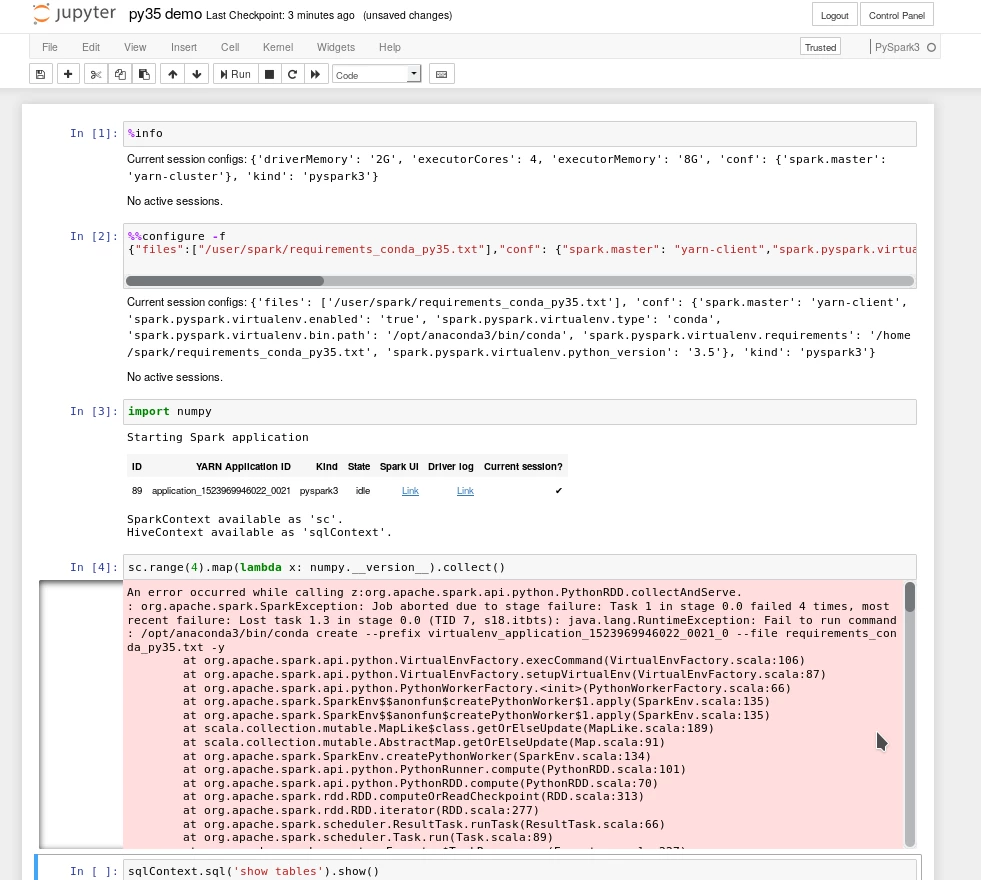

is it possible to submit such a spark job via livy . ?
I am trying to subit spark jobs on yarn with a jupyter notebook using spark magic and livy.
getting the following error when trying to activate the virtualevn
java.lang.RuntimeException: Fail to run command: /opt/anaconda3/bin/conda create --prefix virtualenv_application_1523969946022_0021_0 --file requirements_conda_py35.txt -y
