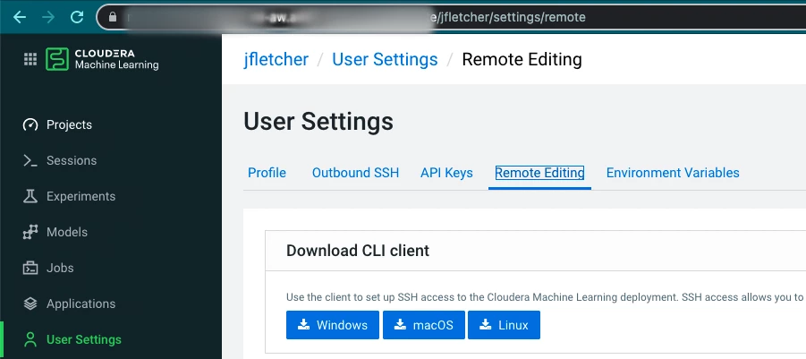

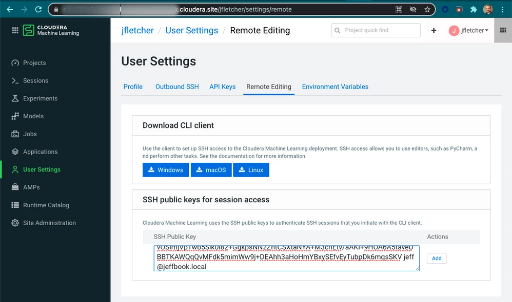

For the first step, you will need to have a copy of the cdswctl command line tool on your local machine. You can get the cli directly from the CML/CDSW instance by going to User Settings > Remote Editing.
The installation process is documented here and you need to get a version that works for your local OS. I'm on a Mac and I have the cdswctl cli in my /usr/local/bin directory:

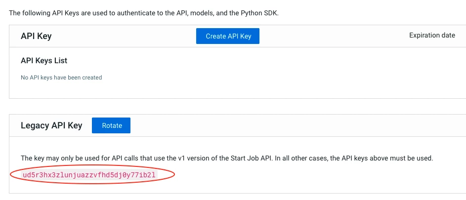

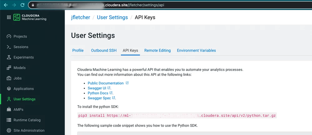

To connect to your CML/CDSW instance you need to know the URL for the main page, your username and your Legacy API key. The first two you should have, your Legacy API key can be found by going to User Settings > API Keys
Currently, CML/CDSW is still using the Legacy API key for remote authentication, but this will be converted to the new API Key format in an upcoming release. Make a note of the Legacy API key. 

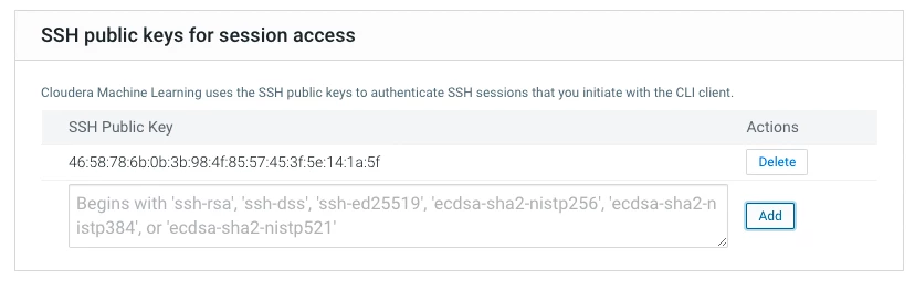

As the connection to the CML/CDSW instance is over SSH, you will need an SSH key pair on your local machine that you can use to authenticate with. If you don't have an SSH key pair, you can generate your own one. You then need to add the public key to the CML/CDSW server in User Settings > Remote Editing.
Following is an example of the public SSH key I used for this setup:
% cat ~/.ssh/id_rsa_hadoop.pub
ssh-rsa AAAAB3NzaC1yc2EAAAADAQABAAABAQDbKNjtDWoeATXCj6byhs.....
I copied that value from the terminal window and pasted it into the SSH Public Key box in the User Settings > Remote Editing page, and clicked Add.
If it's a valid key, you should see a fingerprint ID for that key in the list.

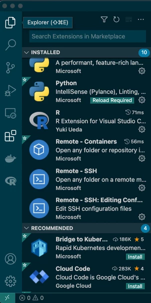

Now that you have established a remote connection, you need to configure VS Code. This process uses the Remote SSH extension for VS Code. You can find and install this in the Extensions section.

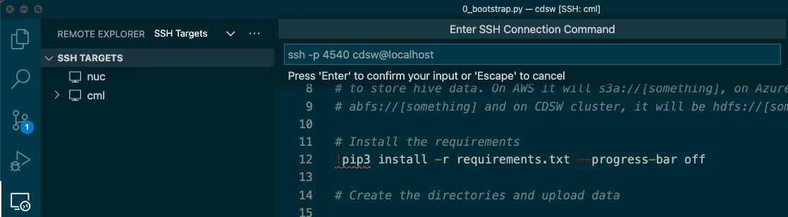

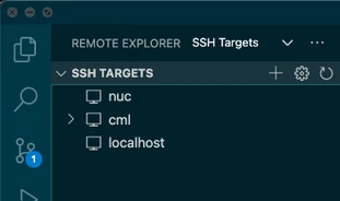

There are a couple of ways of connecting, but the easiest is to go to the new Remote SSH section and add a new target.
This will prompt you for the connection details; in this case: ssh -p 4540 cdsw@localhost

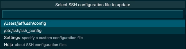

The process will ask you to add this host to your SSH config file and you will see the new SSH target available.

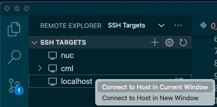

You can connect to this session now. There are a few ways to do this, but the easiest is just right click on the new host:
You can connect your existing window or open a new window.

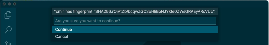

Note: The first time you connect to this server, you'll be prompted to accept the server's SSH fingerprint.

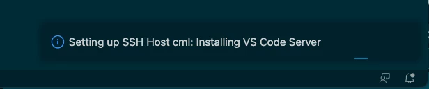

You are now connected to CML/CDSW. VS Code still needs to install and run some helper services on the remote server, so you will see this running on the first connection and it takes a few minutes to complete.

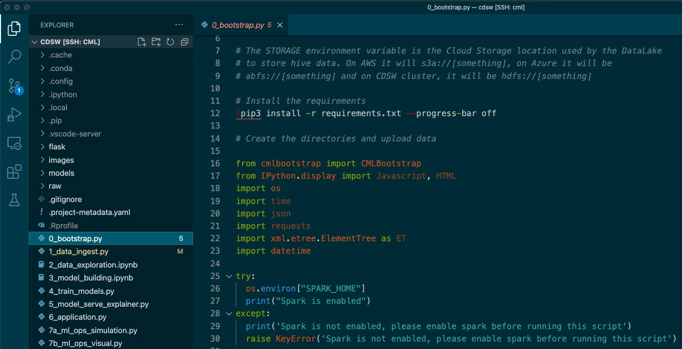

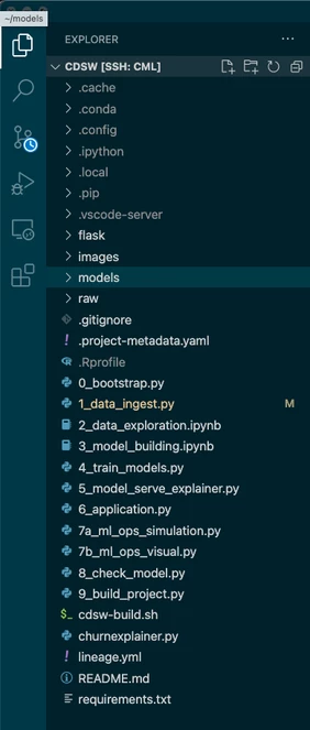

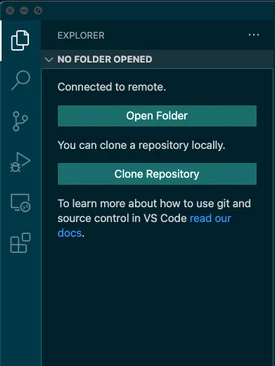

Click 'Open Folder' and navigate to /home/cdsw - this should auto-populate the path. You will now see the project files.

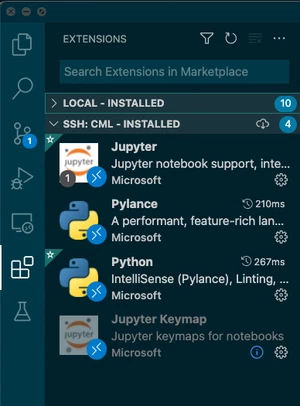

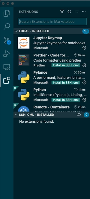

As it stands now, you can edit files and get access to the CML/CDSW terminal with the current remote connection. However, VS Code is significantly more useful if you install the language extensions. For this example, we will install the Python extensions in the remote session. If you do not have the VS Code python extensions installed in your local VS Code instance, do that first.
From there you can use the Extensions section to install the VS Code Python extension into the remote instance. VS Code includes Pylance and Jupyter extensions with the Python extension.
From here you are good to go for editing Python files and notebooks with all of VS Code's Python coding capabilities.

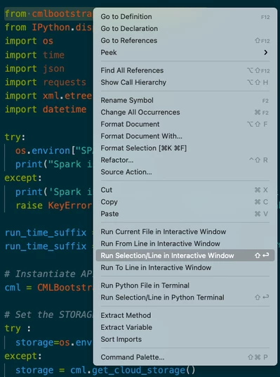

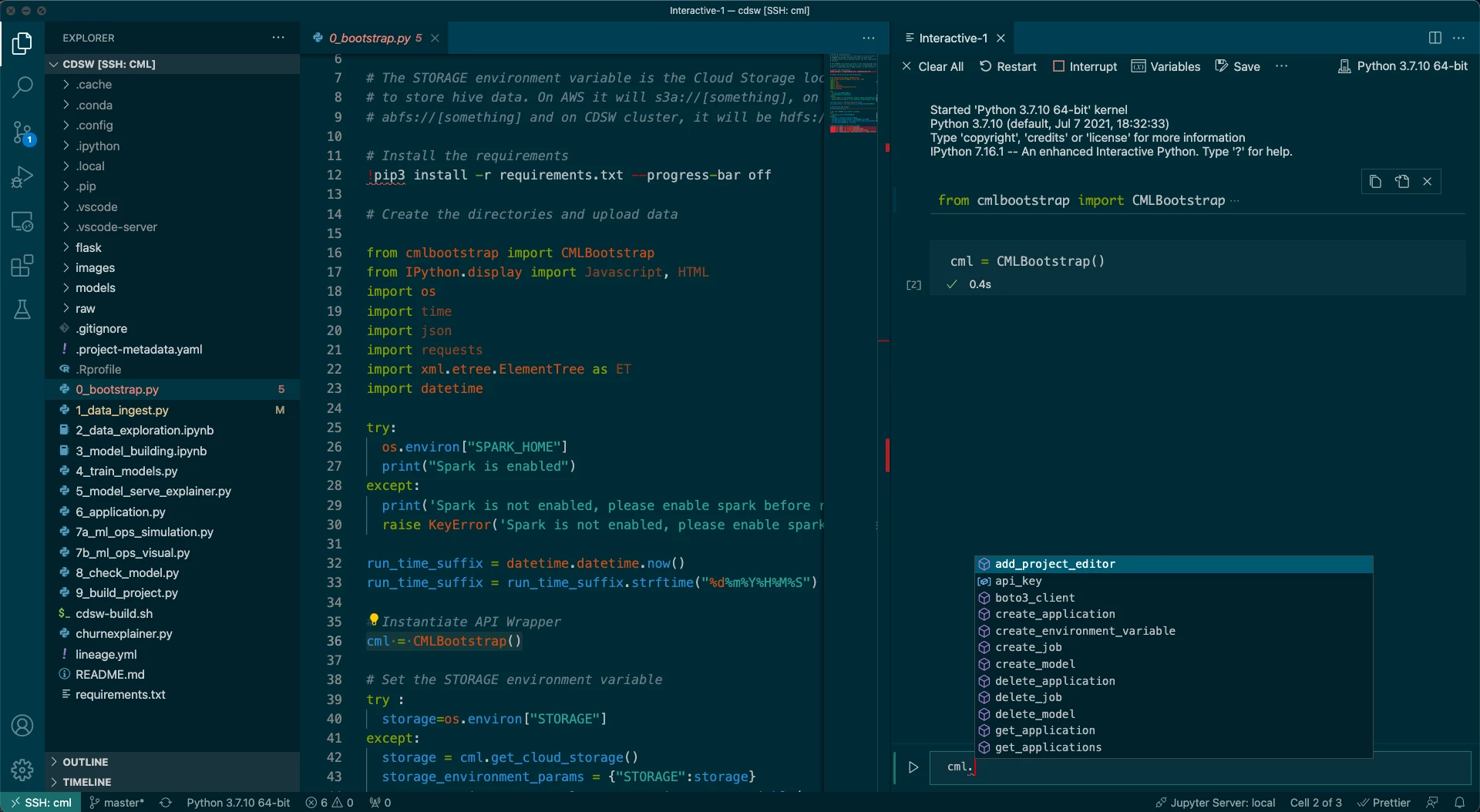

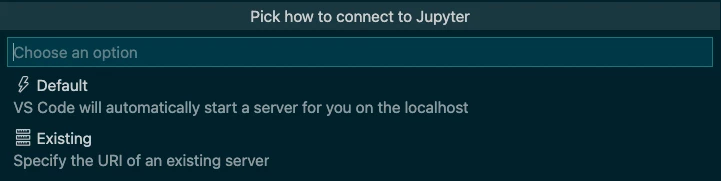

There is one last useful feature that I use a lot and that is the ability to run code selections in an interactive window. It's like a temporary Jupyter notebook and behaves more like the CML/CDSW workbench than a normal Jupyter notebook. To start the process, select some code and either hit Shift + Enter (that is on a Mac, but I think it's the same for Windows/Linux), or right-click and select - Run Selection / Line in Interactive Window.
This will start the temporary Jupyter session. The first time you do this or open a Jupyter Notebook for the first time, you will be prompted for the Jupyter connection method. Use the Default.
From there you will have access to a Jupyter like session and that you can interact with from a normal Python file.
