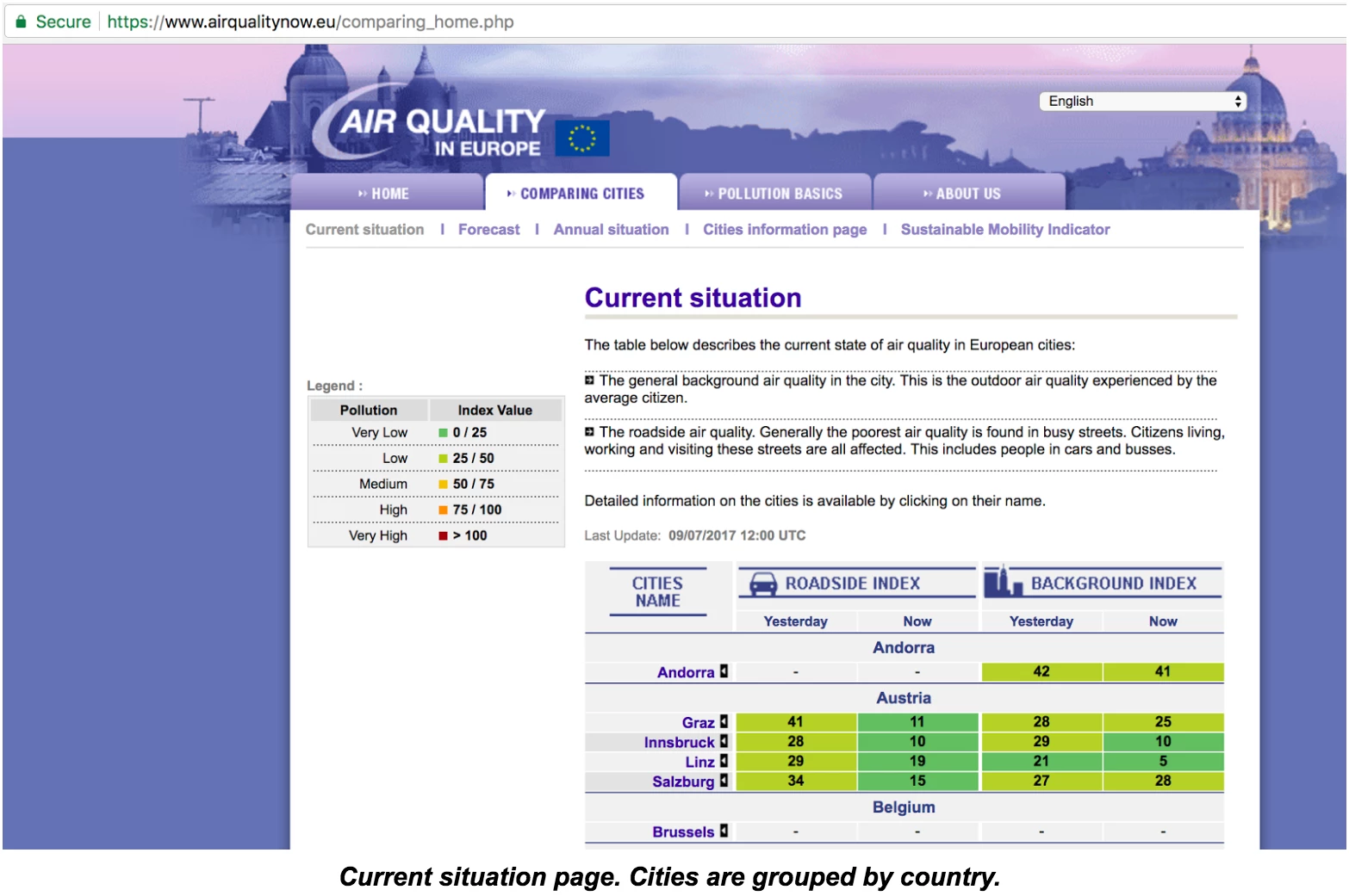

Collecting Air Quality of main European cities

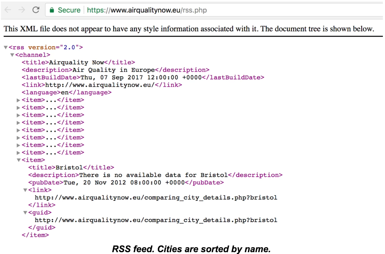

In this tutorial I’ll show you how to extract air quality data from the “Air Quality in Europe” web site. Unfortunately there is not a REST API available to easily pull that data out, and data has to be extracted directly from the “Current situation” page or RSS feeds:
Both resources are valid to extract the data we need, though I’ll use the first one as it gives us the information grouped by country, which will make processing easier afterwards. The “Current situation” page is going to be parsed and processed once an hour and, as a result, there will be a JSON document per city with the following schema:

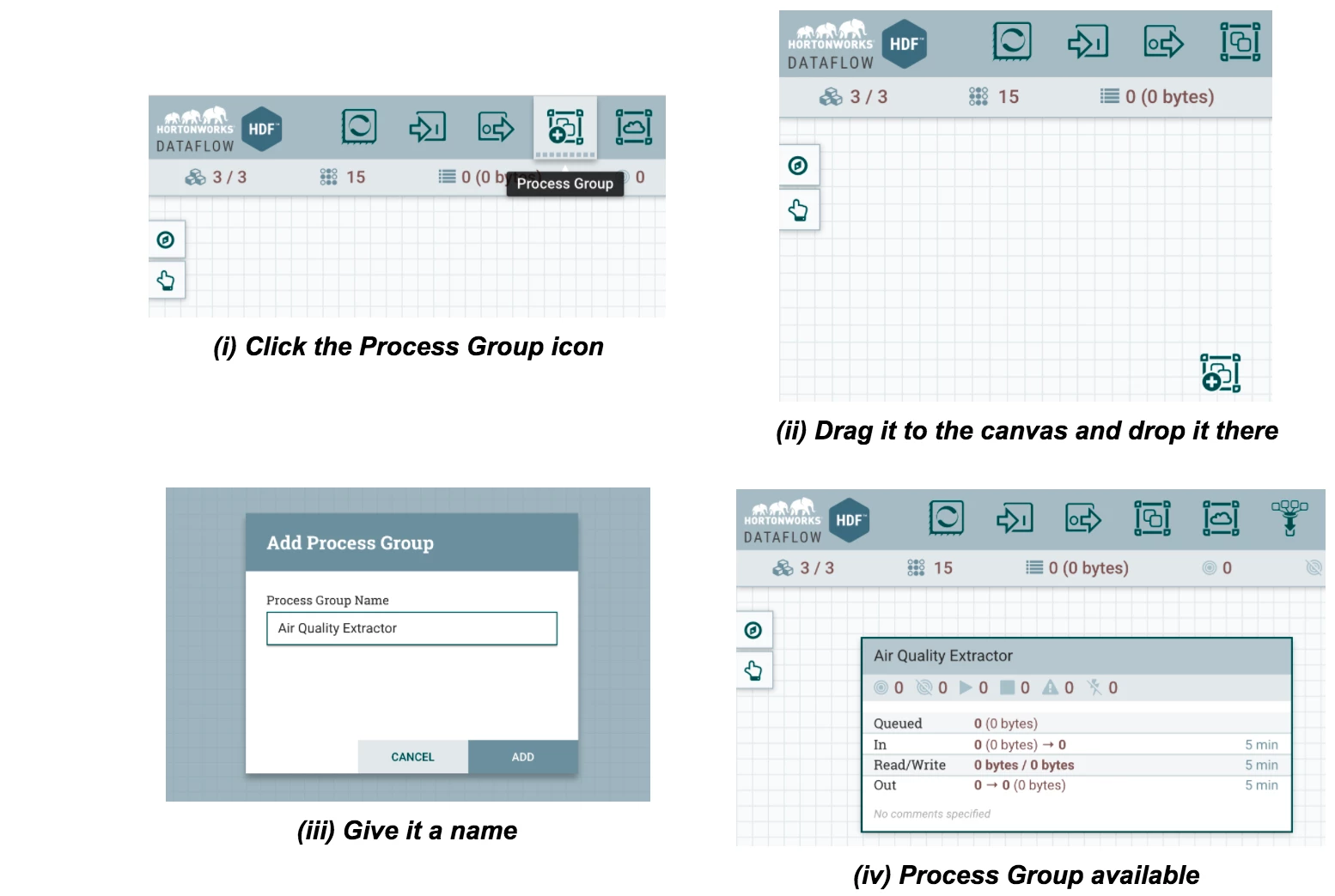

  • Step 1.- Create the Process Group using the NiFi Web UI. These screenshots outline the steps involved:

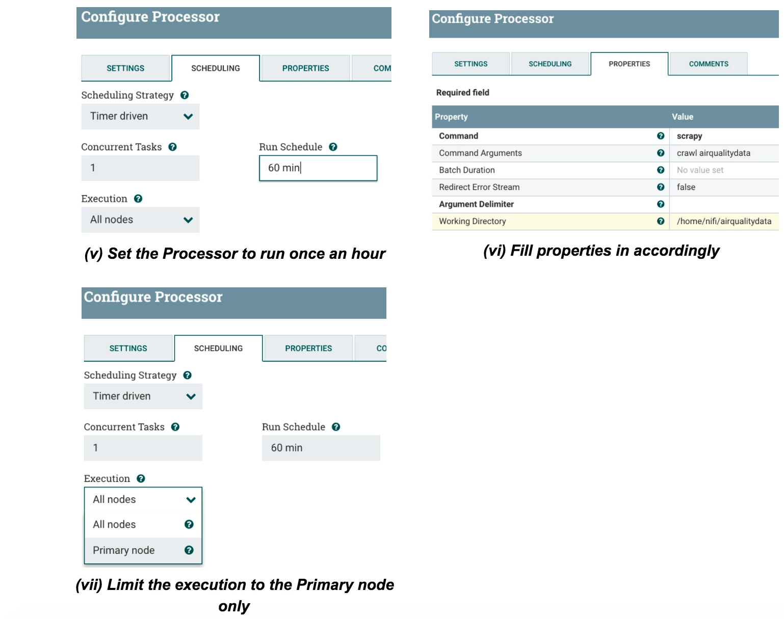

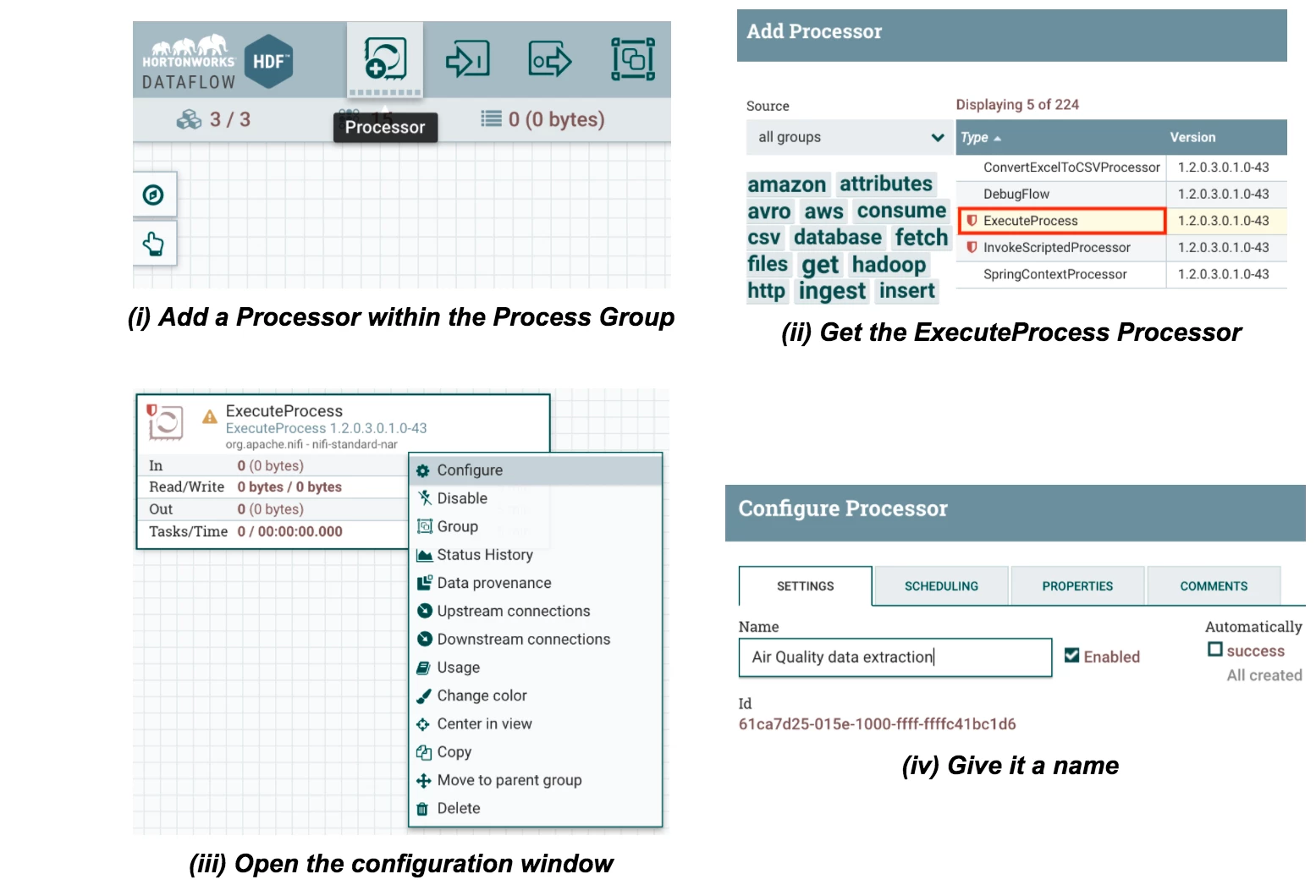

  • Step 2.- Double click the Process Group and add an ExecuteProcess processor to invoke the airqualitydata Scrapy spider. Look into the screenshots to understand the process.

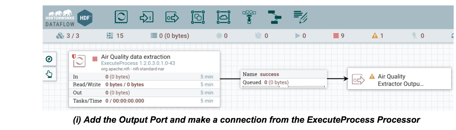

  • Step 3.- Provide the Process Group with an Output Port and connect it to the ExecuteProcess Processor. This will allow other Process Groups or Processors to get extracted data from the Air Quality site:
    Note that this is a very simple Process Group, but in a real case scenario we could be interested in registering a schema in the Schema Registry component within the Process Group.

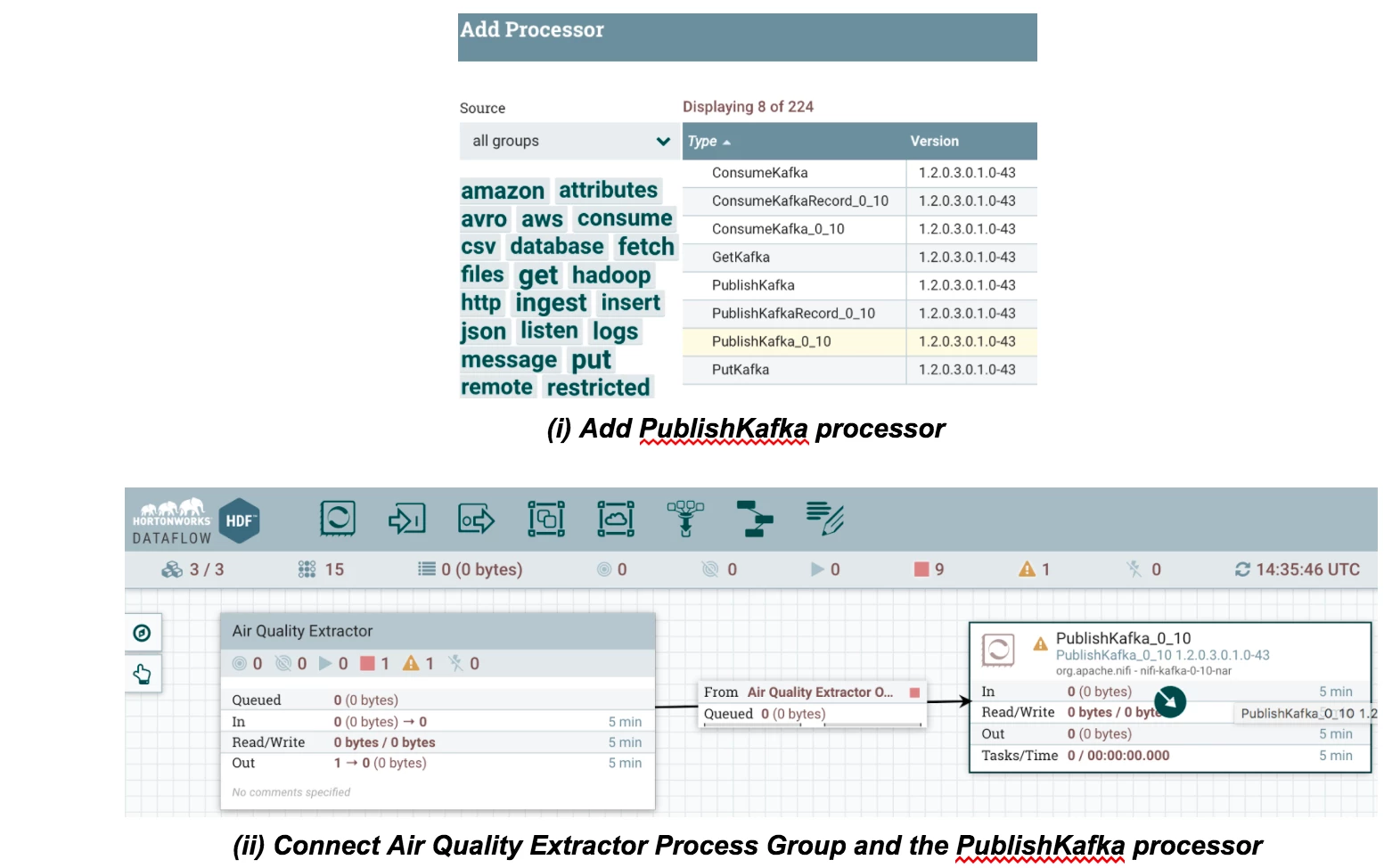

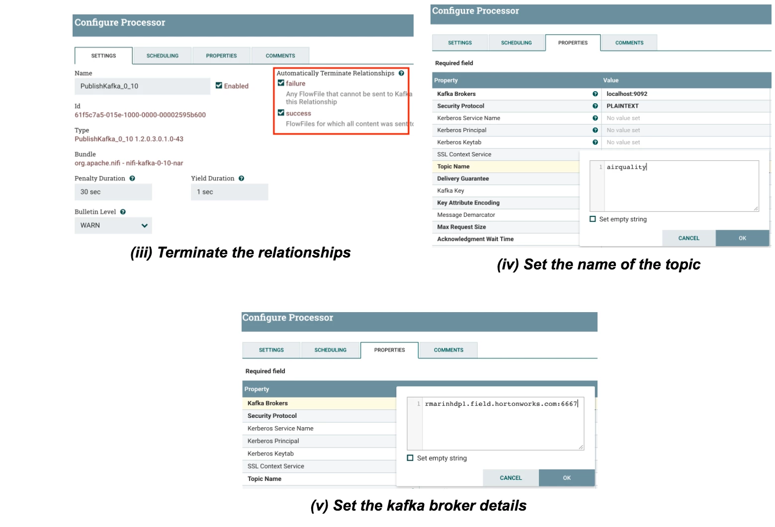

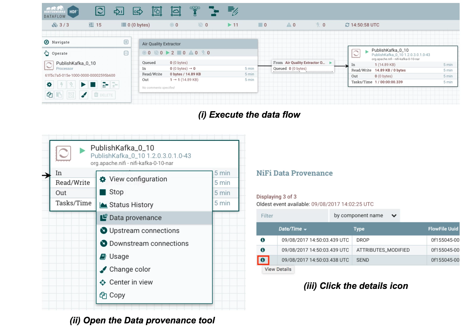

  • Step 4.- Exit from the Process Group, add a PublishKafka processor and connect both items to complete our example:

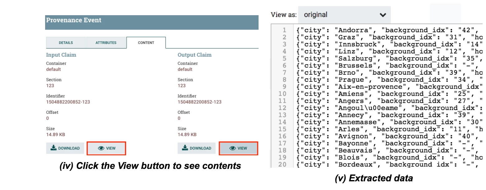

  • Step 5.- Execute the created data flow and check that data is extracted from the website and finally published in to the Kafka topic:
