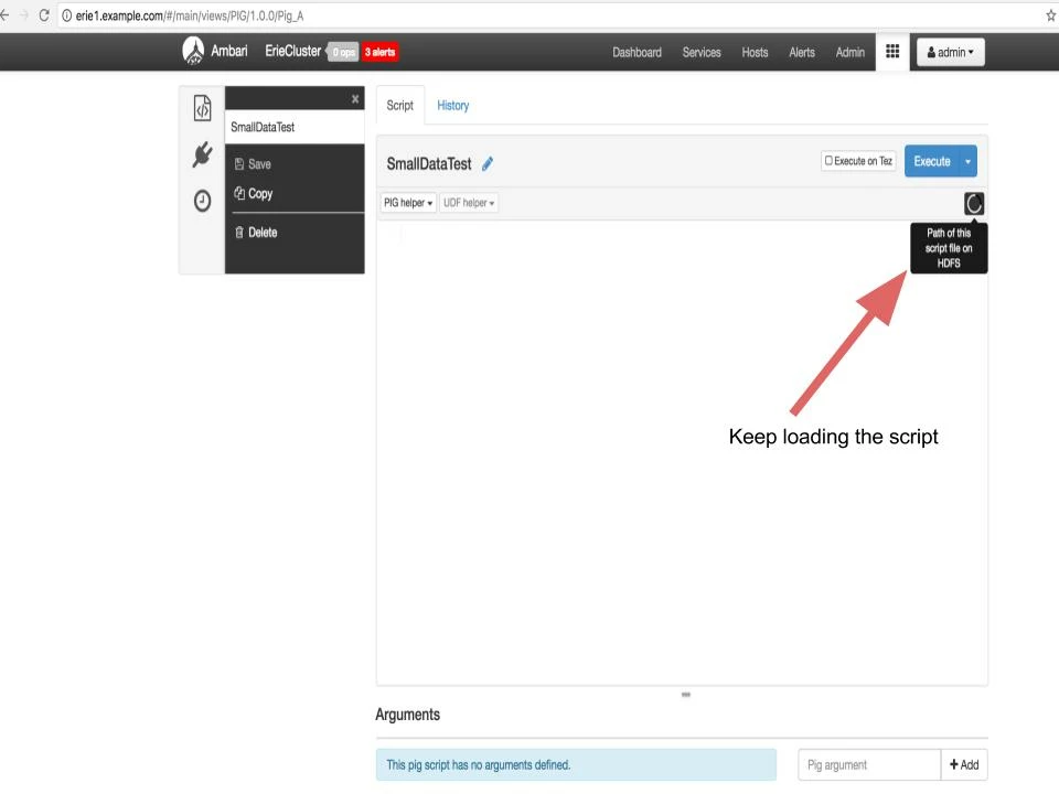

However when we try to access the PigView then we will see that the PigView is not able to load the scripts:
Also we will see that in the debugger tool that the script URL is not accessible (404 http response)
http://erie1.example.com/api/v1/views/PIG/versions/1.0.0/instances/Pig_A/resources/file/%2Fuser%2Fadmin%2Fpig%2Fscripts%2Fsmalldatatest-2016-11-25_09-26.pig
Above is the URL using which PigView tries to read the script that is stored in the HDFS. Even when we open this URL in the browser we get the same 404 error. However we see that the file is present in the HDFS with proper read write permission.
