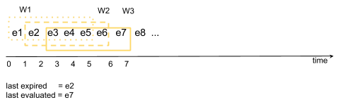

Sliding Window
In a sliding window tuples are grouped in windows and window slides every sliding interval. For example, a time duration based sliding window of length 10 secs and sliding interval of 5 seconds is evaluated every 5 seconds.
Here the first window (w1) contains the events that arrived up to the 10th second and the second window (w2) contains the events that arrived between 5th and 15th second. Also note that events e3 - e6 are part of both windows. When window w2 is evaluated at time t = 15 secs, the events e1 and e2 are expired (dropped out of the event queue).

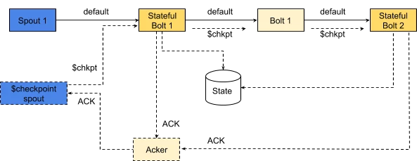

Checkpoint mechanism
Checkpoint is triggered by an internal checkpoint spout at the specified topology.state.checkpoint.interval.ms. If there is at least one IStatefulBolt in the topology, the checkpoint spout is automatically added by the topology builder . For stateful topologies, the topology builder wraps the IStatefulBolt in a StatefulBoltExecutor which handles the state commits on receiving the checkpoint tuples. The non stateful bolts are wrapped in a CheckpointTupleForwarder which just forwards the checkpoint tuples so that the checkpoint tuples can flow through the topology DAG. The checkpoint tuples flow through a separate internal stream namely $checkpoint. The topology builder wires the checkpoint stream across the whole topology with the checkpoint spout at the root.
At checkpoint intervals the checkpoint tuples are emitted by the checkpoint spout. On receiving a checkpoint tuple, the state of the bolt is saved and then the checkpoint tuple is forwarded to the next component. Each bolt waits for the checkpoint to arrive on all its input streams before it saves its state so that the state represents a consistent state across the topology. Once the checkpoint spout receives ACK from all the bolts, the state commit is complete and the transaction is recorded as committed by the checkpoint spout.
The checkpoint mechanism builds on top of storm's existing acking mechanism to replay the tuples and uses concepts from the asynchronous snapshot algorithm used by flink and the Chandy-Lamport algorithm for distributed snapshots.The checkpointing internally uses a three phase commit protocol with a prepare and commit phase so that the state across the topology is saved in a consistent and atomic manner.
