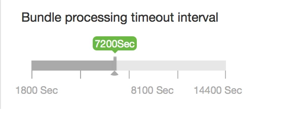

In SmartSense 1.3.0 this will no longer be an issue. Until then, this is a way to avoid capture time outs. Firstly, lets discuss the difference between capture for analysis and support case resolution. Analysis bundles do not collect service logs. For support cases, you're going to fetch configuration and logs. Then based on how much anonymization you will want to apply, large log files will take a long time to collect. This is especially prominent with HDFS namenode logs. They tend to be big and this is exactly the scenario we're trying to address. Firstly, increase the threshold for agent time out in Ambari. In my case it was 30min. Feel free to raise it up to 2hrs on the Ambari SmartSense Operations page.

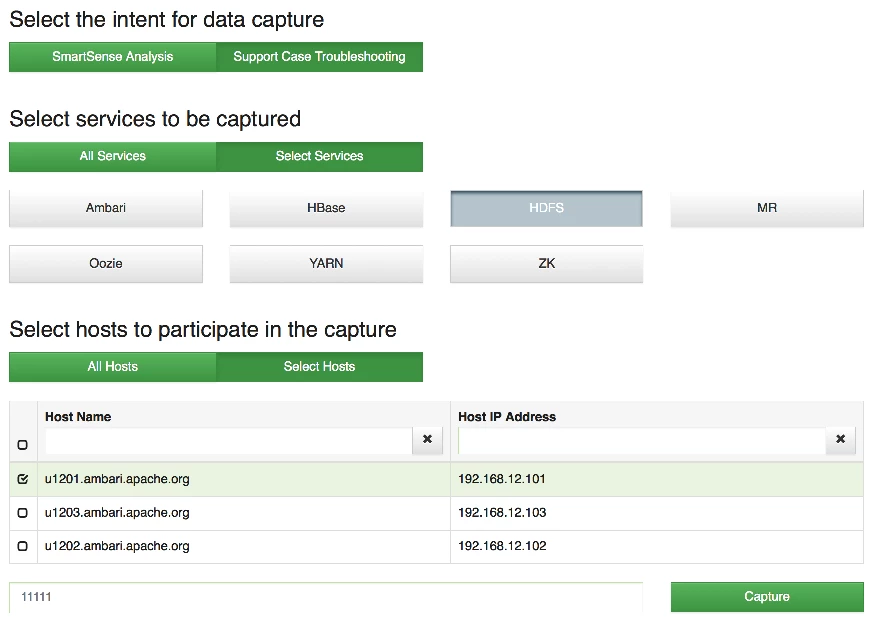

Finally, let's verify this approach. Go to SmartSense view and initiate a capture.

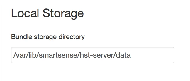

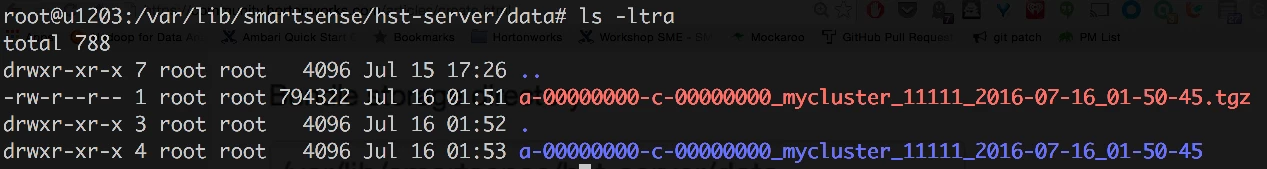

At this point, when capture is complete, go to the SmartSense server node and navigate to the local storage directory.

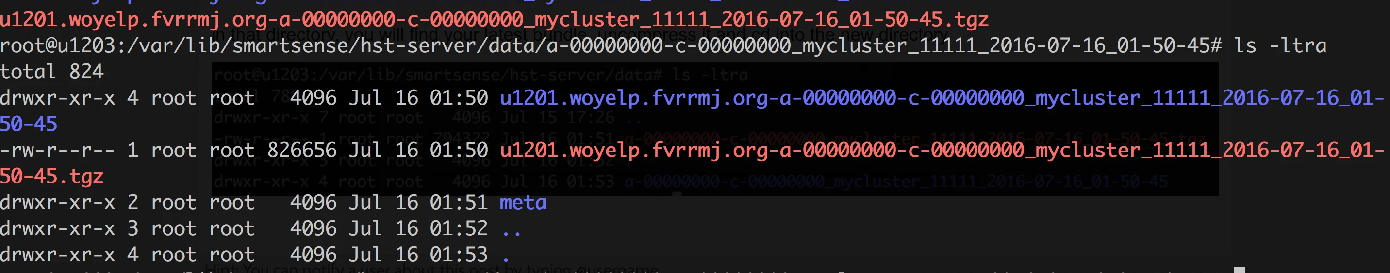

in that directory, you will find your latest bundle, uncompress it and cd into the new directory
In that directory, there will be another compressed file, uncompress that as well.

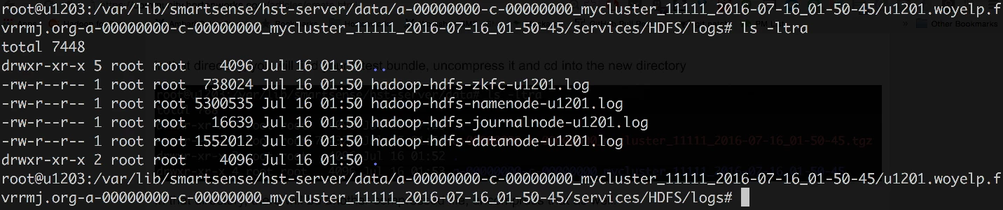

Finally CD into that directory and then into services directory. At this point you will see various services. We care about HDFS. Go inside it and finally into logs directory.
There you will find your *.logs
