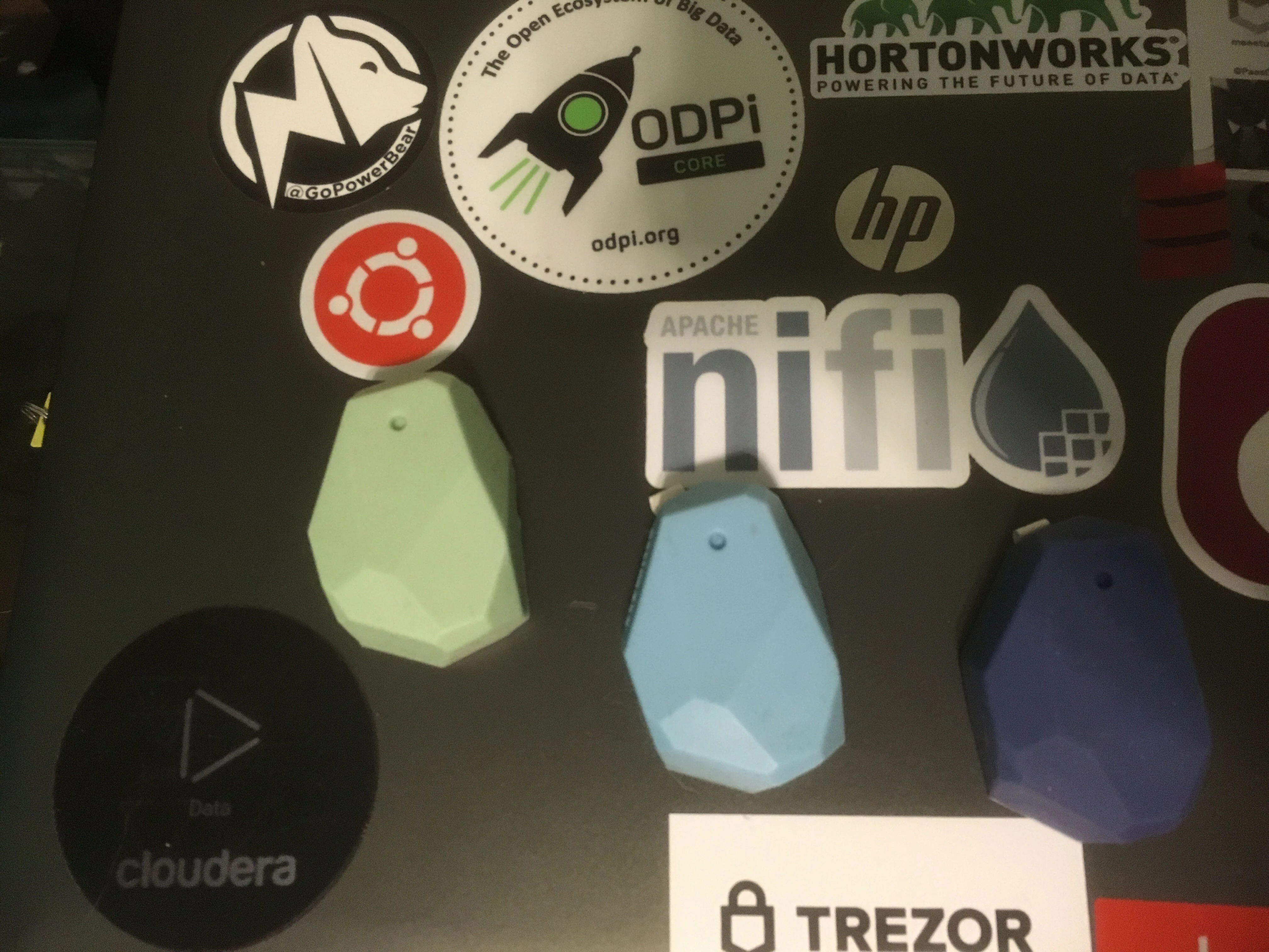

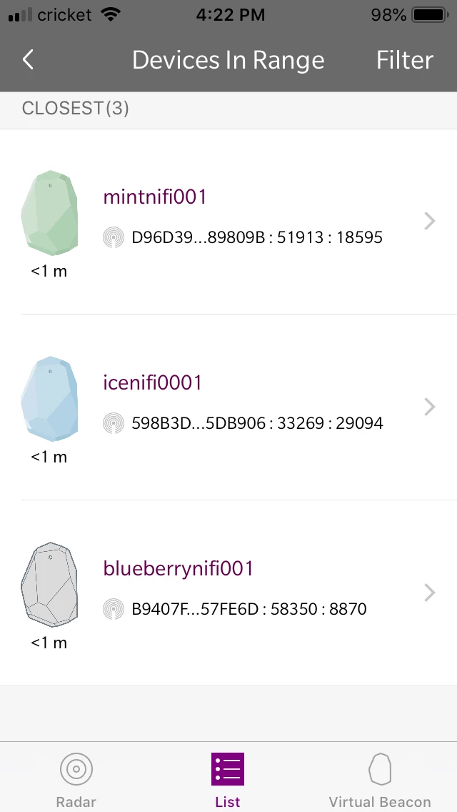

I have set up three Estimote Proximity beacons in an indoor environment broadcasting both Estimote and IBeacon messages.

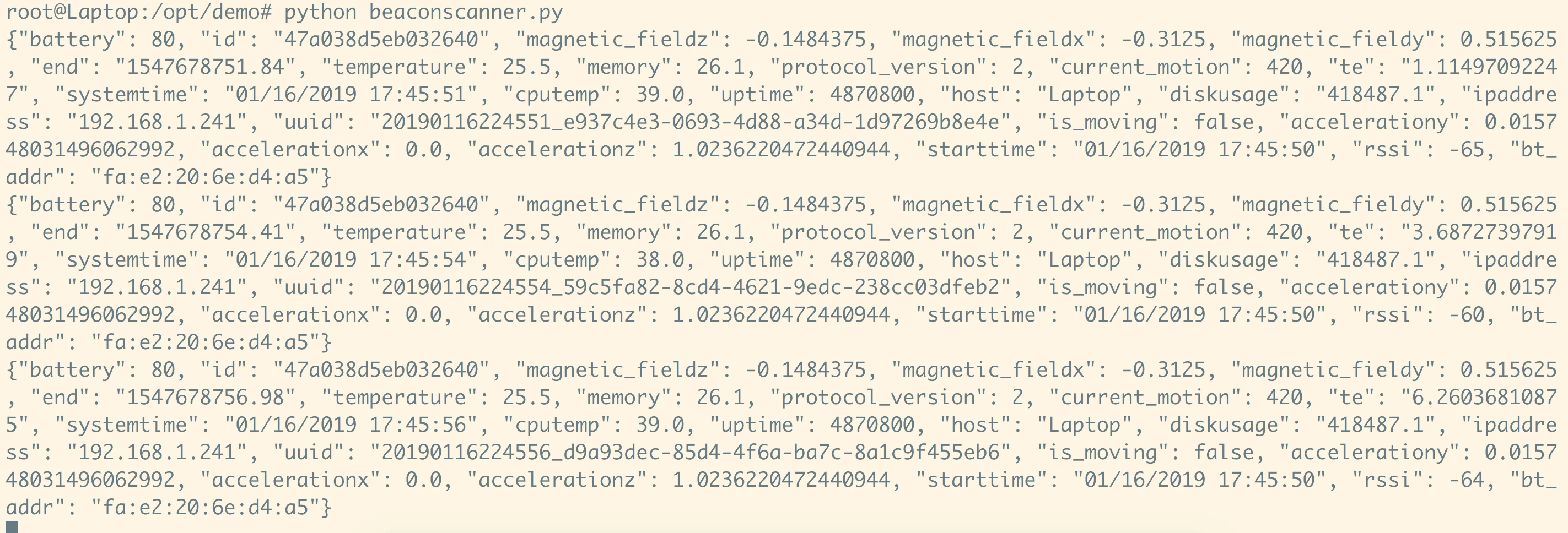

I tested the BLE library from the command line with a Python script:

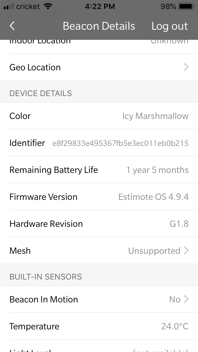

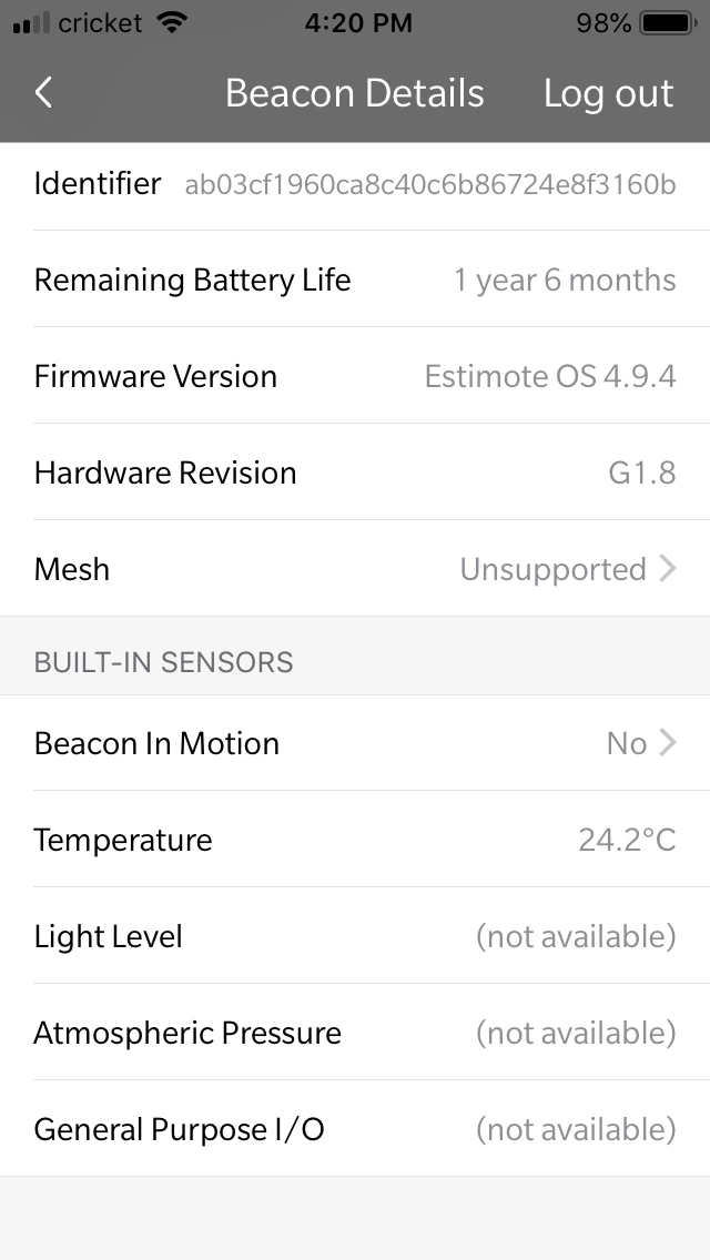

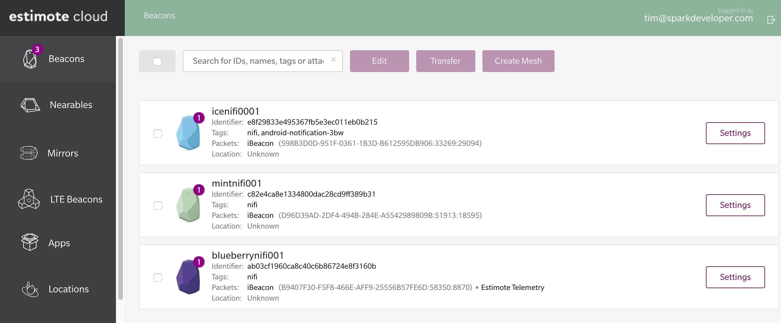

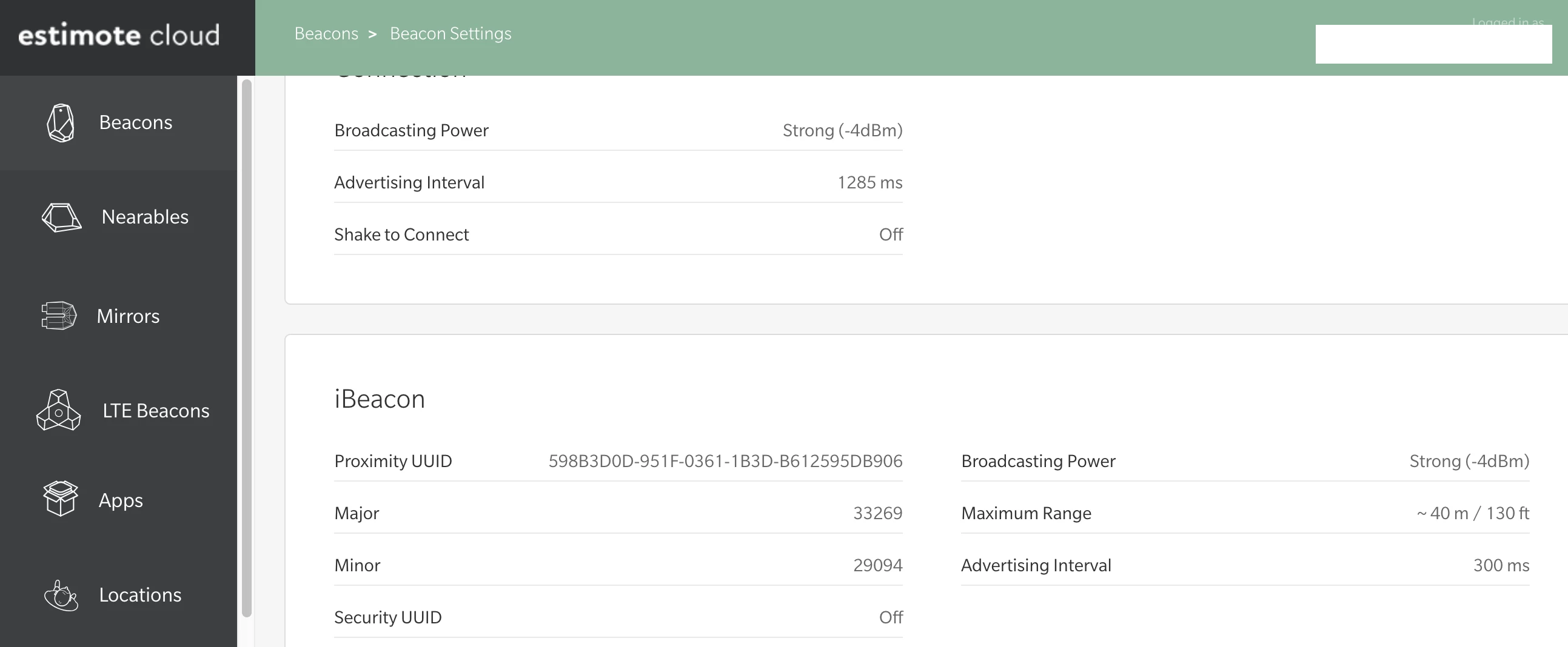

Since we are using our own IoT gateways and networks, I am only using the Estimote Cloud to check the beacons and make sure they are registered.

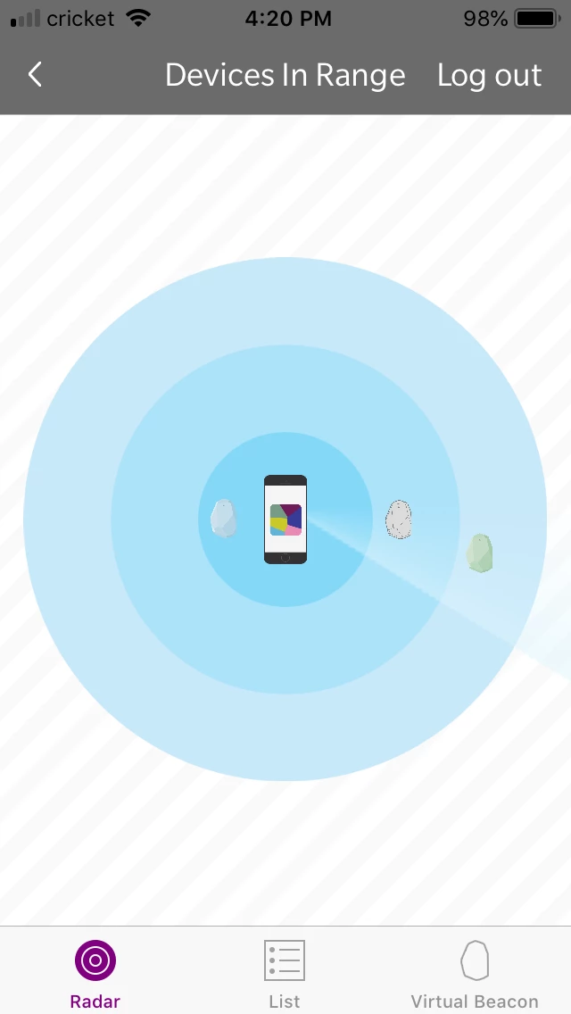

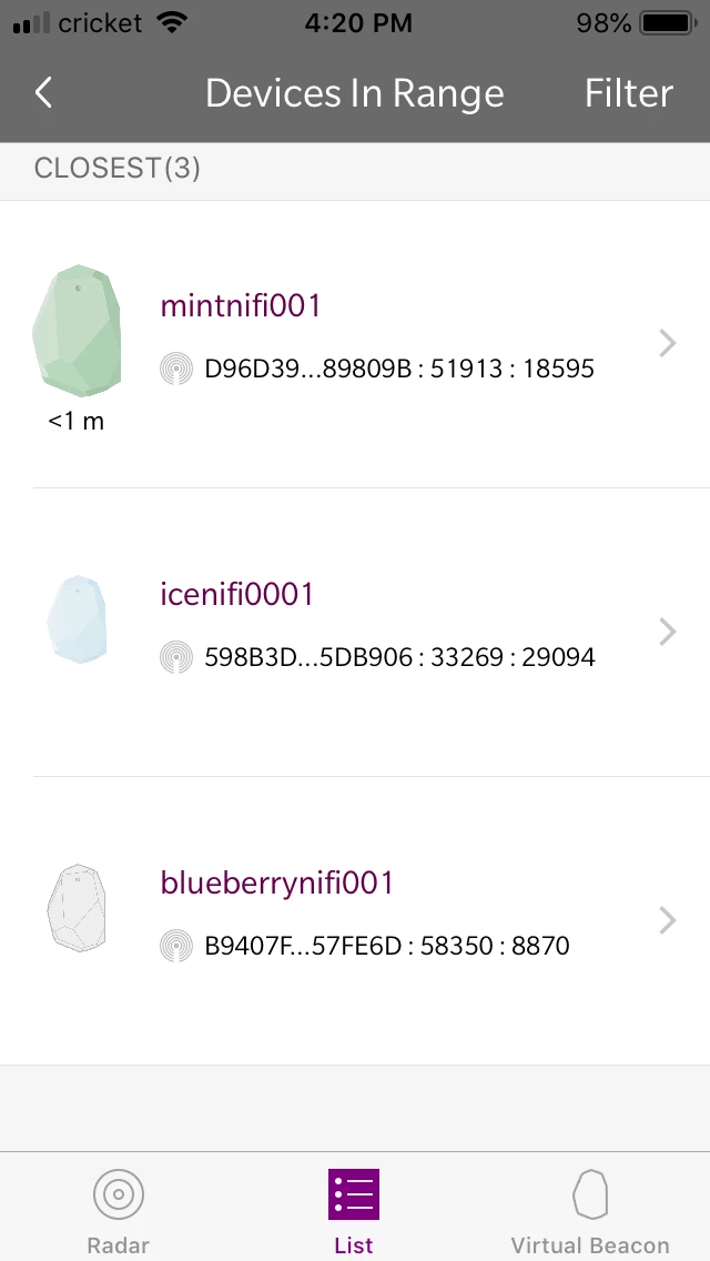

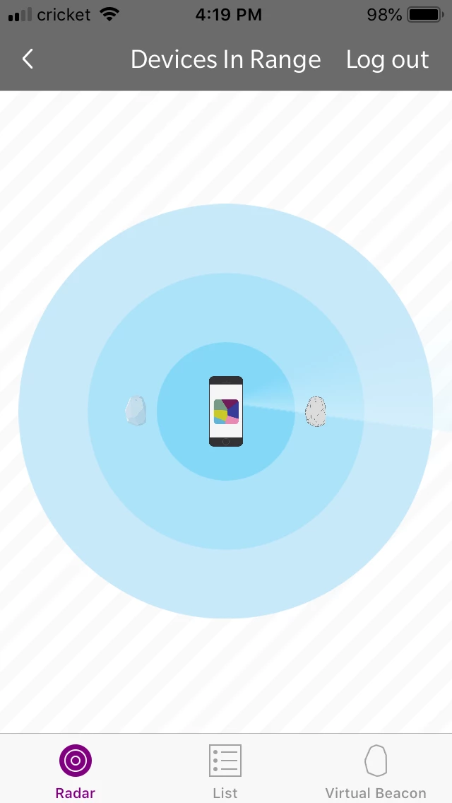

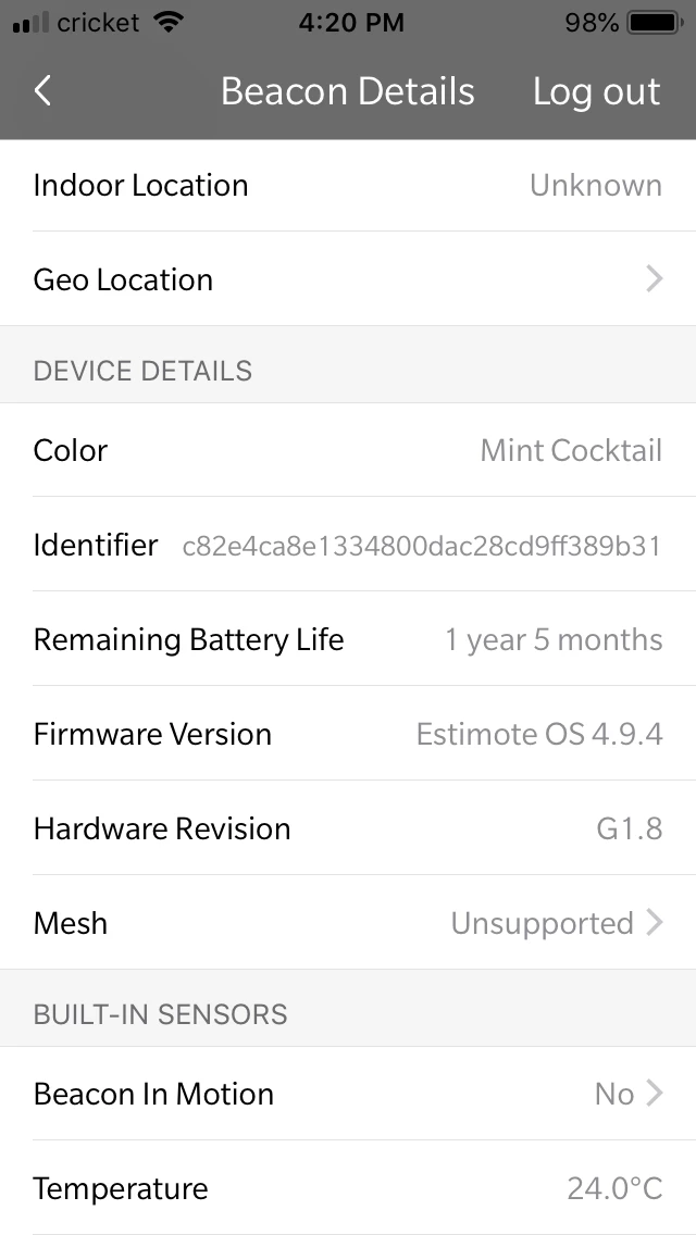

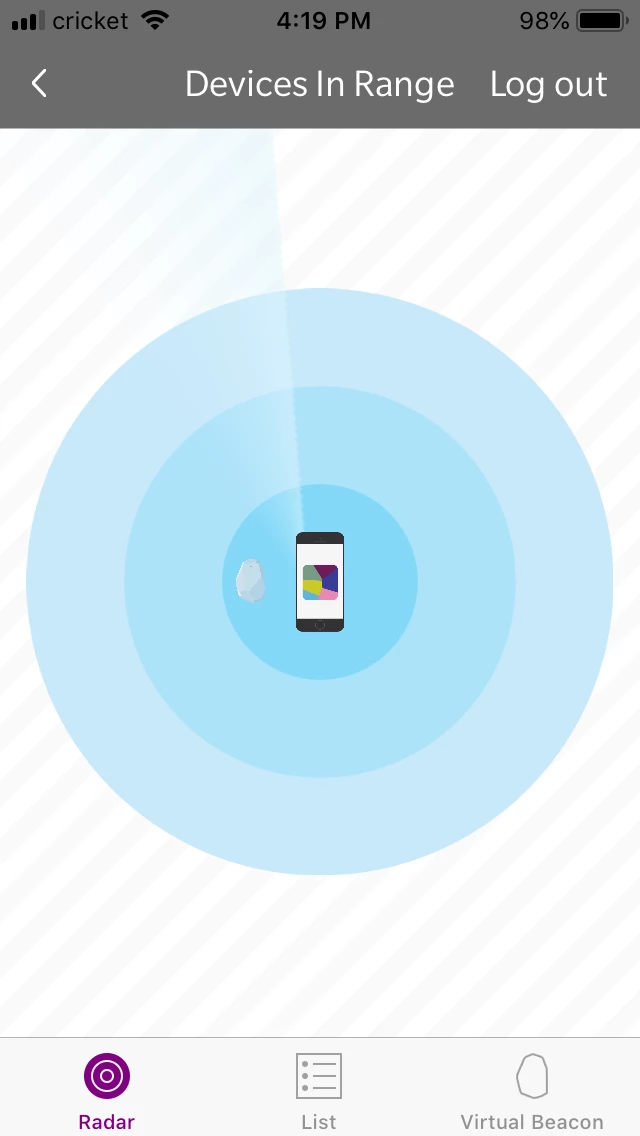

Estimote provides an IPhone Application (Estimote) that you can download and use to do some basic programming and range testing of the beacons.

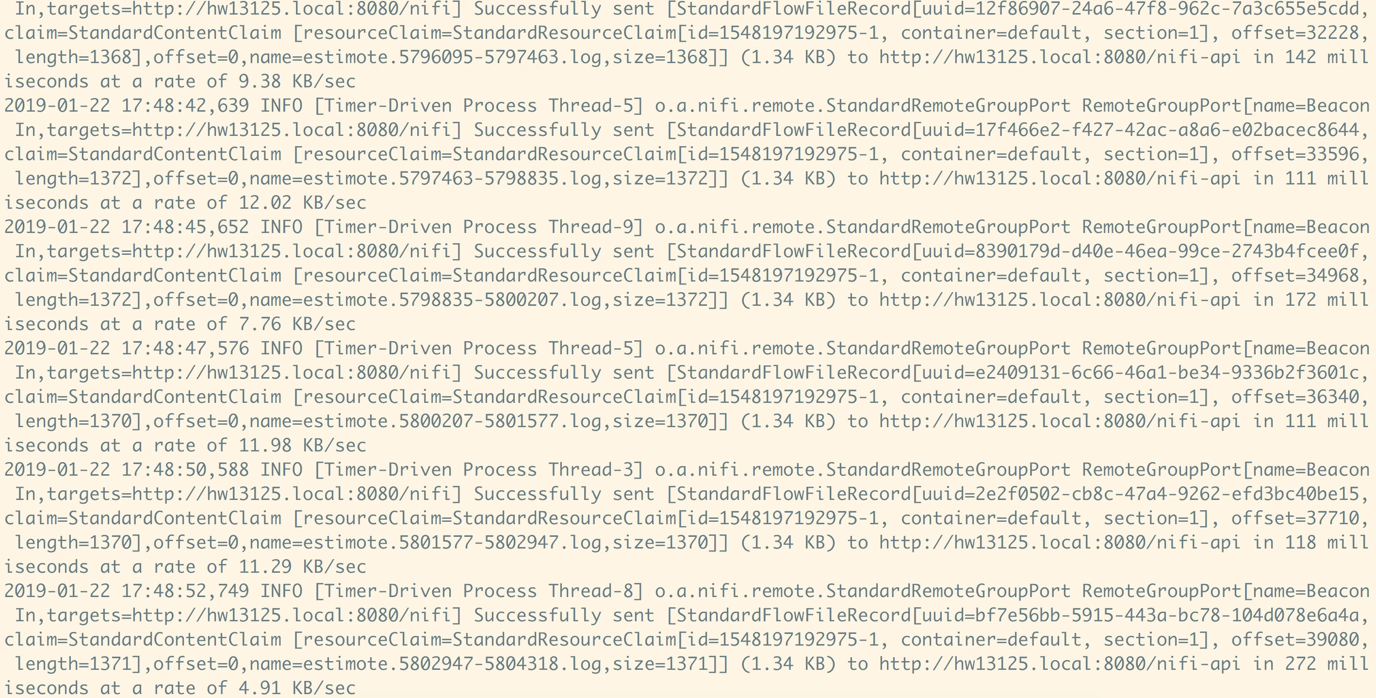

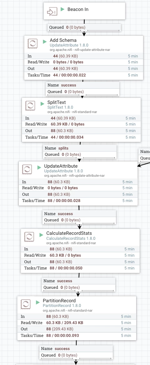

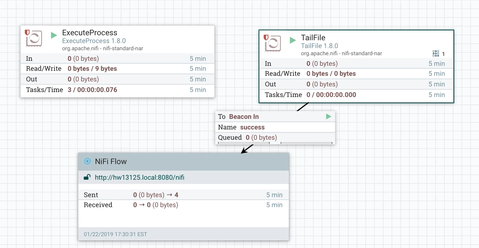

We run our shell script that has the Python BLE scanner run for 40 seconds and add JSON rows to a file. We then continuously tail that file and read new lines and send them to NiFi for processing.
As you can see MiniFi is sending a steady stream of data to an Apache NiFi instance via HTTP S2S API.
NiFi Setup:

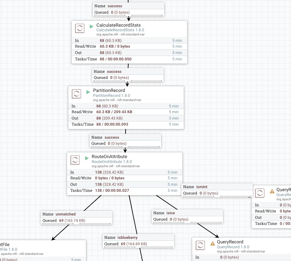

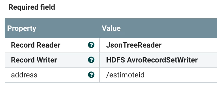

The flow is pretty simple. We add a schema name to it, split the text to get one JSON row per line. We calculate record stats, just to check. The main logic is the Partition Record to help us partition records into different categories based on their Estimote Beacon IDs. We then route based on those partitions. We can do different filtering and handling after that if we need to.

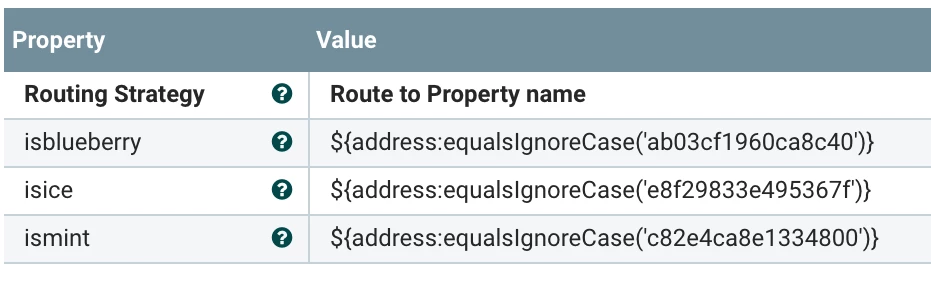

We partition our JSON records into AVRO records and pull out the estimote id as a new attribute to use for routing.
In the Route we look at the partition key which is an address for the device.

{"battery": 80, "id": "47a038d5eb032640", "magnetic_fieldz": -0.1484375, "magnetic_fieldx": -0.3125, "magnetic_fieldy": 0.515625, "end": "1548194024.99", "temperature": 25.5, "cputemp1": 45.0, "memory": 42.6, "protocol_version": 2, "current_motion": 420, "te": "39.767373085", "systemtime": "01/22/2019 16:53:44", "cputemp": 43.0, "uptime": 4870800, "host": "Laptop", "diskusage": "418124.2", "ipaddress": "192.168.1.241", "uuid": "20190122215344_2a41168e-31da-4ae7-bf62-0b300c69cd5b", "is_moving": false, "accelerationy": 0.015748031496062992, "accelerationx": 0.0, "accelerationz": 1.0236220472440944, "starttime": "01/22/2019 16:53:05", "rssi": -63, "bt_addr": "fa:e2:20:6e:d4:a5"}
