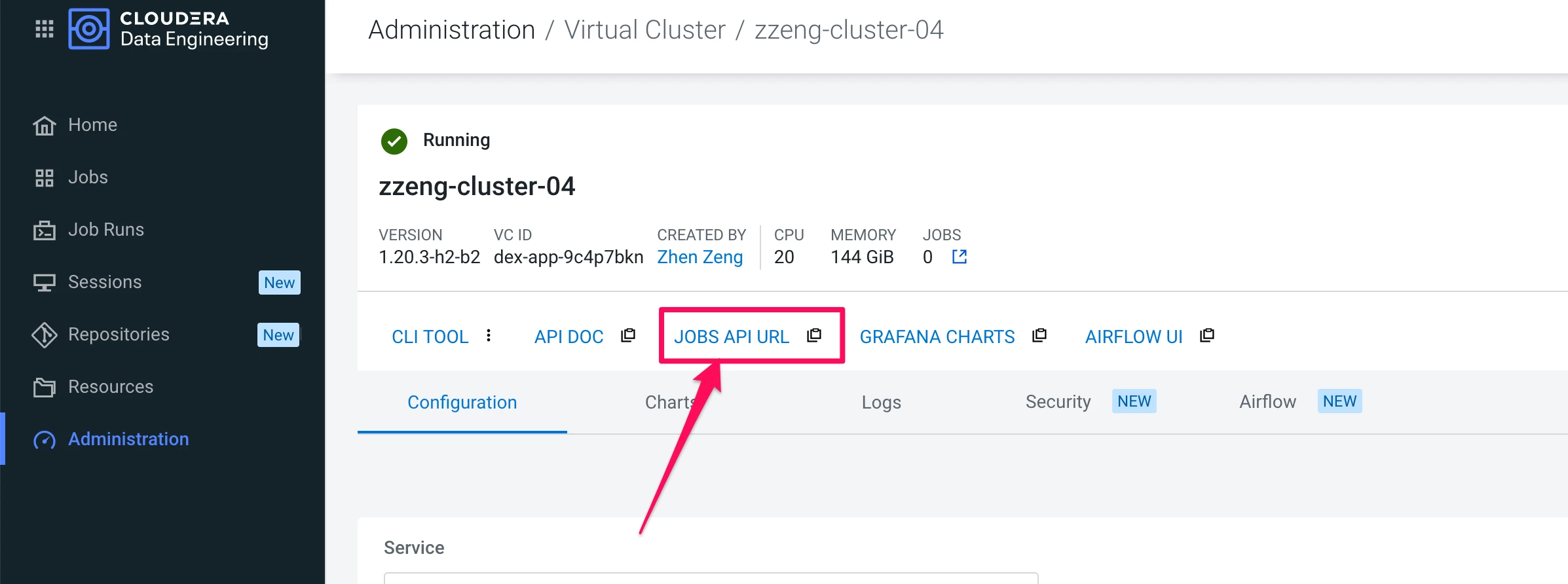

Share my memo on setting up the .cde/config.yaml:
user:(my user in CDP, not the email address)
vcluster-endpoint: (find it in the Adminitration -> Virtual Cluster details -> JOBS API URL)
