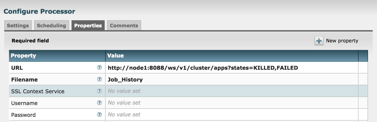

1. Assuming you have NiFi UI Available, lets drop GetHTTP processor to pull data from YARN REST API:
Configure Processor with URL given as below, which pulls all Applications in Killed and Failed state. node1 is my Resource Manager:
http://node1:8088/ws/v1/cluster/apps?states=KILLED,FAILED
Lets schedule the processor to run only every 10sec so that you don’t query too often.

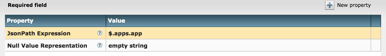

2. As the Rest call outputs the application details in Json format, lets use a SplitJson processor to separate individualapplication details.
Provide “JsonPath Expression” value as “$.apps.app” in the configuration.
3. Connect GetHTTP to SplitJson for success relation and auto terminate rest.

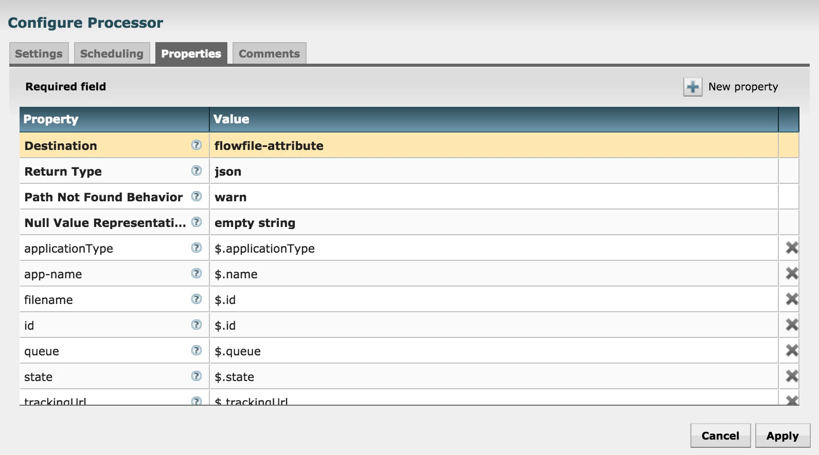

4. Lets add EvaluateJsonPath processor to extract required fields and add them to flow-file attribute: Configure it as below:
5. Connect SplitJson to EvaluateJsonPath for success relation.

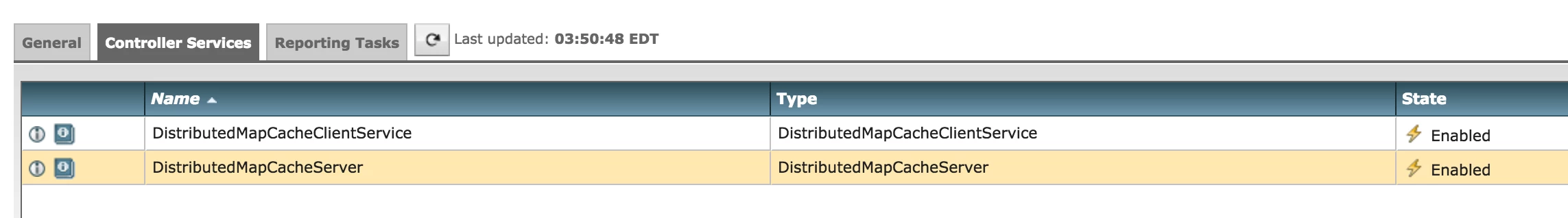

6. Create and start two controller services: DistributedMapCacheClientService, DistributedMapCacheServer so that we keep track of all the applications and don’t sent out duplicate alerts for same application.

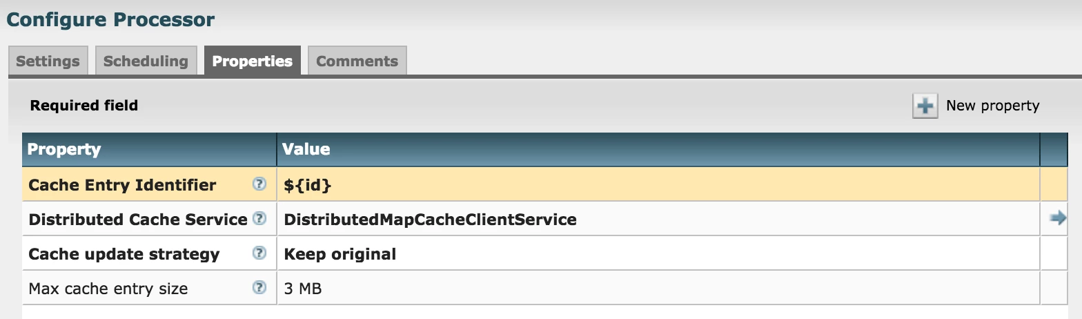

7. Add a PutDistributedMapCache processor to update the cache with latest apps that fails/killed. Configure it as below adding Distributed cache service.

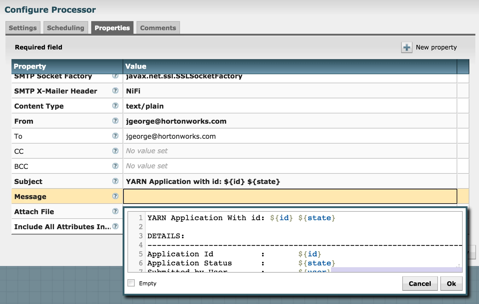

9. Make sure you have formatted the email body and subject to have all information about the failed job:

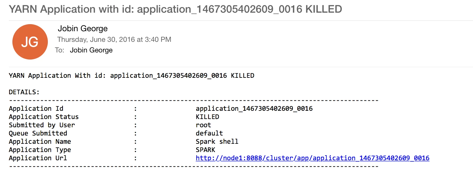

10. Auto terminate success and failure relationship for PutEmail processor. Once you start the Flow, you will get alerts for each Killed/Failed Yarn application. My Alert would look like below:
