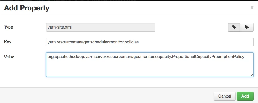

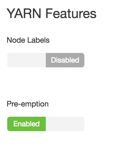

The following parameters were added to yarn-site.xml, which can be done thru Ambari -> Yarn -> Config. You can turn preemption on in the Settings tab. This will set yarn.resourcemanager.scheduler.monitor.enable=true.
The remaining properties need to be added in the Advanced config tab in Ambari under “Custom yarn-site”. Click “Add Property”. Then add the following properties:
yarn.resourcemanager.scheduler.monitor.policies=org.apache.hadoop.yarn.server.resourcemanager.monitor.capacity.ProportionalCapacityPreemptionPolicy
yarn.resourcemanager.monitor.capacity.preemption.monitoring_interval=3000
yarn.resourcemanager.monitor.capacity.preemption.max_wait_before_kill=15000
yarn.resourcemanager.monitor.capacity.preemption.total_preemption_per_round=0.1

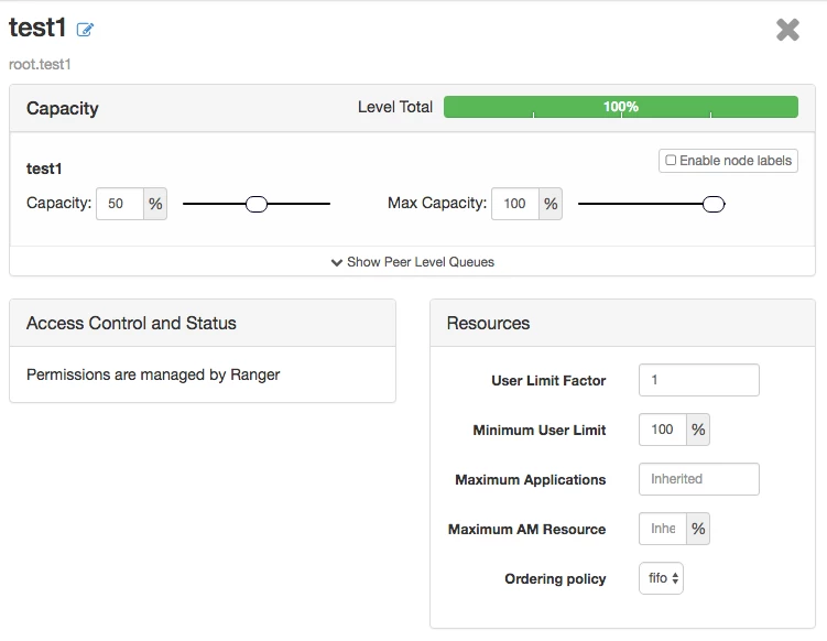

Using the YARN Queue Manager in Ambari, you can also apply the following settings to the capacity-scheduler.xml using the GUI.

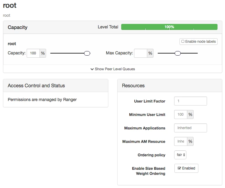

Set up the YARN queues as follows. Both the test1 and test2 queues should look exactly the same and rollup to the root queue.
The test1 and test2 queues should have the same configuration as below:
The root queue should have an Ordering Policy of Fair and Enable Sized Based Weight Ordering.
Restart YARN

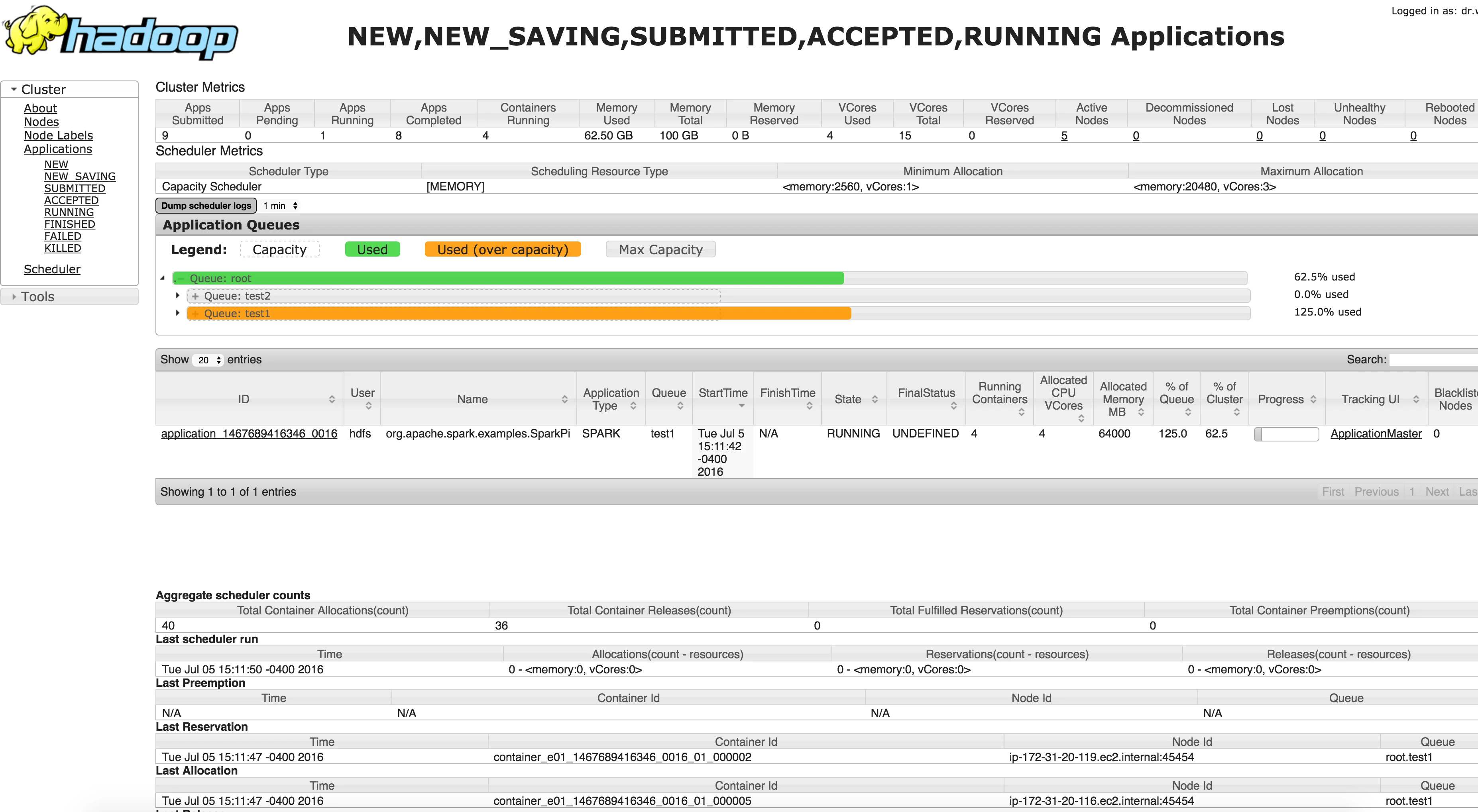

Run the following Spark job and make sure it runs over-capacity on the test1 queue. Notice how we specify 5 executors and large containers.
./bin/spark-submit --class org.apache.spark.examples.SparkPi --master yarn --deploy-mode cluster --queue test1 --num-executors 5 --executor-memory 18G --executor-cores 2 lib/spark-examples*.jar 1000000
Confirm in the Resource Manager UI (http://resource-manager-node:8088/cluster) that it’s running over-capacity in test1 queue

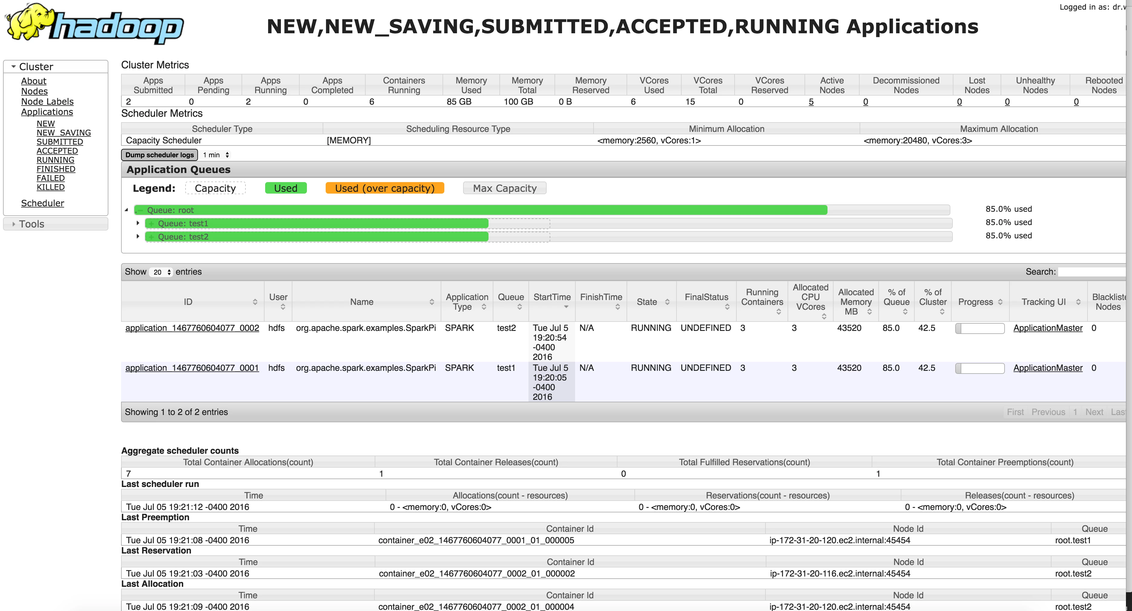

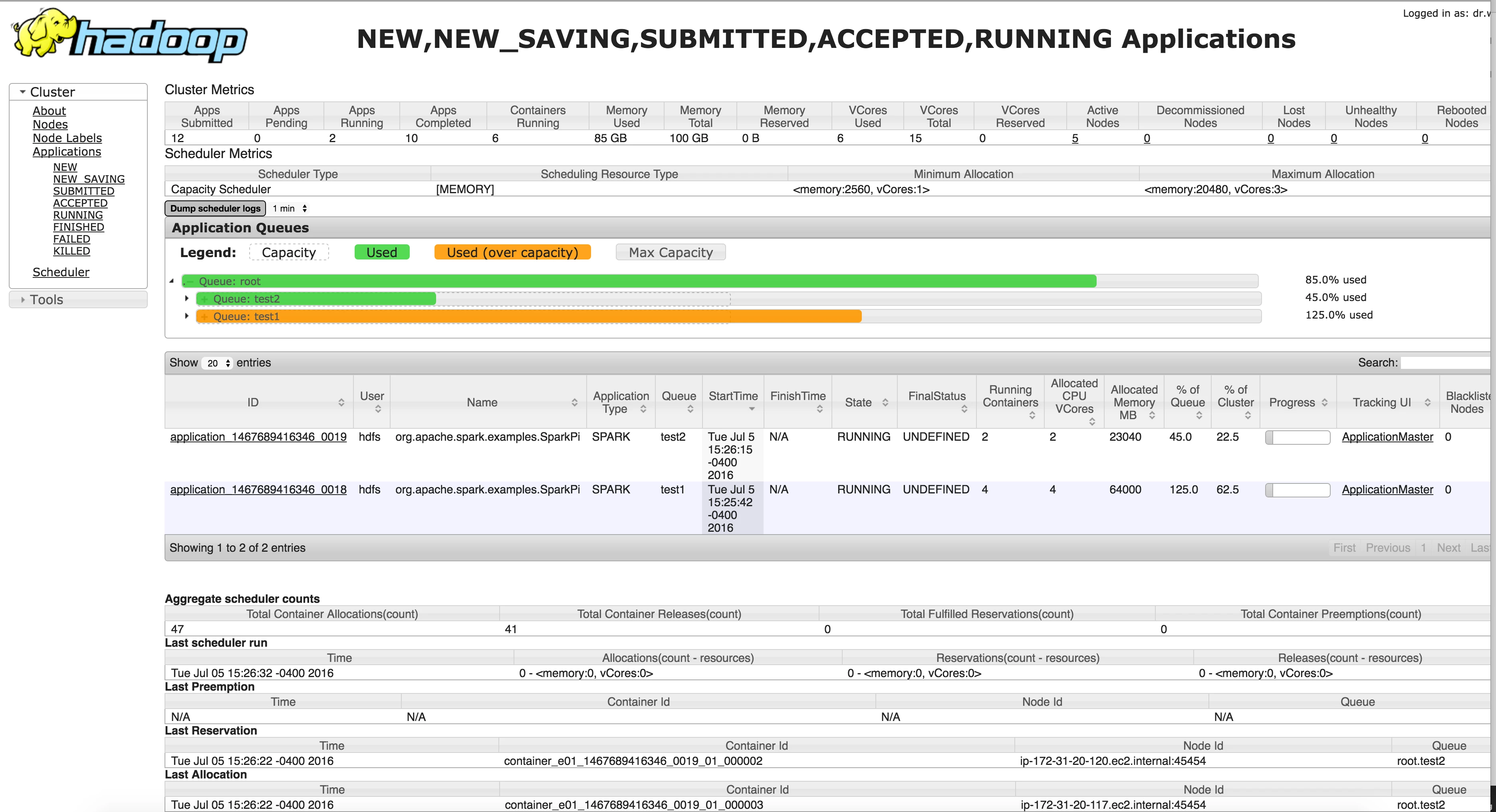

Run a second Spark job on test2 queue. Notice how this job does not specify the number of executors. That's because we are using Dynamic Resource Allocation in Spark which became available in Spark 1.6.
./bin/spark-submit --class org.apache.spark.examples.SparkPi --master yarn --deploy-mode cluster --queue test2 --executor-memory 18G --executor-cores 2 lib/spark-examples*.jar 1000000
Initially you should see the following behavior in the resource manager:
And then…viola - In a few seconds, YARN will preempt and the 2nd Spark job will take some containers from the first job so that you have a fair balance of resources across a root queue.
