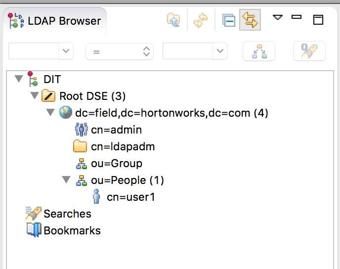

Our organizational structure is as follows:
With this structure, our search base will be restricted to dc=field,dc=hortonworks,dc=com and our user DN template will be cn={0},ou=People,dc=field,dc=hortonworks,dc=com as the People OU contains the users.

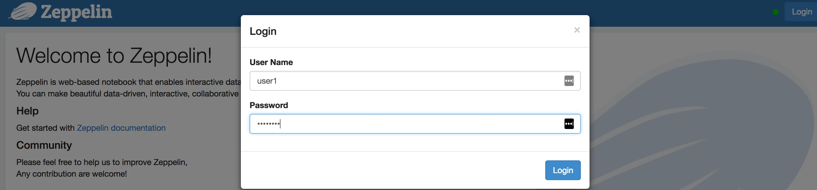

After these changes are saved, make sure to restart Zeppelin. Now, navigate to the Zeppelin UI. With authentication enabled, you should not see any notebooks accessible until a user logs in.
I'll now login using user1 (full DN is cn=user1,ou=People,dc=field,dc=hortonworks,dc=com, based on the userDnTemplate value above) and the password stored in OpenLDAP.

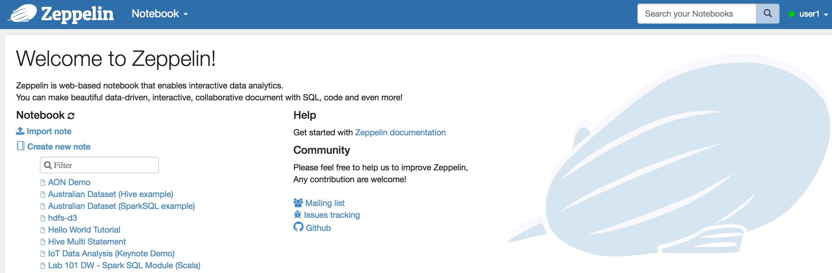

After authenticating, I can navigate to the notebooks to which user1 has access:

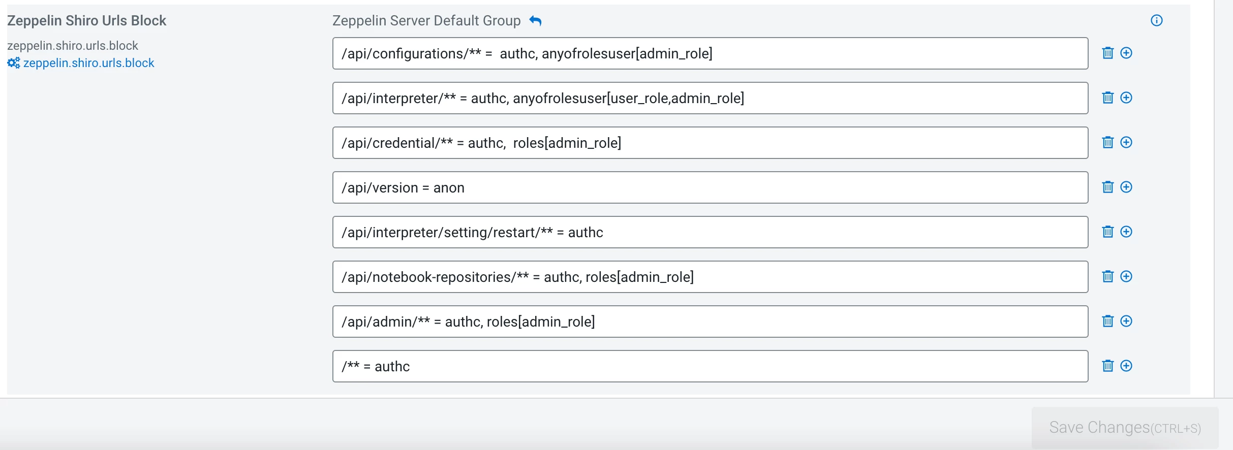

Hi all, Even I'm too facing an issue. I specifically want user_role not to access /api/configuration/**
I tried various ways, but in vain. Can someone help ?
