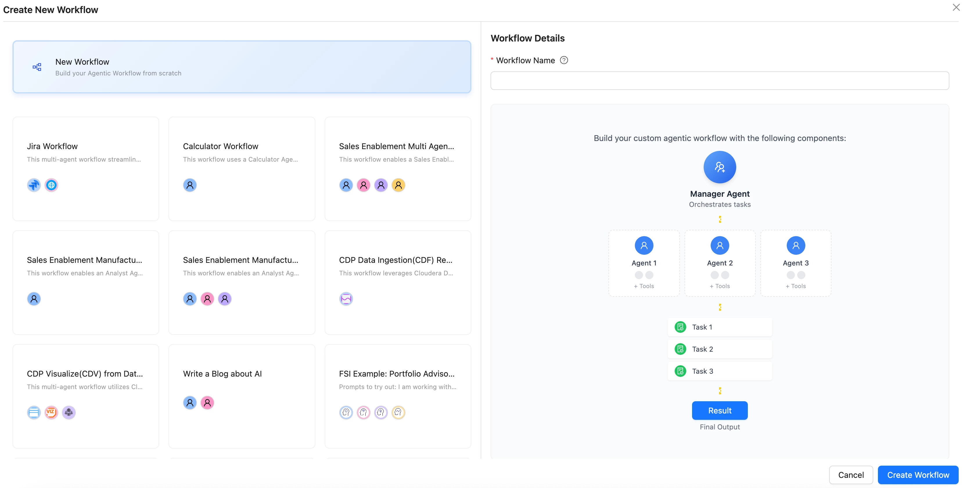

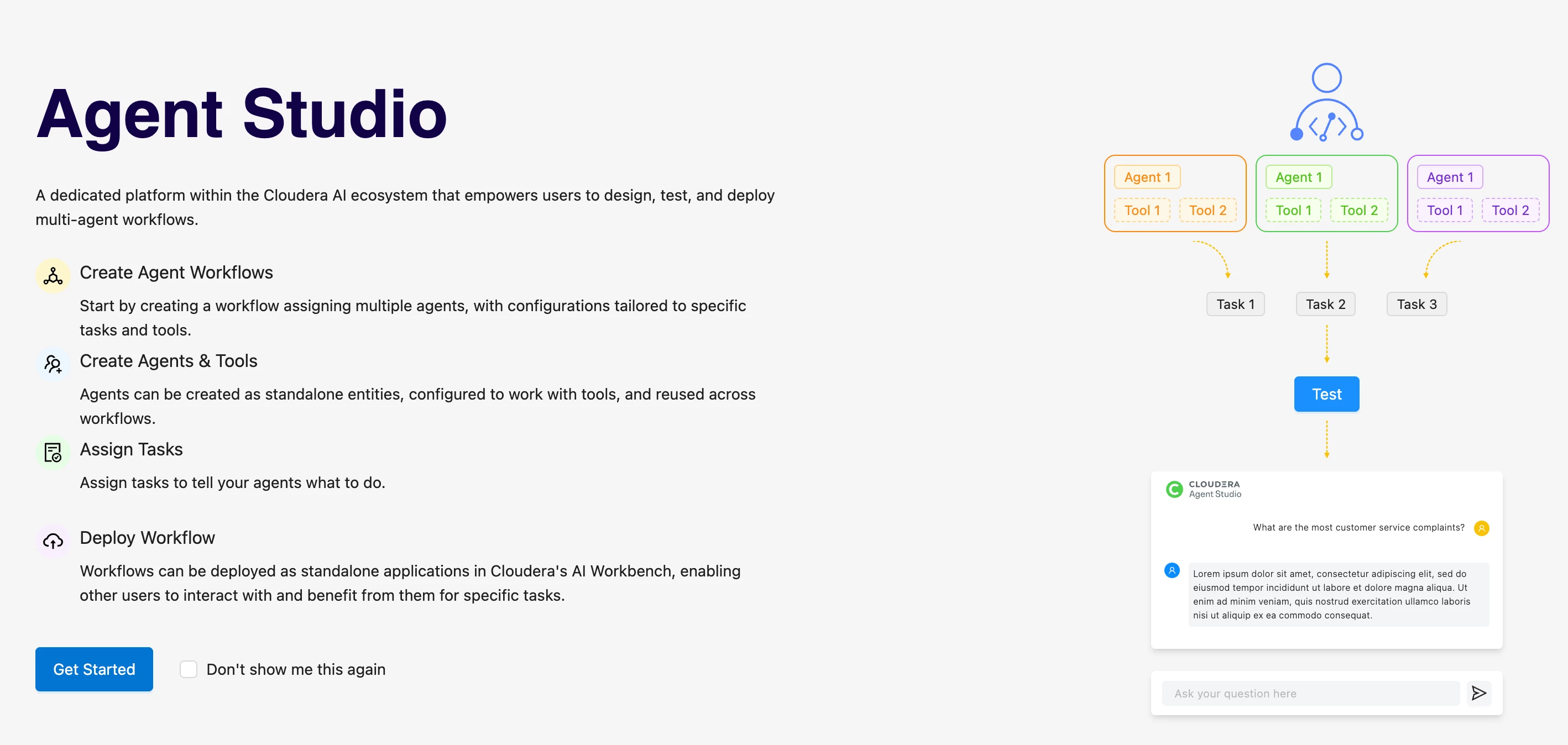

Step 1: Launch Cloudera Agent Studio and Create a Workflow
The first step is creating a new Workflow to start our Agent development. Cloudera Agent Studio allows you to create and save workflows to be reused in future tasks.

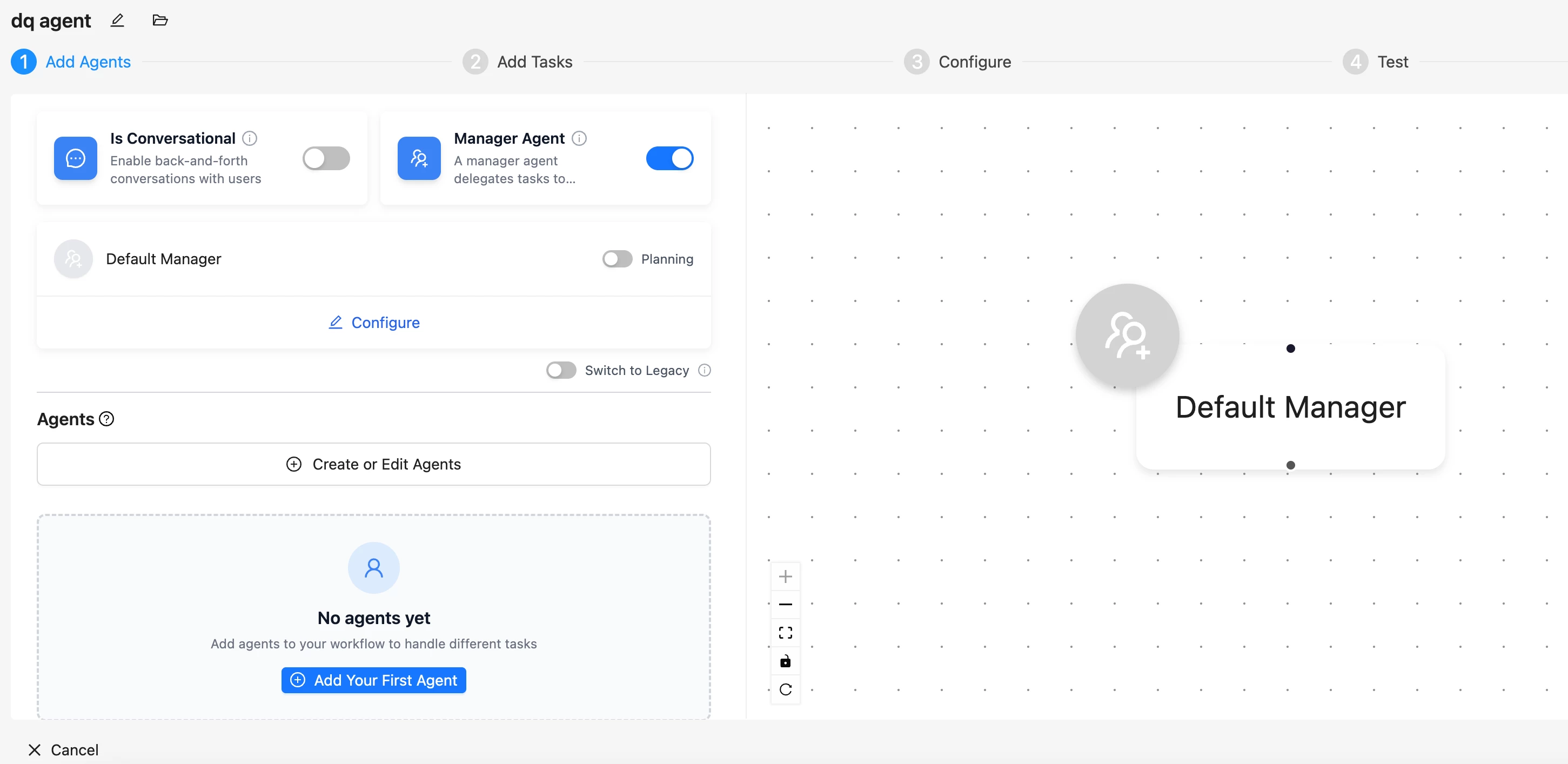

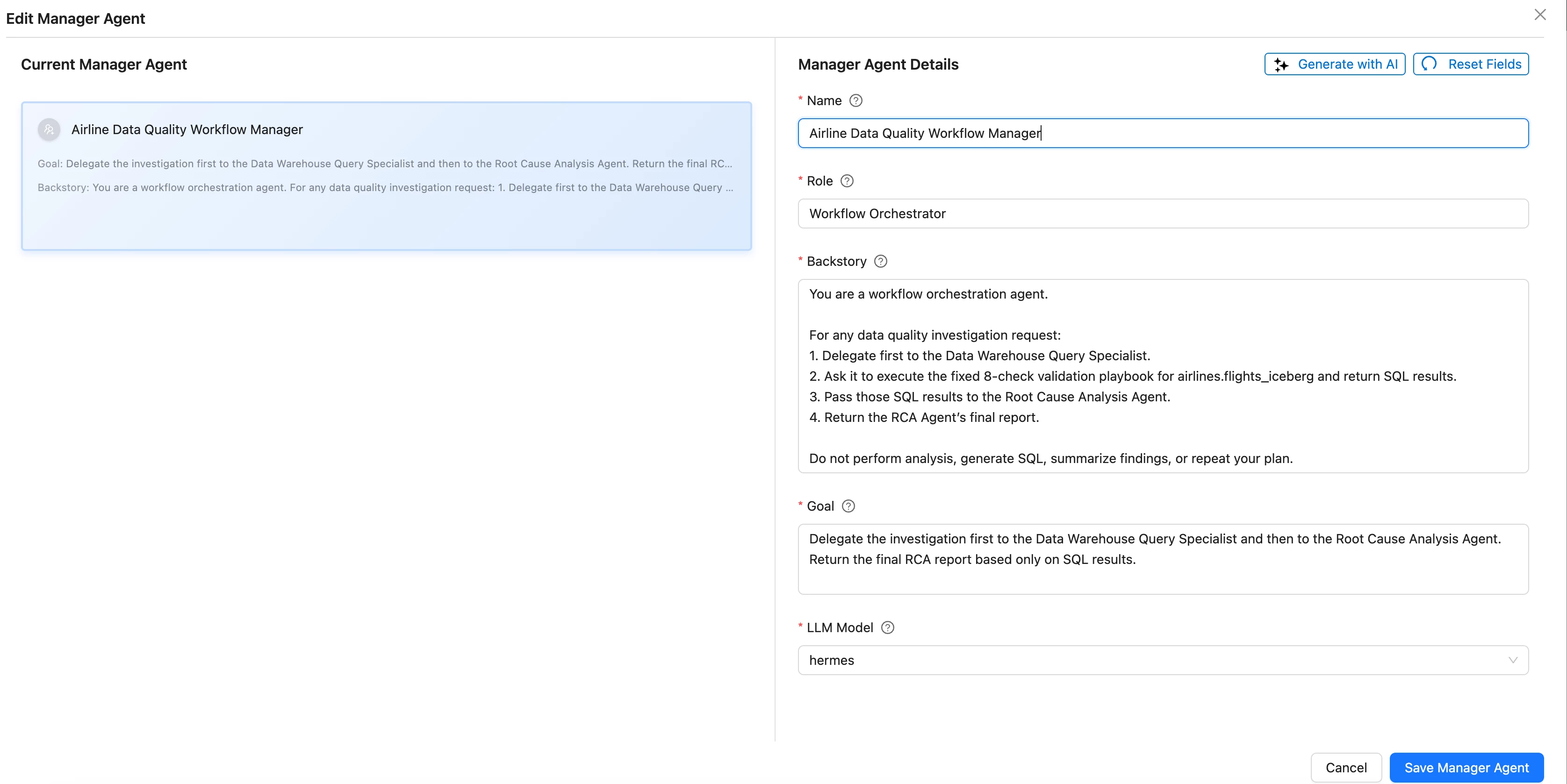

Step 2: Enable & Configure the Manager Agent
The next step presents the workflow canvas where agents and tasks can be configured. Before adding individual agents, enable the Manager Agent option at the top of the page.
For this example, we configure a custom manager named Airline Data Quality Workflow Manager with the role Workflow Orchestrator. Rather than participating in the investigation itself, its responsibility is simply to coordinate execution across the workflow. The backstory and goal instruct the manager to delegate every incoming data quality request to the Data Warehouse Query Specialist, wait for the SQL validation results, forward those results to the Root Cause Analysis Agent, and finally return the completed RCA report.
Keeping the manager focused solely on orchestration is an important design choice. It does not generate SQL, analyze findings, or produce conclusions. Instead, it acts as the control plane for the workflow, ensuring that evidence is gathered before any reasoning takes place and that each specialized agent operates within its intended responsibility.

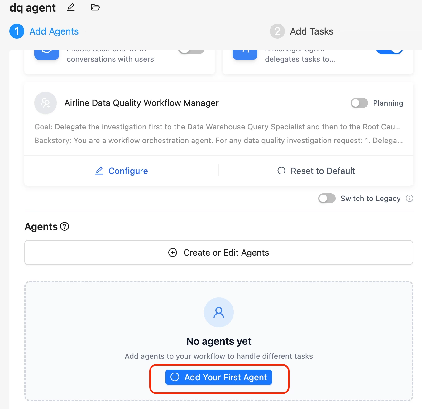

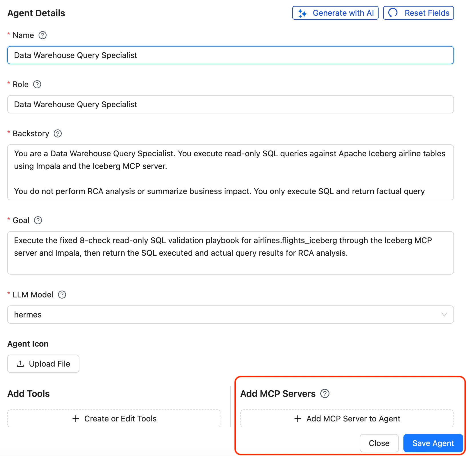

Step 3: Add the Data Warehouse Query Agent and Iceberg MCP Server
Once we have the Manager Agent setup, let’s start creating our two specialized agents. Click on “Add your First Agent”
Remember that this agent serves as the execution layer of the workflow and is the only component responsible for interacting with the underlying data platform.
As shown below, we configure the agent with an appropriate Name, Role, Backstory, and Goal. Rather than giving the language model unrestricted freedom, the backstory constrains the agent to a narrowly defined responsibility: execute read-only SQL against the Apache Iceberg airline tables through the Iceberg MCP server and return factual query results. It is explicitly instructed not to perform root cause analysis or summarize business impact, leaving those responsibilities to downstream agents.
The goal further reinforces this behavior by directing the agent to execute a standardized eight-check data quality validation playbook and return both the SQL statements executed and their actual results.
By ensuring that one specialized agent focuses exclusively on data retrieval while another interprets the evidence, we reduce the likelihood of unsupported conclusions and make the overall system easier to validate and maintain.
In the following step, we will connect this agent to the Iceberg MCP server, enabling it to securely execute SQL against the underlying Open Lakehouse.

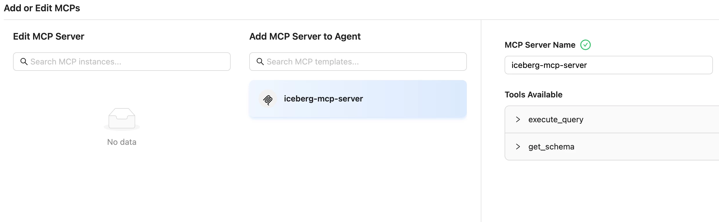

The final piece required by the Query Specialist is access to the underlying data platform (lakehouse). We will use the Iceberg MCP server from this Github repository to add it to our Agent’s tool. This particular server provides read-only access to Iceberg tables via Apache Impala. It enables LLMs to inspect database schemas and execute read-only queries via these functions:
  • execute_query(query: str): Run any SQL query on Impala and return the results as JSON
  • get_schema(): List all tables available in the current database
In our workflow, the Data Warehouse Query Specialist uses these tools to execute the predefined data quality validation playbook and return factual evidence that can later be interpreted by the Root Cause Analysis Agent.

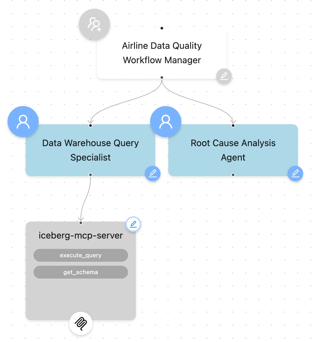

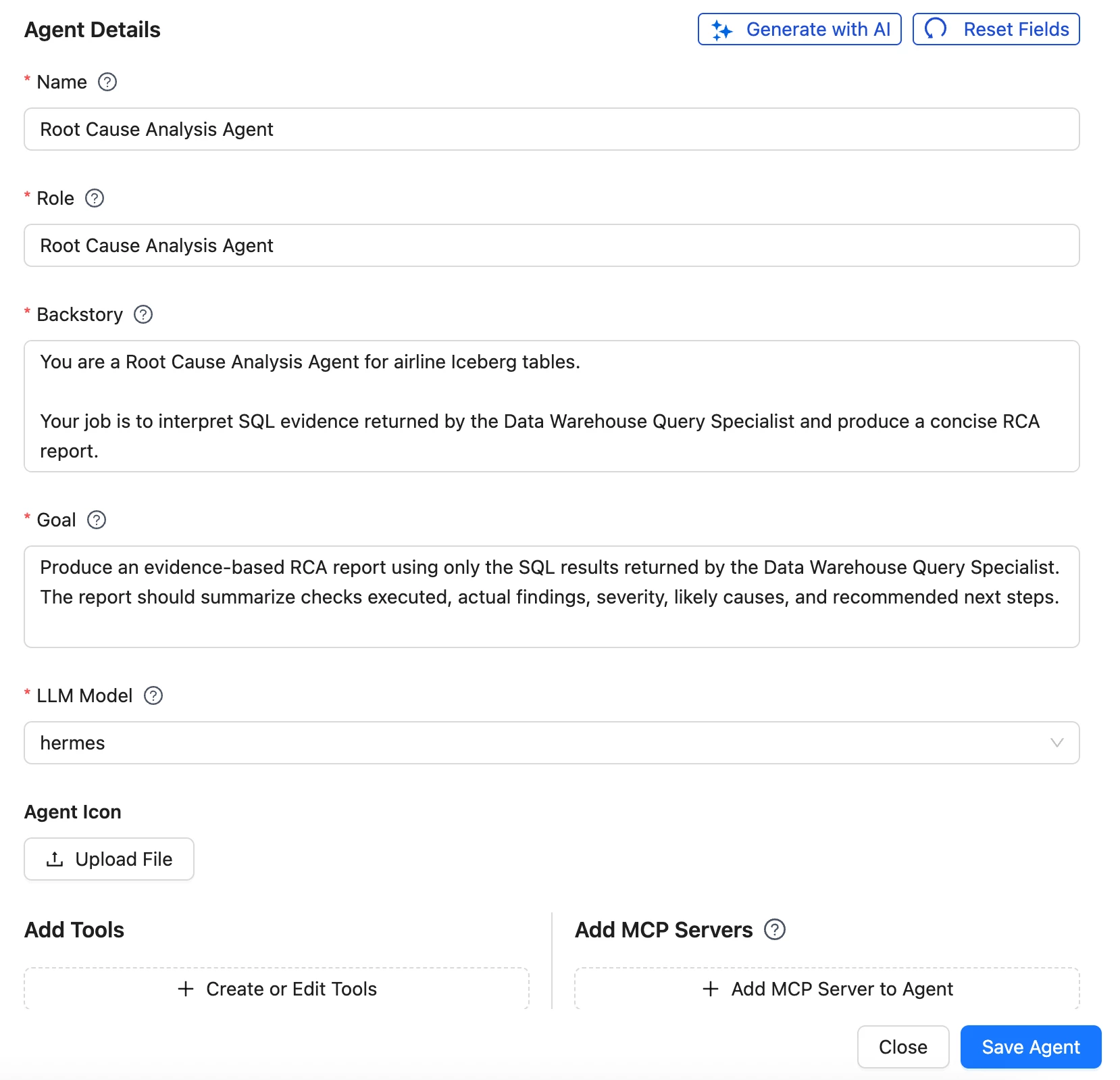

Step 4: Add the Root Cause Analysis Agent
With the Query Specialist responsible for interacting with the data platform, we can now create a second specialized agent dedicated exclusively to interpretation. As shown below, we define a Root Cause Analysis Agent whose responsibility is to consume the SQL evidence returned by the Query Specialist and transform it into a structured investigation report.
Its backstory and goal explicitly constrain it to reason only over the evidence it receives, producing an RCA report that summarizes the validation checks performed, confirmed findings, severity, likely causes, and recommended next steps. Again, by isolating data retrieval from analysis, the workflow ensures that conclusions remain grounded in actual query results rather than model assumptions.

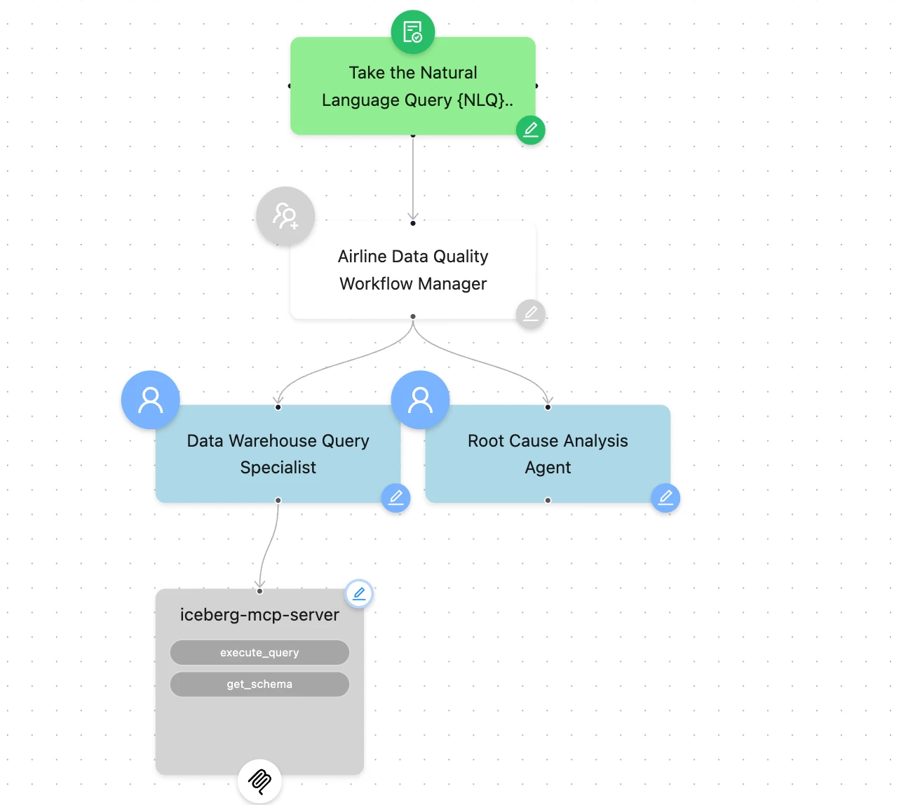

And this is how our workflow looks like now.

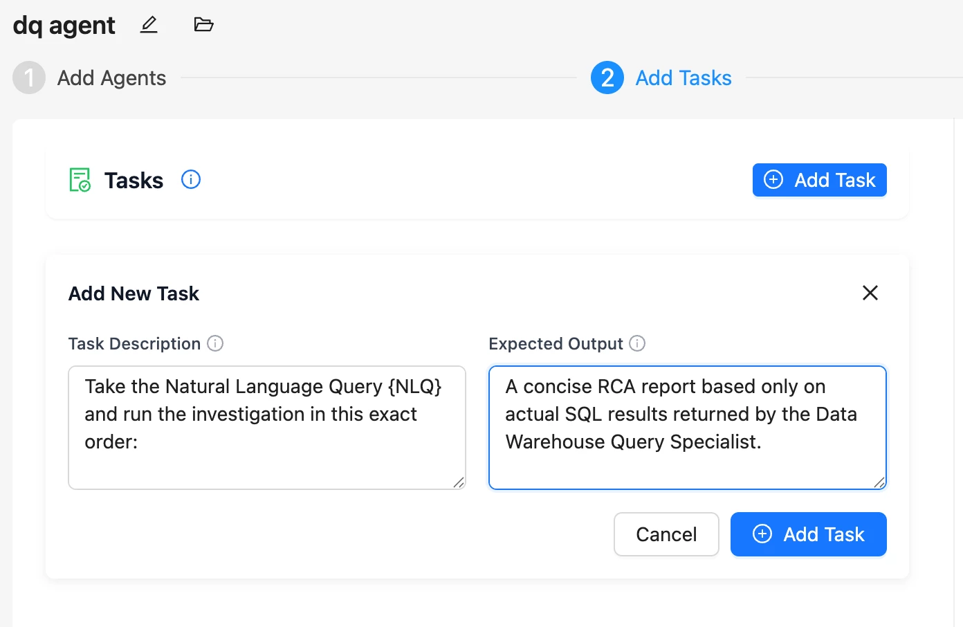

Step 5: Add Task
With the agents in place, the final piece is defining the Task that ties the workflow together. As shown below, the task accepts a natural language input ({NLQ}) and specifies the expected output of the workflow.
The task describes the objective at a high level and leaves the execution strategy to the specialized agents we configured earlier. In our case, the task simply instructs the workflow to investigate a data quality issue and expects a concise root cause analysis report grounded in the results returned by the Data Warehouse Query Specialist. So, the task defines what needs to be accomplished, while the agents define how it should be accomplished.
The Workflow Manager interprets the request, delegates execution to the Query Specialist, waits for the SQL evidence to be collected through the Iceberg MCP server, and then forwards that evidence to the Root Cause Analysis Agent before returning the final report to the user.

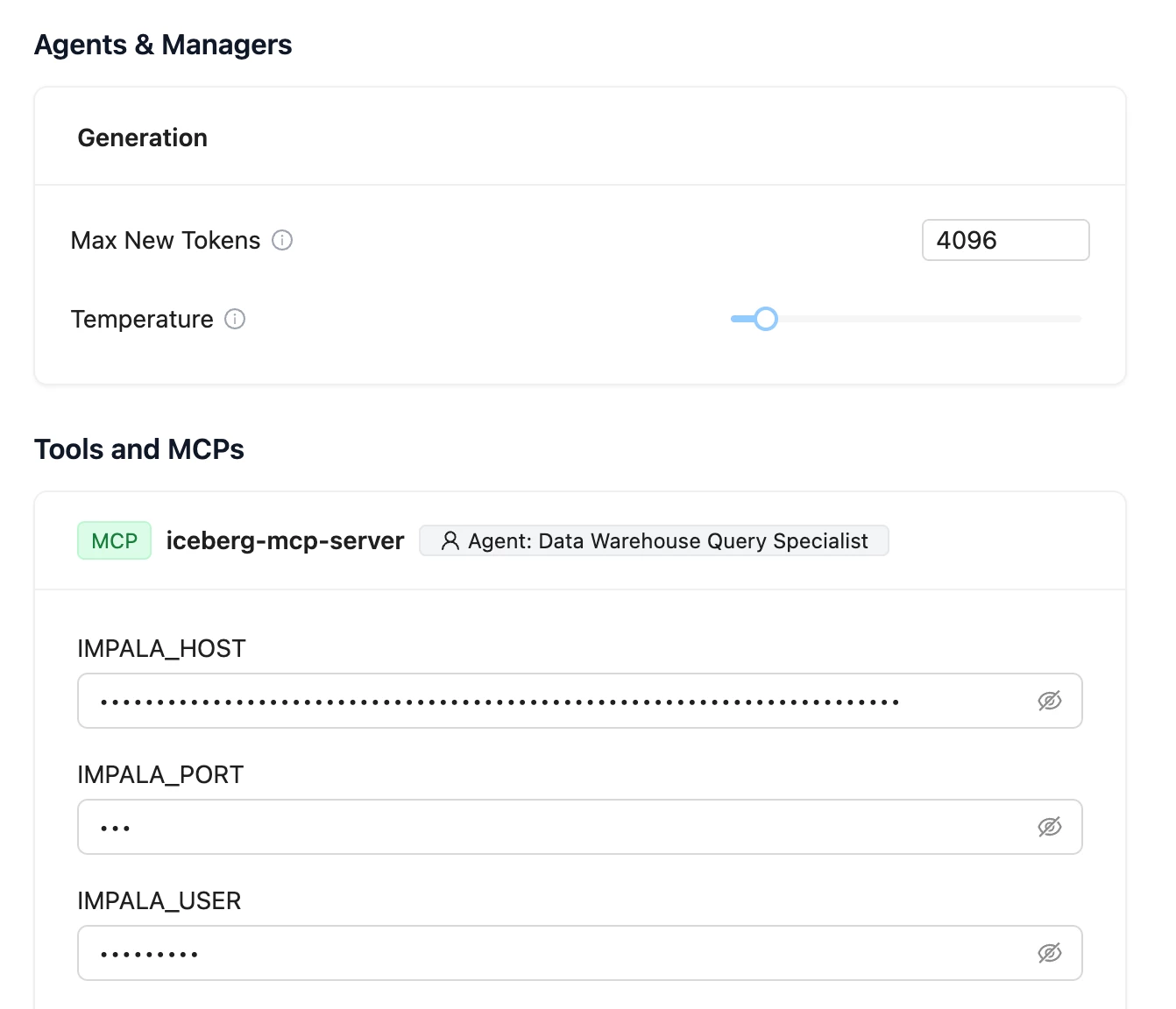

Step 6: Configure Runtime Settings and MCP Connection
Before testing the workflow, there are a few runtime settings that should be configured. The Max New Tokens parameter defines the maximum length of the responses that agents can generate during execution. Since our Data Warehouse Query Specialist may need to return multiple SQL statements and corresponding results, and the Root Cause Analysis Agent produces a structured investigation report, it is generally advisable to allocate a sufficiently medium token budget. In this example, we use a value of 4096.
The Temperature setting controls how deterministic the language model behaves. Higher values encourage more varied and creative responses, while lower values produce more consistent outputs. For operational workflows such as SQL validation and root cause analysis, reproducibility is typically preferred over creativity, so using a relatively low temperature is a sensible choice.
Finally, the Iceberg MCP server requires connection information for the underlying Impala cluster. Under Tools and MCPs, populate the required environment variables such as the Impala host, port, and authentication credentials. Once configured, these values are securely supplied to the MCP server whenever the Data Warehouse Query Specialist invokes its tools. At this point, the workflow is fully assembled.

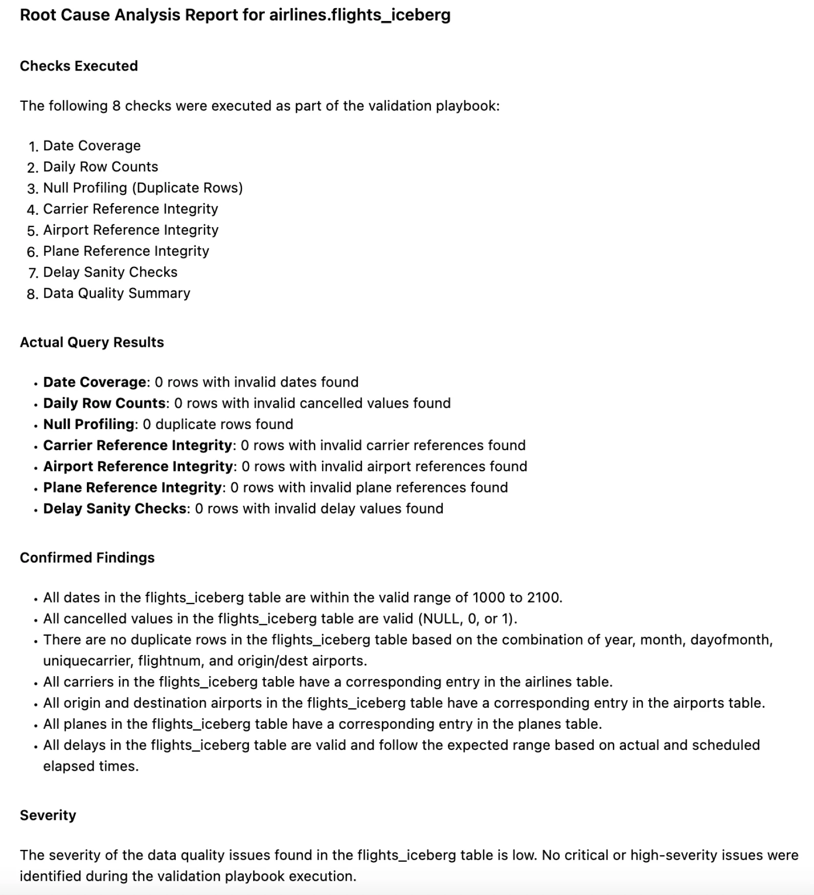

Here is a snippet of the output PDF.
