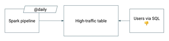

Motivation (simulated scenario)
Let's imagine we have a high-traffic table many users use in the platform. Each day, before the start of a work day, a Spark job populates this table with new records.
On most days, this simple architecture will work quite well. However, this morning the Spark job had a data error and wrote out a batch of duplicate records. This data quality issue was reported by one of the users and the data engineers are now trying to fix it. However, during this time, access to the high-traffic table is obviously disrupted.
Of course, data quality checks can be implemented to catch issues like this earlier. However, this still leaves you little time to roll back changes or fix the data issues before users are affected.

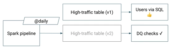

Write Audit Publish a pattern
These two characteristics can be used to support write-audit-publish pipelines, which have three separate stages:
  • Write: The ETL jobs modify the existing datasets (hidden from the main user base)
  • Audit: The new changes are checked for data quality and other data issues
  • Publish: Once approved, these changes are pushed out to the main user base

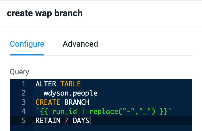

Create WAP branch
We can create the new branch using a CDW Operator using the run_id as a unique ID like so:
ALTER TABLE
db.table
CREATE BRANCH
`{{ run_id | replace("-","_") }}`
RETAIN 7 DAYS;
Note: You will need to configure a CDW connection in Airflow.
Note: The run ID is only unique within a single CDE Virtual Cluster. If you have multiple CDE Virtual Clusters deployed, append a prefix for each Virtual Cluster e.g. `vc1_{{ run_id | replace('-', '_') }}` to ensure it remains unique.

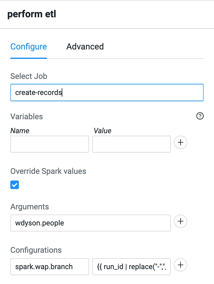

Perform ETL
Set up the Spark job(s) used to populate the table contents and ensure that Override Spark Values are checked. Override the spark.wap.branch parameter and set this parameter to the WAP branch name:
spark.wap.branch={{ run_id | replace("-","_") }}
Note: Whilst this example only includes one table and one ETL job, this pattern can be used across multiple tables and ETL jobs, as long as the WAP branch ID is consistent across all of the tables and jobs.

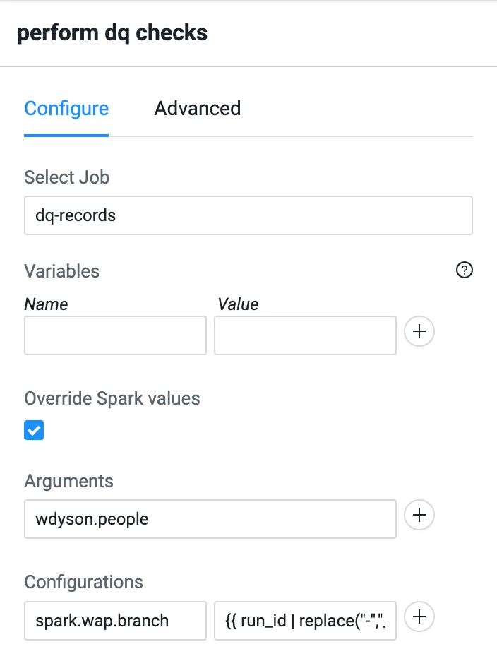

Perform DQ checks
Similar to the ETL jobs, set up the data validation Spark job(s) with the appropriate value for the spark.wap.branch parameter:
In this toy example, the data-quality check job is the following (Scala) Spark job using the Deequ data-quality library: [2]

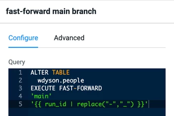

Fast-forward main branch
We can fast-forward the main branch to match the WAP branch like so:
ALTER TABLE
db.table
EXECUTE FAST-FORWARD
'main'
'{{ run_id | replace("-","_") }}';
Note: As this job is dependent on the Perform DQ checks job, it will only run if the data quality check job succeeds.
