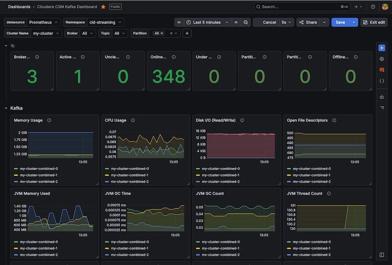

1. Monitoring Cloudera Streams Messaging (CSM) with Prometheus
Apache Kafka is the undeniable backbone of modern real-time data, but monitoring its internal health on Kubernetes can often feel like trying to pick a lock. While the Strimzi-powered Cloudera Streams Messaging (CSM) Operator effortlessly spins up your brokers, the critical metrics you need to keep things running smoothly—like byte throughput and under-replicated partitions—are trapped deep inside the JVM. Because Prometheus doesn’t natively speak JMX, we can’t just open a port and call it a day.
In Part 1 of this series, we are going to crack open that black box around Kafka. We will walk step-by-step through injecting a custom JMX Prometheus Exporter into your CSM cluster and deploying a specialized PodMonitor to translate those buried JVM metrics into crystal-clear results in Prometheus and Grafana.

Visualizing CSM Kafka with Grafana DashboardsPermalink
With Prometheus feeding live data, Grafana turns those raw metrics into professional dashboards. However, “no data” is a common issue at this stage — usually because Prometheus is not yet scraping the Kafka brokers or the dashboard variables don’t match your labels.
Open Grafana (minikube service grafana -n cld-streaming). Login with admin and the password from the secret (see Section 4).
Verify the Prometheus Data Source
Go to Configuration → Data Sources.
  • The “Prometheus” source should point to something like http://prometheus-operated.monitoring.svc:9090.
  • Click Save & Test. It must say “Data source is working”.
    (Note: The “Test” button is at the bottom of the datasource edit page.)
Import the Cloudera CSM Kafka Dashboard
  1. Download the JSON:
    curl -O https://raw.githubusercontent.com/cldr-steven-matison/ClouderaStreamingOperators/refs/heads/main/csm-kafka-dashboard.json
  2. In Grafana → Dashboards → New → Import
  3. Click Upload JSON file and select the downloaded file.
  4. On the next screen:
    • Datasource → select your Prometheus data source
    • Click Import
Boom. You now have the new Cloudera CSM Kafka Dashboard in Grafana:

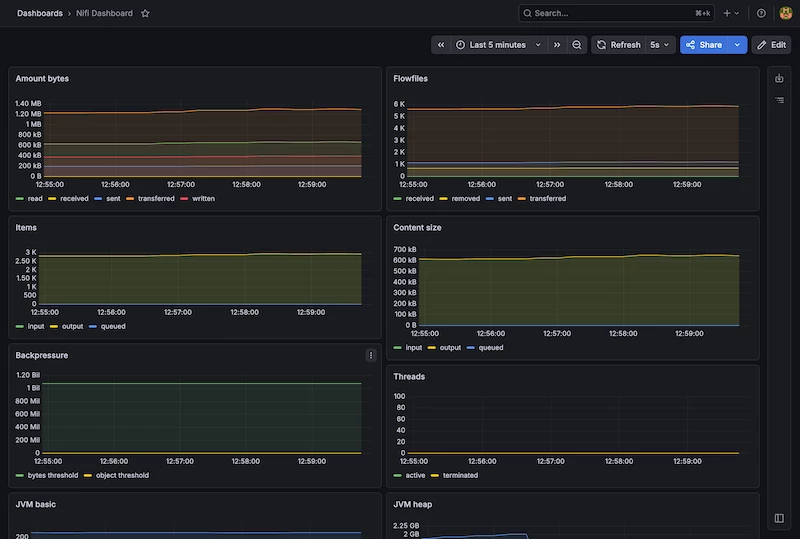

Visualizing CFM NiFi with Grafana DashboardsPermalink
With Prometheus pulling the data, let’s load up a beautiful community-built dashboard.
Step 1: Import the Dashboard
  1. Open Grafana and navigate to Dashboards -> New -> Import.
  2. In the “Import via grafana.com” box, type 15822 (or 12375) and click Load.
  3. Select your Prometheus data source at the bottom and click Import.
Boom. You now have full JVM stats, FlowFile queue tracking, and throughput metrics.

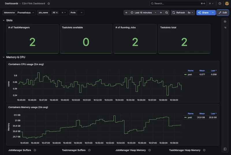

Visualizing in GrafanaPermalink
Import the Cloudera CSA Flink Dashboard
  1. Download the CSA Flink Dashboard JSON:
    curl -O https://raw.githubusercontent.com/cldr-steven-matison/ClouderaStreamingOperators/refs/heads/main/csa-flink-dashboard.json
    • Click Import
Boom. You now have the new Cloudera CSA Flink Dashboard in Grafana:

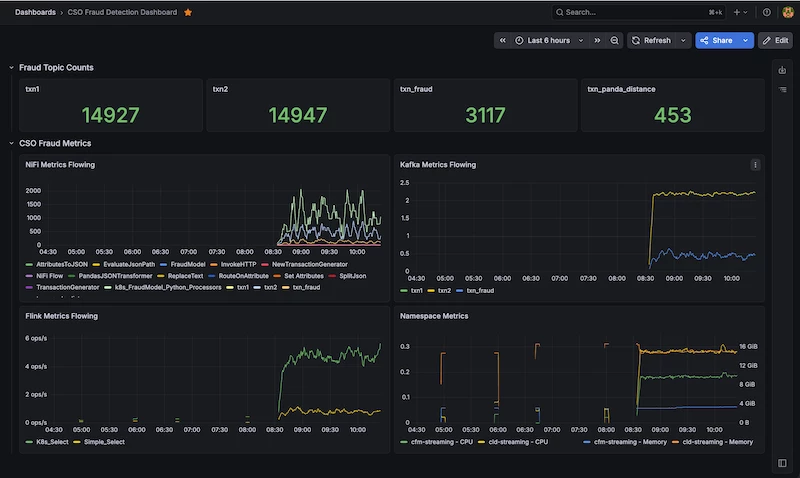

End to End CSO Dashboard with GrafanaPermalink
Now that we have all of our operator based metrics flowing, all of the operator dashboards setup, and a good understanding of how Prometheus and Grafana queries work. We can easily build a new Fraud Dashboard with Grafana.
Download the CSO Fraud Detection Dashboard JSON and import it into Grafana.
