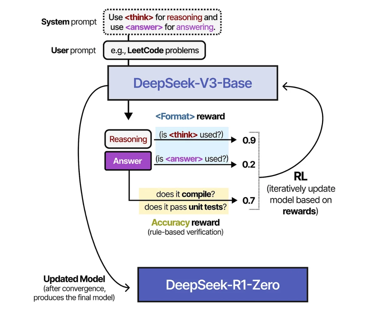

A visual representation of the RL pipeline used in DeepSeek-R1-Zero is illustrated below. This was the first open-source model to demonstrate that advanced reasoning capabilities can be developed purely through reinforcement learning. Without pre-labeled datasets, the model learns through trial and error, refining its behavior, parameters, and weights based solely on feedback from the solutions it generates.
Fig 1: RL pipeline used in Deepseek-R1-Zero,
Reference: A Visual Guide to Reasoning LLMs

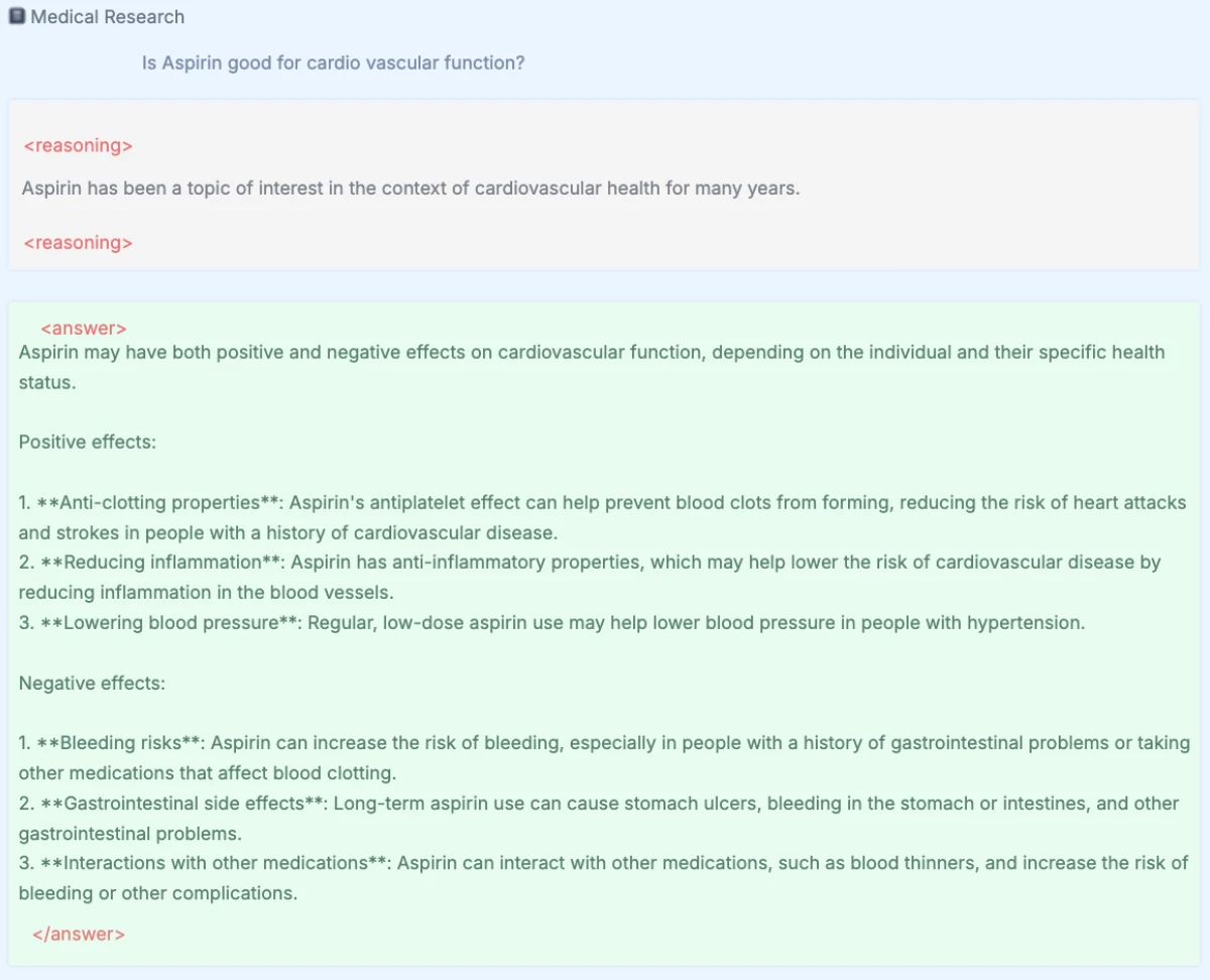

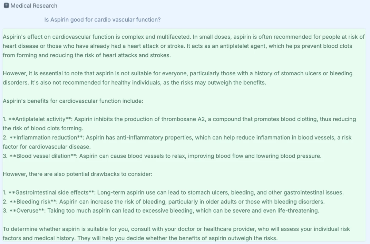

You should observe that the model now adheres to the specified format, presenting its reasoning before providing an answer.
6.1 Before vs After GRPO
  • Before GRPO Fine-Tuning:
    • Free form response, no <reasoning>/<answer> tags
    • Responses are detailed, but unstructured output
  • After GRPO Fine-Tuning
    • We notice structured output, with a <reasoning> section, then <answer> section
    • Strict adherence to  the system prompt format
    • Concise, relevant clinical output
Input: “Is Aspirin good for cardiovascular function?”
Output (Before GRPO): A response from the base LLM, answering the question “Is Aspirin good for cardio vascular function?”
Output (After GRPO): A response with reasoning leading to the final answer, with a more structured output presented within the answer tags. Additional training can lead to more fine-grained reasoning traces within the reasoning tags.
