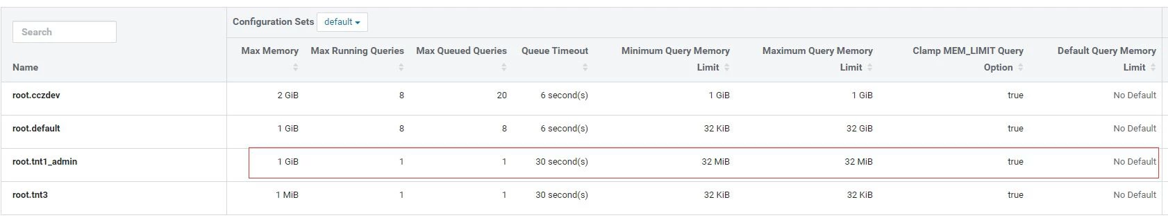

About Impala's Dynamic resource pool configuration
1、Config values:

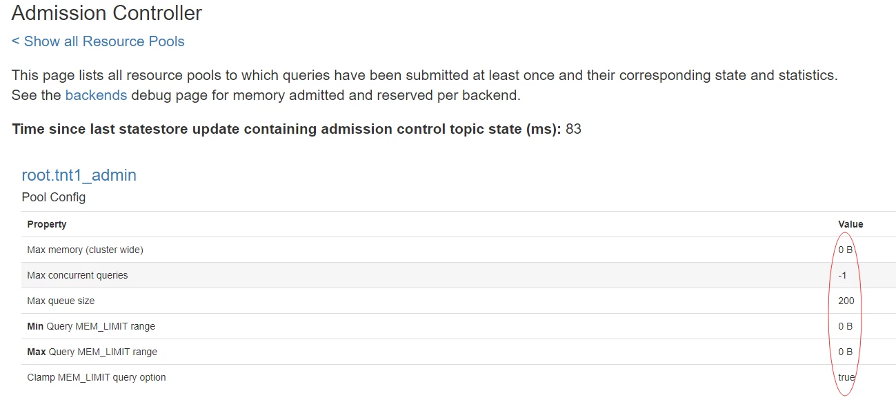

2、Actual Values:

Impala only looks for updates to the config values to a pool when a query is submitted to it. The changes that you made in Cloudera manager would have been propagated to all the Impalads. So the first query that you submit to that pool will use the updated configs and you ll see them updated on the admission control debug webpage as well.
