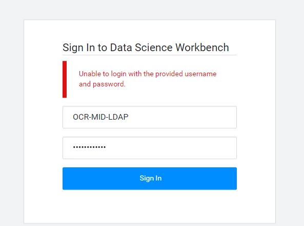

MID_ACN
MID_ACNAuthor
Silver ⭐️
Sep 17, 2024 9:42 AM UTC
Hi,
thanks for the help, we modified the configuration but now we have a problem with autentication
Is it possible to modify the ldap parameters on the cli command or can you suggest us the path to find the ldap files configuration, please?

Mike
Gold ⭐️
MikeAnswer
Gold ⭐️
Sep 18, 2024 6:52 PM UTC
Hi, the LDAP paramaters are stored inside the postgres database that backs CDSW. It's best not to change these database entries manually. You can use the "debug login" URL here to fix the LDAP configuration: https://docs.cloudera.com/cdsw/1.10.5/external-authentication/topics/cdsw-debug-login-url.html
The "debug login URL" will bypass LDAP and let you log in directly to CDSW as the first user that was created, typically an account named "admin" or something like that.
If you do NOT know the admin user login information, you can reset that in the database with a procedure like:
1) SSH to the CDSW master host
2) accesss the db
kubectl exec -it $(kubectl get pods -l role=db -o jsonpath='{.items[*].metadata.name}') -- psql -P pager=off -U sense
3) Set the "password1" password for an existing user, for example 'admin':
sense=# UPDATE users SET password='$2a$12$soyqZyDasDpsU/vDx3Y0Euq23OMLxqxDffAIjighiH.oVdV64VVvC' WHERE username='CDSW_Admin';
make sure to update the username to whatever user you want to log in as. Before LDAP is set up, users are managed locally by the database, which is why this procedure works. The password is just a bcrypt'd version of "password1" but you can change this after you log in.
Once you log in, you'll be able to go to the Admin page and update the LDAP configurations.
