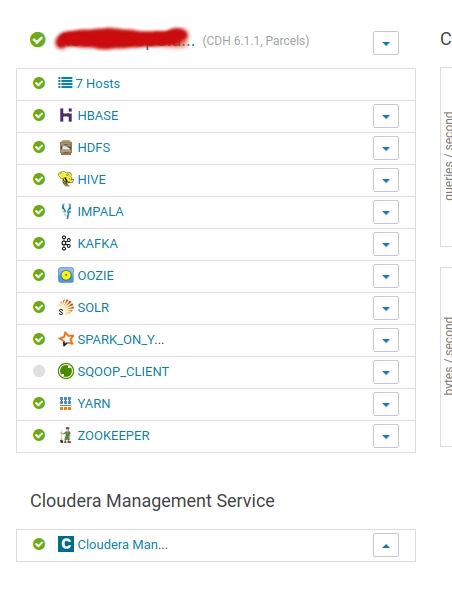

Please help I've spent 3 days and still can't get an example to run including pi, terasort or even wordcount
New installation and have turned on HA for yarn and also hdfs, and installed the yarn MapReduce Framework JARs as well. Cluster looks health as seen below:
If I try and run any of the examples ...they fail.

bgooley
bgooleyAnswer
Gold ⭐️
Mar 3, 2020 4:12 PM UTC
That's great!  You should be able to replace the "NOT FOUND" values for those two fields with:
-Djava.net.preferIPv4Stack=true
This will configure it as CM usually has by default.
Not sure how the NOT FOUND ended up there.

Hello @HadoopBD ,
Sorry to hear this has been causing you trouble.
I'll see if I can help with the investigation.
A few things you mention that are relevant:
- All examples fail, so that supports the assumption that it is something the jobs have in common that is contributing this issue.
- It also appears that the issue happen during container launch (as prelaunch.err contains the error)
- The failure indicates that somehow the class name was erroneously evaluated to the string "NOT" as seen here:
   Error: Could not find or load main class NOT
Since there is no class named "NOT" that implies whatever evaluation was done to attempt to execute that class was  incorrect.  For instance, you can get the same result if you run the following:
> java NOT
So, the question goes to what happened before an attempt was made to launch a container.
One thing that can be an influence is the environment (env variables).  If this is an out-of-the-box installation, we would not expect this to happen, so if you have updated any YARN or HDFS configuration, it would be good note.
We could use a bit more information, so I would suggest getting the logs for the application like this:
# yarn logs -applicationId application_1582677468069_0009 > application_1582677468069_0009.log
This should allow you to look at all the logs for this application including any information that may have been missing from the job stdout.
Also consider trying to run the job from the same host as the Resource Manager to see if the failure is the same.  If there is something related to your client environment or hadoop configuration, the test may highlight that type of issue.
Cheers,
Ben

678 Error: Could not find or load main class NOT
679 [2020-02-26 17:10:01.691]Container exited with a non-zero exit code 1. Error file: prelaunch.err.
680 Last 4096 bytes of prelaunch.err :
681 Last 4096 bytes of stderr :
682 Error: Could not find or load main class NOT
683 2020-02-26 17:10:02,257 INFO [RMCommunicator Allocator] org.apache.hadoop.mapreduce.v2.app.rm.RMContainerAllocator: Got allocated containers 4
684 2020-02-26 17:10:02,258 INFO [AsyncDispatcher event handler] org.apache.hadoop.mapreduce.v2.app.job.impl.TaskAttemptImpl: attempt_1582677468069_0009_m_000003_2 transitioned from state RUNNING to FAILED, event type is TA_CONTAINER_COMPLETED and nodeId=cdh-worker-2.private.cdhvcn.hiddenvcn.com:8041
685 2020-02-26 17:10:02,258 INFO [AsyncDispatcher event handler] org.apache.hadoop.mapreduce.v2.app.job.impl.TaskAttemptImpl: Diagnostics report from attempt_1582677468069_0009_m_000001_2: [2020-02-26 17:10:01.698]Exception from container-launch.
686 Container id: container_e02_1582677468069_0009_01_000012
687 Exit code: 1
688 [2020-02-26 17:10:01.733]Container exited with a non-zero exit code 1. Error file: prelaunch.err.
689 Last 4096 bytes of prelaunch.err :
690 Last 4096 bytes of stderr :
691 Error: Could not find or load main class NOT
692 [2020-02-26 17:10:01.733]Container exited with a non-zero exit code 1. Error file: prelaunch.err.
693 Last 4096 bytes of prelaunch.err :
694 Last 4096 bytes of stderr :
695 Error: Could not find or load main class NOT
696 2020-02-26 17:10:02,258 INFO [RMCommunicator Allocator] org.apache.hadoop.mapreduce.v2.app.rm.RMContainerAllocator: Assigning container Container: [ContainerId: container_e02_1582677468069_0009_01_000013, AllocationRequestId: -1, Version: 0, NodeId: cdh-worker-2.private.cdhvcn.hiddenvcn.com:8041, NodeHttpAddress: cdh-worker-2.private.cdhvcn.hiddenvcn.com:8042, Resource: <memory:1024, vCores:1>, Priority: 5, Token: Token { kind: ContainerToken, service: 10.161.2.3:8041 }, ExecutionType: GUARANTEED, ] to fast fail map
697 2020-02-26 17:10:02,258 INFO [RMCommunicator Allocator] org.apache.hadoop.mapreduce.v2.app.rm.RMContainerAllocator: Assigned from earlierFailedMaps
698 2020-02-26 17:10:02,258 INFO [AsyncDispatcher event handler] org.apache.hadoop.mapreduce.v2.app.job.impl.TaskAttemptImpl: attempt_1582677468069_0009_m_000001_2 transitioned from state RUNNING to FAILED, event type is TA_CONTAINER_COMPLETED and nodeId=cdh-worker-2.private.cdhvcn.hiddenvcn.com:8041
699 2020-02-26 17:10:02,258 INFO [RMCommunicator Allocator] org.apache.hadoop.mapreduce.v2.app.rm.RMContainerAllocator: Assigned container container_e02_1582677468069_0009_01_000013 to attempt_1582677468069_0009_m_000002_2
700 2020-02-26 17:10:02,259 INFO [AsyncDispatcher event handler] org.apache.hadoop.mapreduce.v2.app.job.impl.TaskAttemptImpl: Diagnostics report from attempt_1582677468069_0009_m_000000_2: [2020-02-26 17:10:01.688]Exception from container-launch.
701 Container id: container_e02_1582677468069_0009_01_000010
702 Exit code: 1
