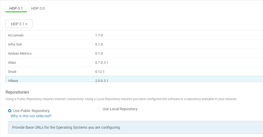

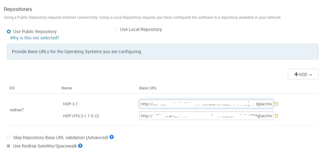

My repository base urls are as follows
I am using the same above urls in Select Version step of installaton wizard and checked on Public Repository as below
I follow the same steps and all the servers are registered, chose the required services and then deployed.

 When I looked at the ambari-hdp-repo in all servers, I noticed tht the base url for HDP and HDP Utils is blank.
[HDP-3.1-repo-3]
name=HDP-3.1-repo-3
baseurl=
path=/
enabled=1
gpgcheck=0
[HDP-UTILS-1.1.0.22-repo-3]
name=HDP-UTILS-1.1.0.22-repo-3
baseurl=
path=/
enabled=1
gpgcheck=0
 As Far as internet connectivity to the base urls go, I am able to open the urls in browser and also in CLI using wget  with the username authentication.
I have failed many times to understand the origin of these errors and request your intervention in resolving this issue. Have been stuck in this step for  a month. Kindly help to resolve this matter and I would greatly appreciate it.

For the HDP repo, can you share a complete screenshot of the repositories page
Translate
SSRIL
SSRILAuthor
Gold ⭐️
Jul 23, 2021 11:24 AM UTC
@Scharan
Thank you for your response.
 ambari-repo does exist in the host, since ambari server was installed using the ambari-repo into consideration. Smartsense is included, but somehow it is not able to download it, which is my concern.
The hdp repo from the screenshot is as follows
I have commented out the username and password for security purposes. It is similar as follows:
HDP: http://LOGIN:PASSWORD@archive.cloudera.com/p/HDP/3.x/3.1.0.0/centos7
HDPUTILS: http://LOGIN:PASSWORD@archive.cloudera.com/p/HDP-UTILS/1.1.0.22/repos/centos7/
