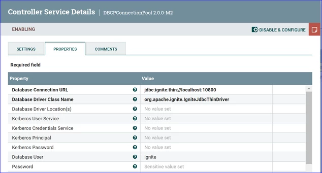

Hi,
I have Nifi 2.0-M2 and Apache Ignite 2.16 database running on my localhost.
http://localhost:8443/nifi
jdbc:ignite:thin://localhost:10800  (I am able to connect to Ignite localhost db from Dbeaver)
I have copied ignite-core-2.16.0.jar file to nifi lib directory (before starting nifi) and tried to create DBCPConnectionPool controller service in Nifi to connect to Ignite database.
DB Controller service returns the below error.
Failed to invoke @OnEnabled method: java.lang.NoClassDefFoundError: Could not initialize class org.apache.commons.dbcp2.BasicDataSource - Caused by: java.lang.ExceptionInInitializerError: Exception java.lang.NoClassDefFoundError: Could not initialize class org.apache.ignite.IgniteJdbcThinDriver [in thread "Timer-Driven Process Thread-10"]
Can you let me know what am I missing here?  Please let me know if more details are required.
Screenshot of DB controller service

Jim_Steinebrey
Gold ⭐️
Apr 16, 2024 2:11 AM UTC
The third property of the DBCPConnectionPool called "Database Driver Location" needs to be filled with the path to your nifi lib directory and then it should successfully load the JDBC driver class.

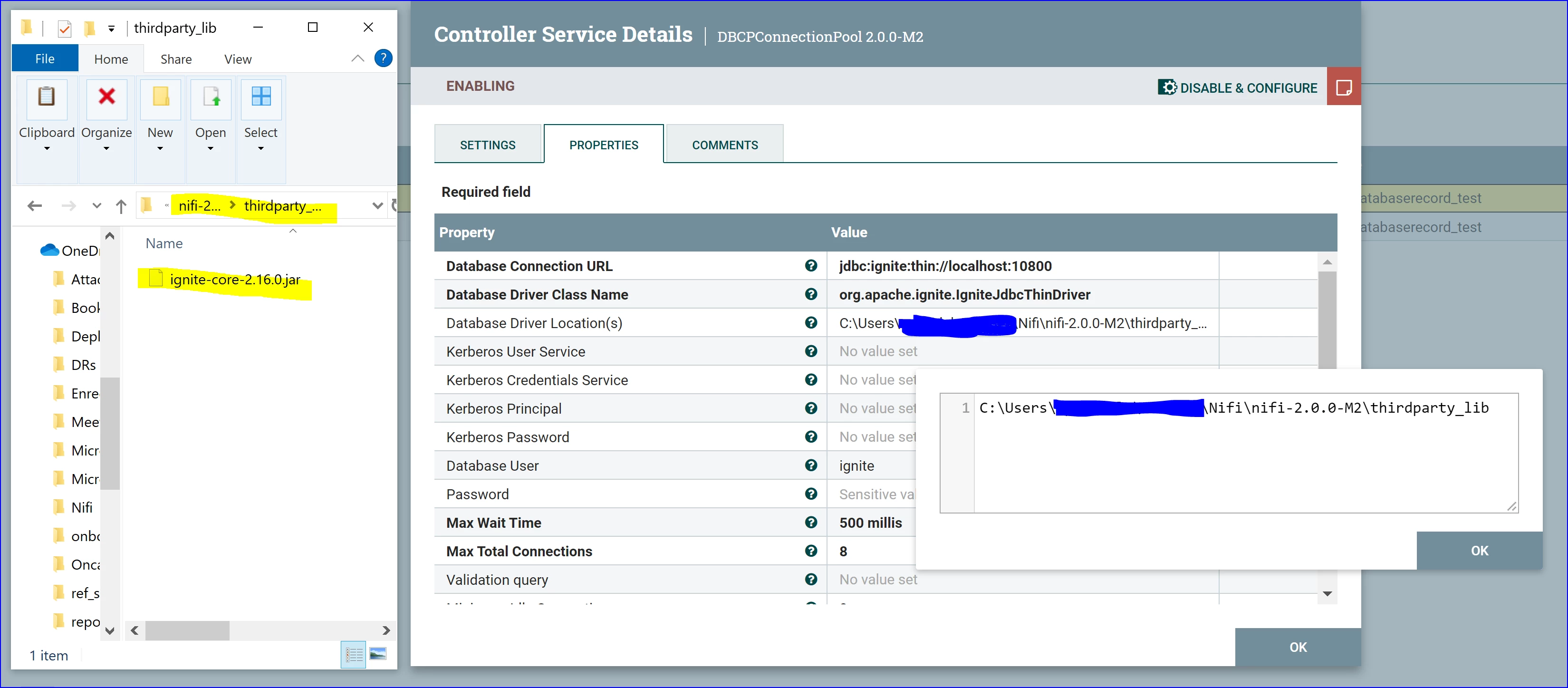

shiva239
shiva239Author
Gold ⭐️
Apr 16, 2024 8:34 PM UTC
@Jim_Steinebrey     @MattWho
Thanks for your response.  As mentioned, I have created another folder "thirdparty_lib" and updated the new location of jar file in "Database Driver Location(s)" field.  I am still getting the same error.  Please advise.

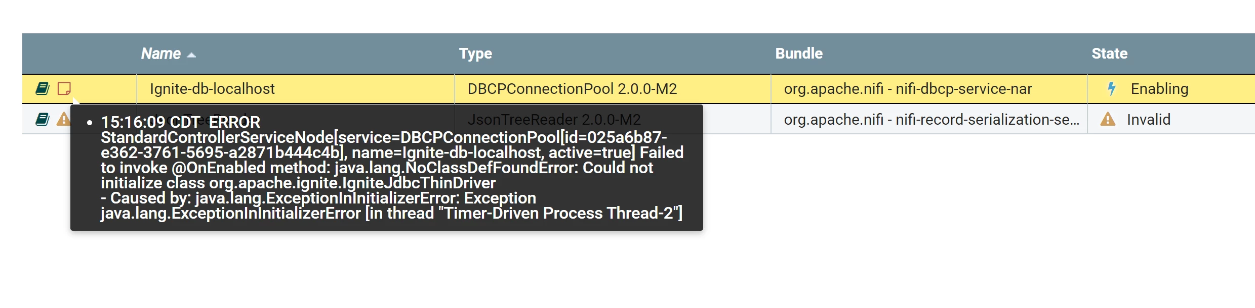

2024-04-17 12:50:13,061 ERROR [Timer-Driven Process Thread-2] o.a.n.c.s.StandardControllerServiceNode StandardControllerServiceNode[service=DBCPConnectionPool[id=025a6b87-e362-3761-5695-a2871b444c4b], name=Ignite-db-localhost, active=true] Failed to invoke @OnEnabled method
at org.apache.nifi.dbcp.AbstractDBCPConnectionPool.onConfigured(AbstractDBCPConnectionPool.java:139)
at java.base/jdk.internal.reflect.DirectMethodHandleAccessor.invoke(DirectMethodHandleAccessor.java:103)
at java.base/java.lang.reflect.Method.invoke(Method.java:580)
at org.apache.nifi.util.ReflectionUtils.invokeMethodsWithAnnotations(ReflectionUtils.java:145)
at org.apache.nifi.util.ReflectionUtils.invokeMethodsWithAnnotations(ReflectionUtils.java:133)
at org.apache.nifi.util.ReflectionUtils.invokeMethodsWithAnnotations(ReflectionUtils.java:78)
at org.apache.nifi.util.ReflectionUtils.invokeMethodsWithAnnotation(ReflectionUtils.java:55)
at org.apache.nifi.controller.service.StandardControllerServiceNode$2.run(StandardControllerServiceNode.java:655)
at org.apache.nifi.engine.FlowEngine$2.run(FlowEngine.java:110)
at java.base/java.util.concurrent.Executors$RunnableAdapter.call(Executors.java:572)
at java.base/java.util.concurrent.FutureTask.run(FutureTask.java:317)
at java.base/java.util.concurrent.ScheduledThreadPoolExecutor$ScheduledFutureTask.run(ScheduledThreadPoolExecutor.java:304)
at java.base/java.util.concurrent.ThreadPoolExecutor.runWorker(ThreadPoolExecutor.java:1144)
at java.base/java.util.concurrent.ThreadPoolExecutor$Worker.run(ThreadPoolExecutor.java:642)
at java.base/java.lang.Thread.run(Thread.java:1583)
Caused by: java.lang.ExceptionInInitializerError: Exception java.lang.NoClassDefFoundError: Could not initialize class org.apache.ignite.IgniteJdbcThinDriver [in thread "Timer-Driven Process Thread-2"]
