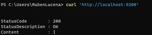

The elasticsearch instance is reachable using CURL or in a web browser:

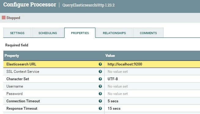

Here is the configuration I have in the processor:
The server is not secured, but anyway I also tried to access with a valid user/password, facing the same error.

The address you're trying to hit is "localhost". By any chance are you running ES in a Docker container on your machine? If so, have you exposed that port so that systems outside your own can access it? If you have, try changing localhost to your machines IP address in your NiFi ES processor config.
