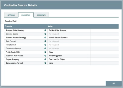

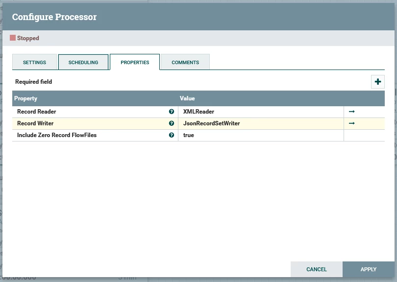

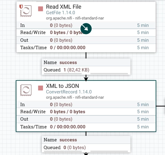

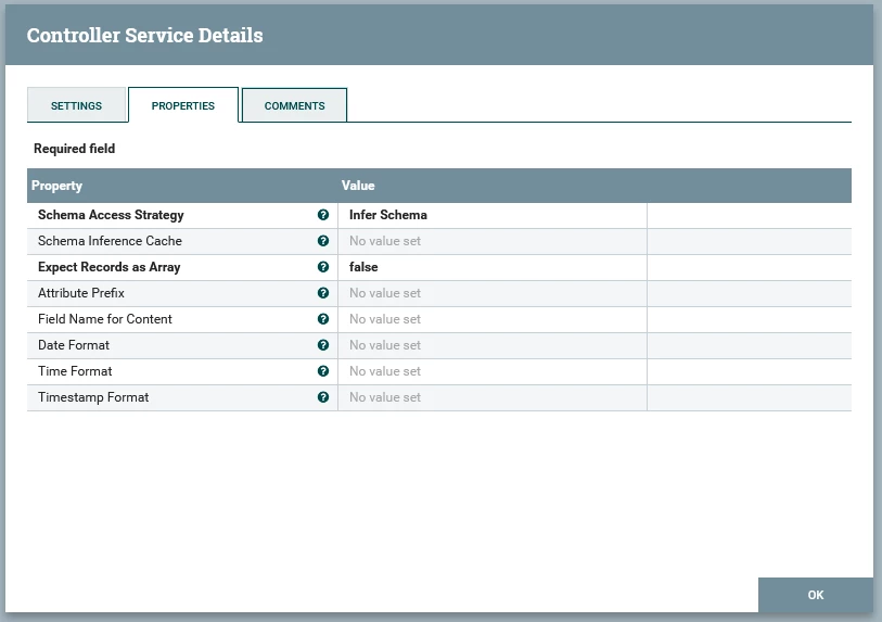

here is my flow
ConvertRecord
XMLReader
JsonRecordSetWritter
Everything is ok, but the problem is in convetring digit-values

@moshell281   This is indeed a very tough solution to solve.   The only thing that comes to mind is creating your own schema, versus inferring the schema.  Creating that schema from scratch could be a long task.  So one trick you can do would be to run the flow to infer the schema, and configure the controller service to write that schema to an attribute.   Inspect a flowfile and grab that schema.   Next modify the schema to suit your needs, and then modify and test the flow with the specified schema (no longer inferred).   This should allow you control to specify the correct data type for "000" so it is not assumed to be "0".

@steven-matisonis right, when you use infer schema  the processor will map the value as it thinks the data type should be, so if it sees an integer it will map to an integer and so on. To force certain datatypes you have to define your own Avro schema and feed it to the Json Record Set Writer since this is your target format. If you are not comfortable working with Avro schema then you can use UpdateRecord or even JsonJoltTransformation processors to cast the value into the proper type.
