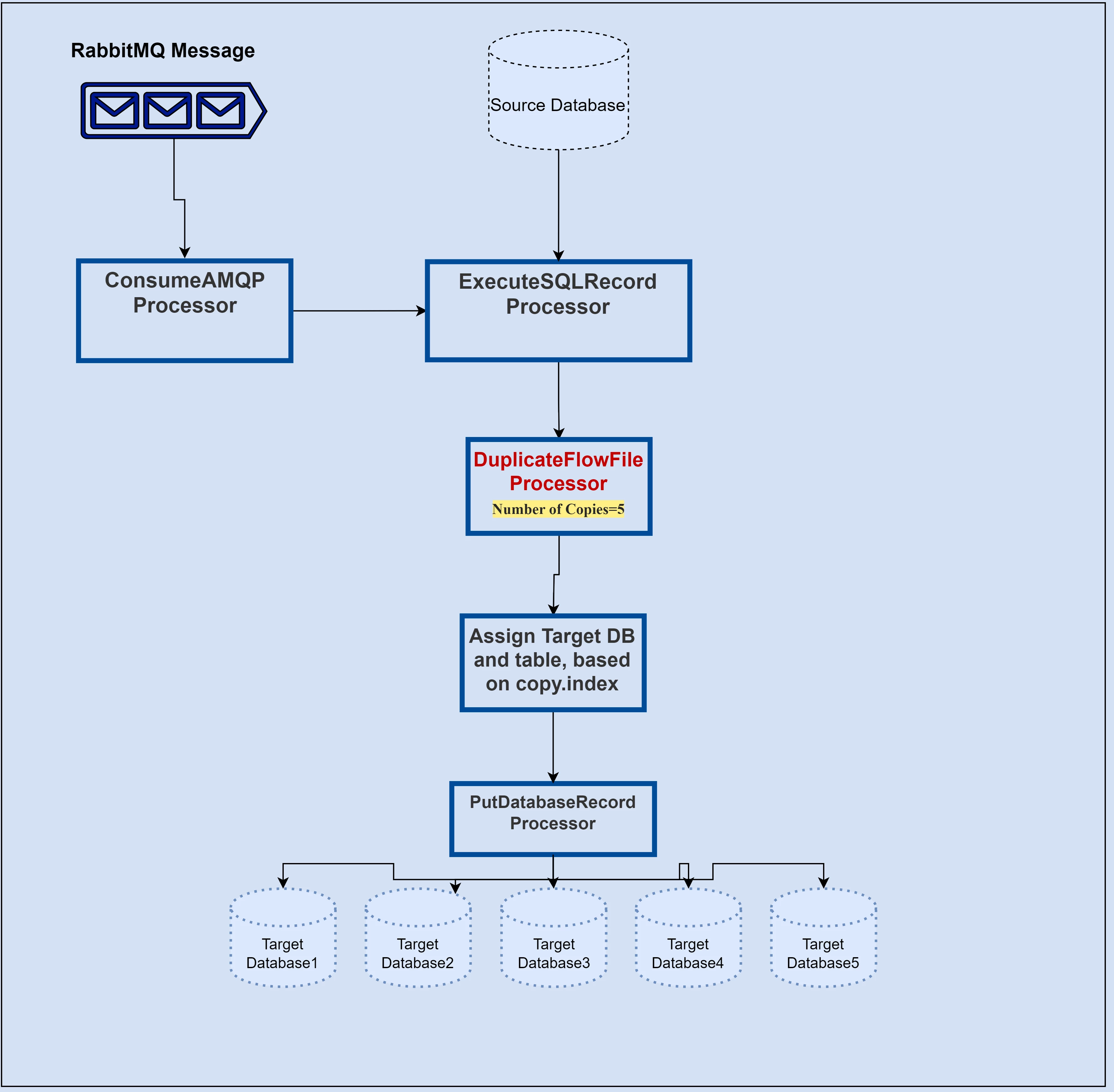

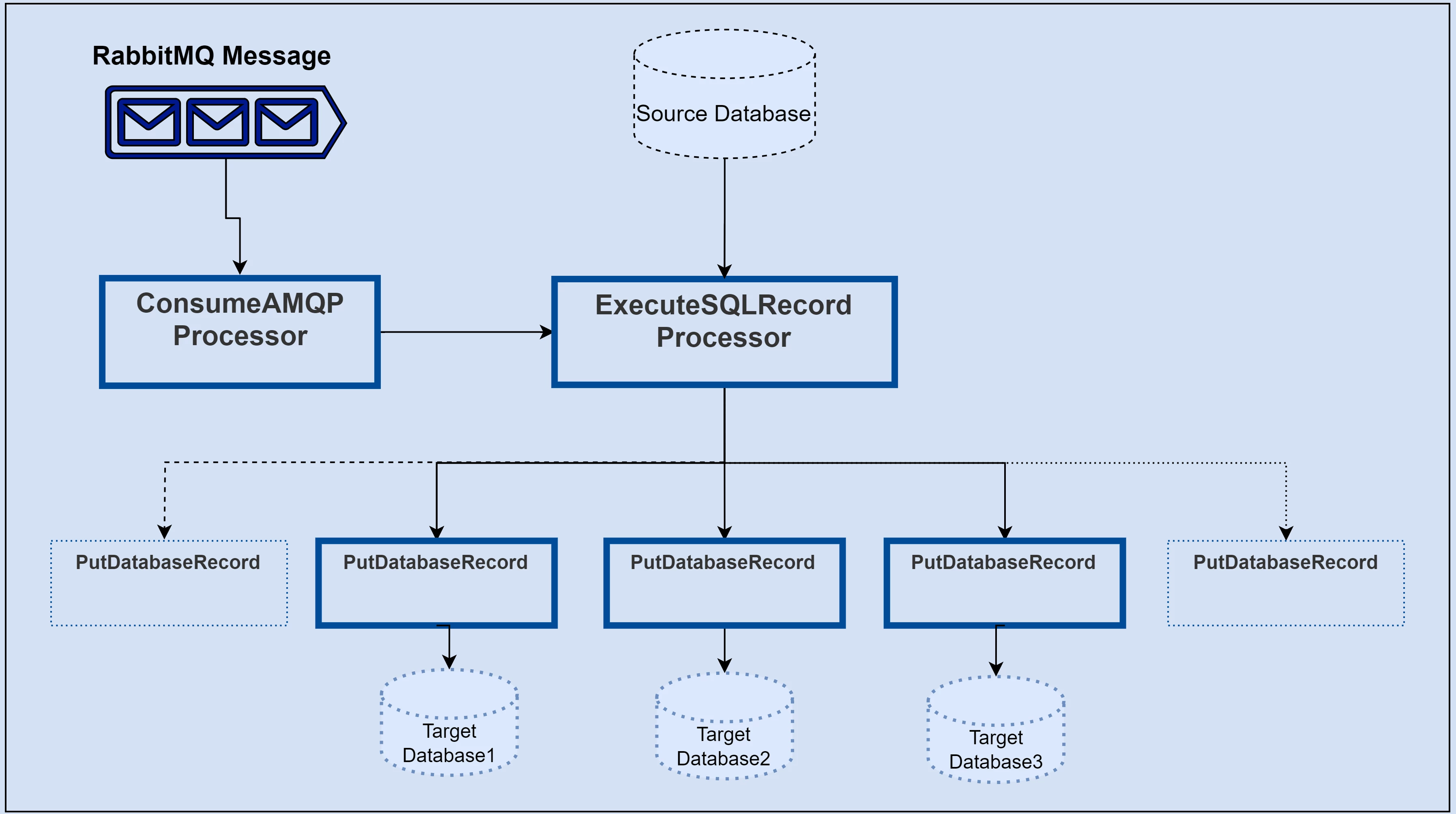

Please verify the current and improved designs below and advise if any implications with the new approach (where DuplicateFlowFile processor is used to clone flow files)
Current Design:
New Design is below (with DuplicateFlowFile processor)

I dont think there is a problem using the DuplicateFlowFile processor in production environment. If its really intended for test environment then it wont be provided as an option to begin with. Actually when I search the community for question around flowfile replication I found this post that mentions this processor as part of the solution but I dont see any comments advising against it siting test vs prod regardless if it helped in that case or not.

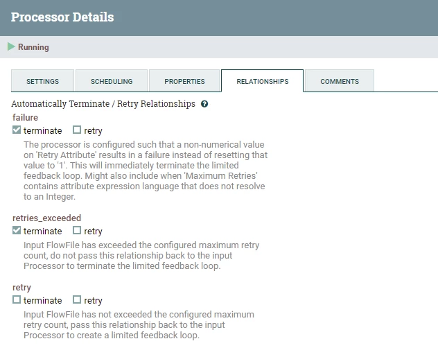

However, if you are not comfortable using the Duplicate processor, there are of course different ways of doing the same thing in Nifi. Lets assume you want to write code to address this problem instead of using Nifi, how would you do it without having to repeat the same code for each target DB? I think one of the first things that comes to mind is using a loop. You can create a loop in Nifi in multiple ways, the easiest I can think of is to use the RetryFlowFile processor. Although its intended more for error handling you can still use it to replicate a loop flow. All you have to do after getting the file is to set the maximum number of retries to how many times ( or steps ) you want to execute against and then redirect the retry relationship to itself and the next step (assign DB & Table based on index). Once the number of retries exceeded you can handle that via the retries_exceeded relationship or you can simply terminate the relationship so its completed.

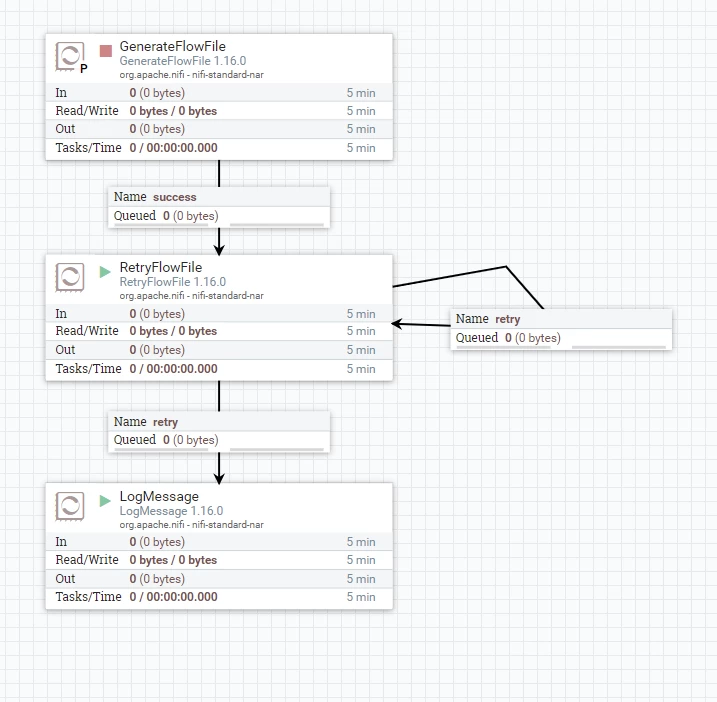

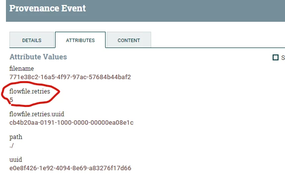

Here is an example of simple flow that loops 5 times against a given flowfile input from GenerateFlowFile:

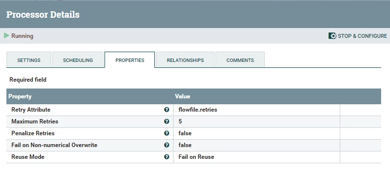

This how the  RetryFlowFile is configured:
The Retry Attribute will store the retries count in the provided attribute name "flowfile.retries".

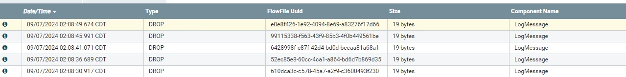

If you run the GenerateFlowFile once and look at the LogMessage data provenance you will see it was executed 5 times against the same content :
If you check the attributes on each event flow file you will see the flowfiles.retries is populated with the nth time the flowfile was retried. Keep in mind the data provenance stores the last event at the top which means the first event flowfile attribute will have the value of 5:
