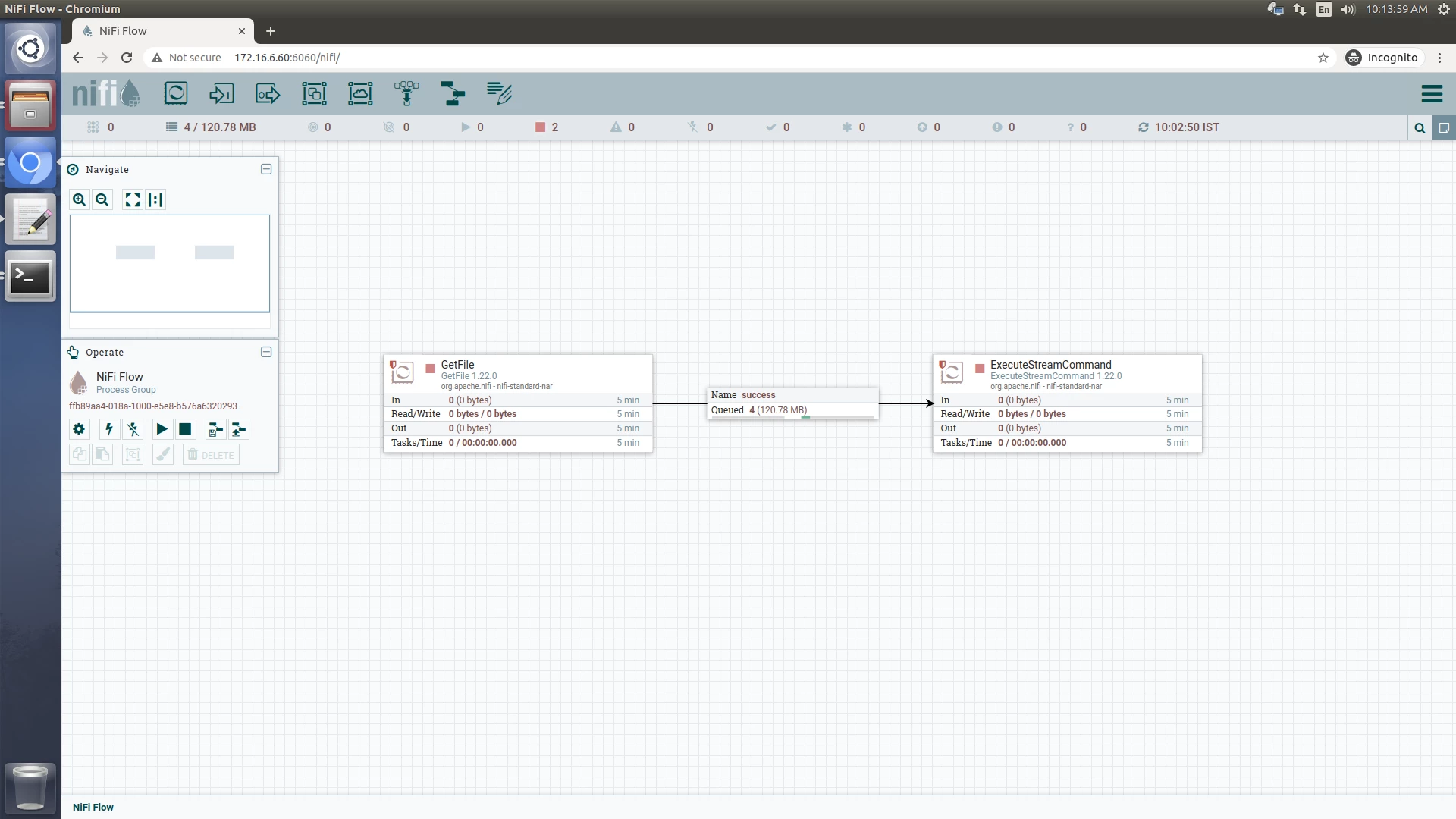

Here is one of such sample pipe line that we have constructed
we have two processed one is Getfile which checks for files present in a local folder. Once they are available it sends them to the execute stream command.

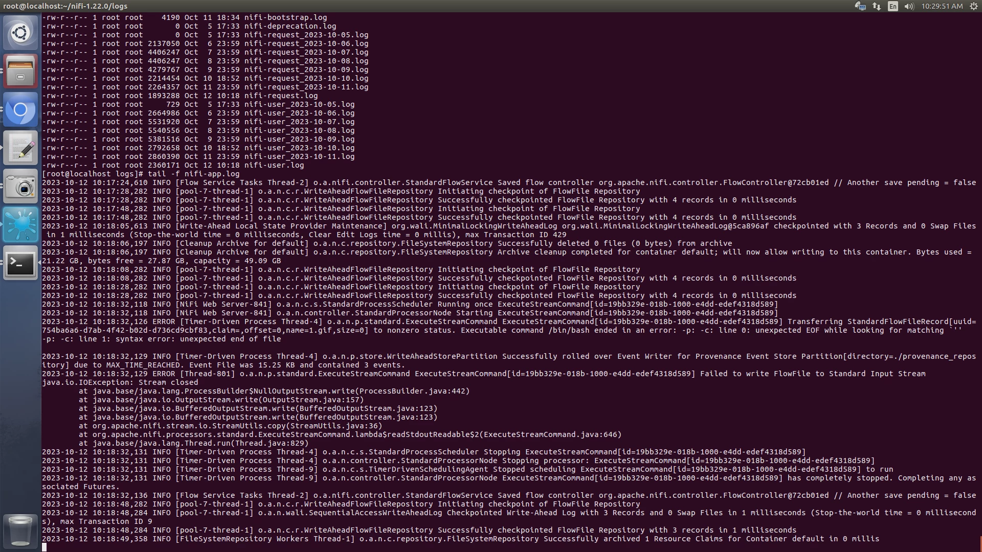

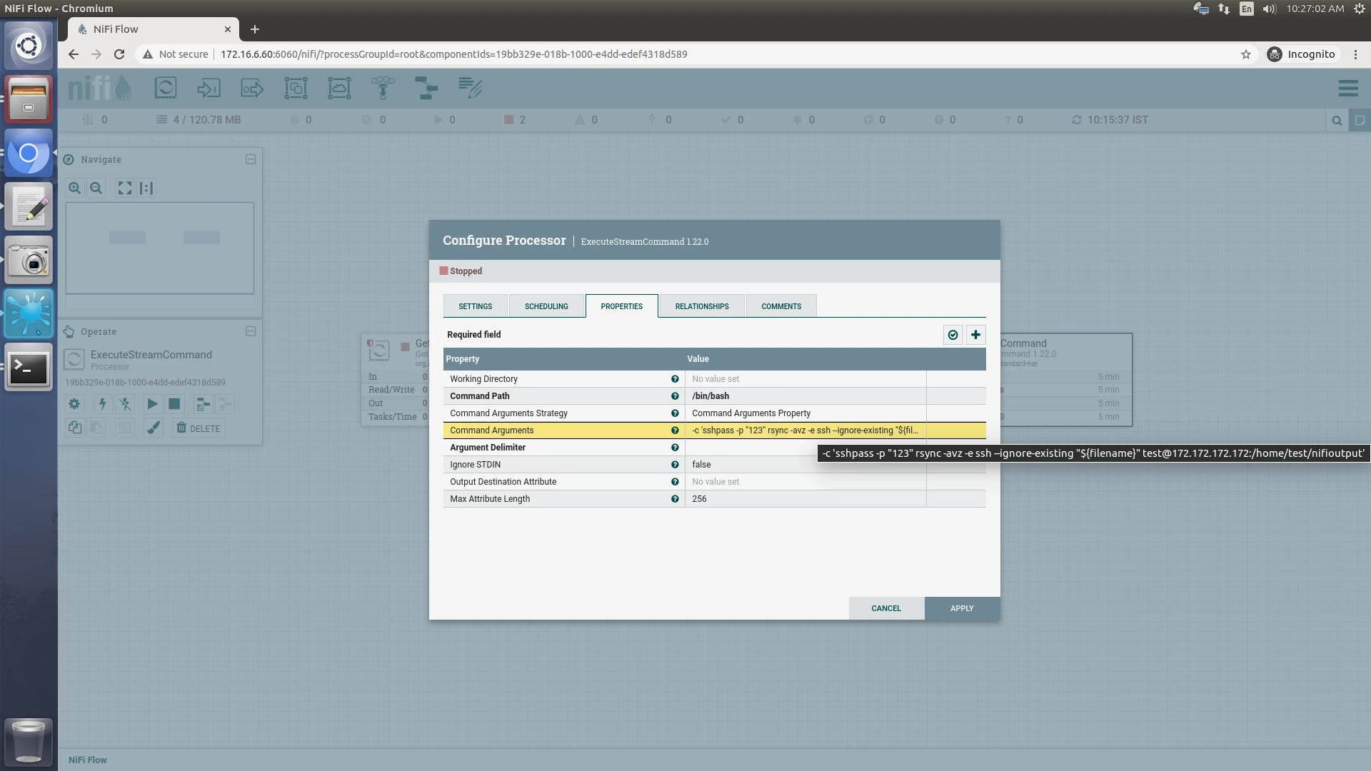

execute stream command we want to send file that we received from getfile step to a remote linux server. The destination linux server doesn't have an FTP server hence cant use putFTP. This is the command I want to execute to transfer the file
sshpass -p '123' rsync -avz -e ssh --ignore-existing "${filename}" test@172.172.172.172:/home/test/nifioutput

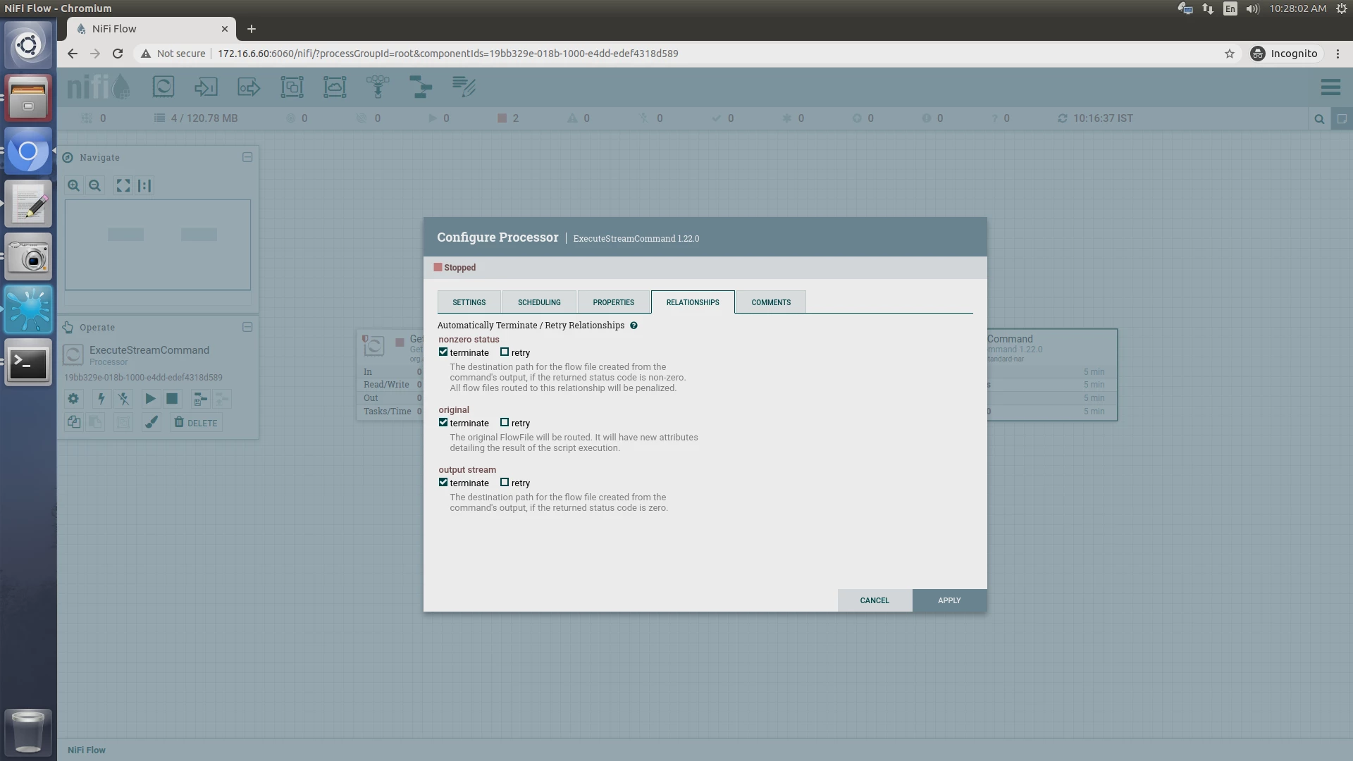

Here is the configuration for execute stream command
 log file
Any help would be greatly appreciated.

put your command in a shell script named yourscript.sh and make sure NiFi has execute permissions.  rsync can be very slow so make sure you have a long timeout on the command.   i have seen rsync take 5 minutes to 20 hours.

Is there a way that I can see the log or else the complete scipt Nifi is trying to execute. This is the complete script that I want to execute
sshpass -p '123' rsync -avz -e ssh --ignore-existing /test.pdf test@172.16.4.59:/home/test/nifioutput

it's very hard to format a long call like that without wrapping it.   also you will need to fully list out directories so not /test.pdf but /the/actual/location/even/if/it/s/giant/test.pdf.  it may work.   you may also need to do /usr/bin/sshpass.   it is always easier to just write a simple runme.sh with the text in it, make it executable and test it.    also make sure nifi user has permissions to sshpass and if you are running on a cluster that all machines have that binary and have permissions
