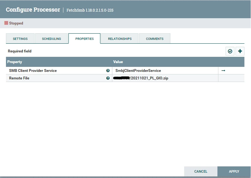

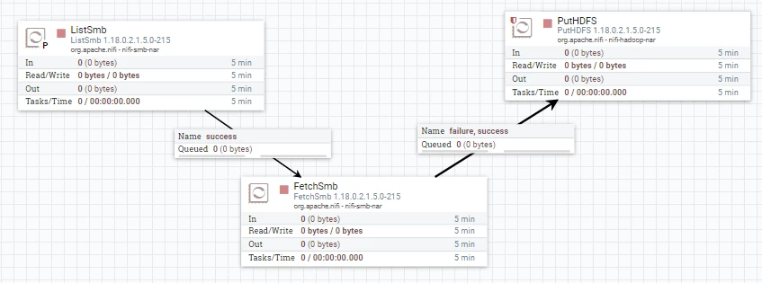

My workflow is pretty simple, I have ListSMB which reads from a shared network directory, connected to FetchSMB which should get 1 file (the processor forces you to put the path of a specific file or it won't work) and finally PutHDFS to write all the files in a distributed file system (hadoop).
  • I don't / can't understand why whenever I use List and Fetch in tandem the pipeline will just take all the files it can find on the directory specified in the List processor but won't write to the HDFS the single file I specified on the Fetch, instead it will write on the HDFS all the files from the List. The fetch, directly connected to the HDFS, should pass only a single file. What am I missing here ? What is the purpose of the fetch if it is "by-passed" by the list processor ?

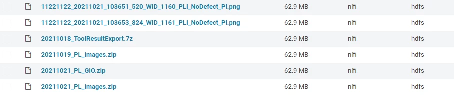

  • On top of that, all the file written to the HDFS will pick the same weight (KB or MB) of the single file I specified on the Fetch, resulting in many files being broken / corrupted.
As you can see from the pic above. They SHOULD NOT have the same weight.
I thought that list + fetch were used primarily to move big data, but then I ask myself why the Fetch processor wants me to indicate the path of a specific file and then ignore it ?

Dataflow (pretty simple):

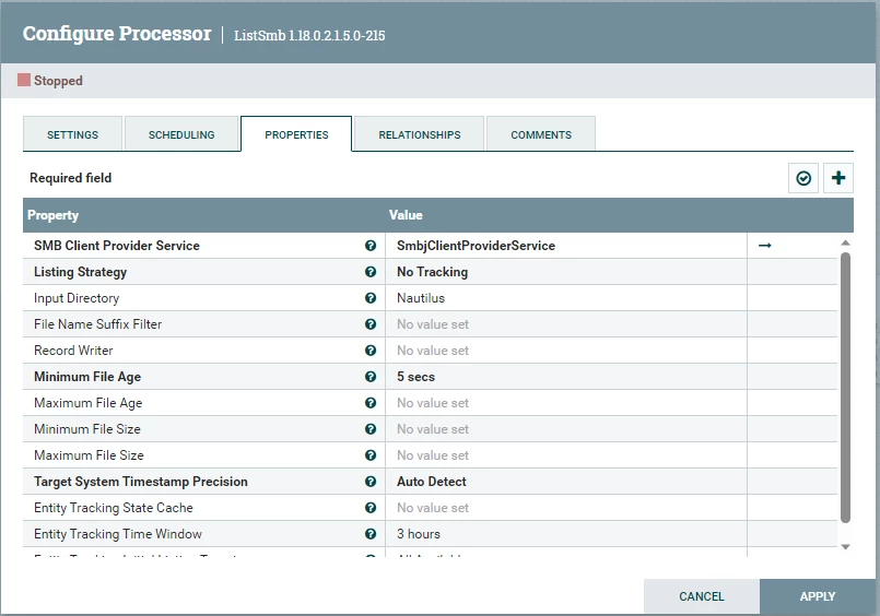

ListSMB:
(I am using "no tracking" just to make testing easier and faster. In prod we will have to set up a tracking strategy.)
FetchSMB:

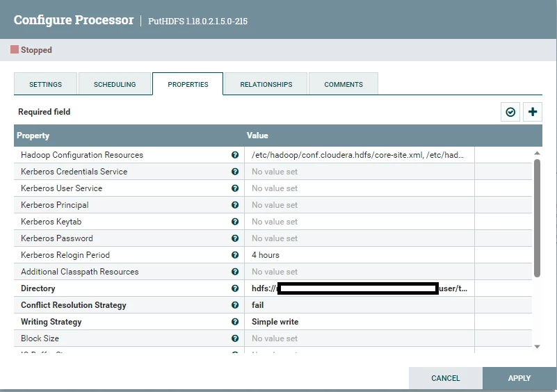

PutHDFS:

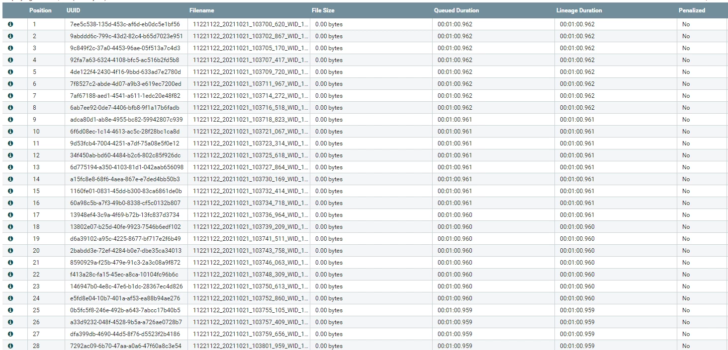

This is a sample screenshot of the queue list (between the list and the fetch processors):

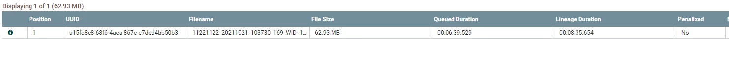

This is another screenshot of the queue (between fetch and putHDFS processors)
As you can see the "file size" is over 60mb, but it's just a .png which should be no more than 300kb. 60mb is the file size of the file specified in the properties of the Fetch processor (20211021_PL_GIO.zip)

The "list<type>" processors are designed to optimize distributed processing of files from sources that may not be NiFi cluster friendly.  They are designed to simply list the contents of the target input directory and produce a single 0 byte FlowFile with metadata about the content.

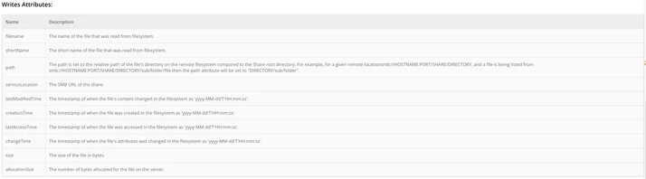

Example of what FlowFile Attributes are created by the ListSMB processor:

Finally these now distributed 0 byte FlowFiles are sent to the Fetch<type> processor that should be configured to use the metadata/attributes on the FlowFile to retrieve the content for each listed FlowFile and insert in to the FlowFile content (after Fetch<type> processor, FlowFile size will no longer be 0 bytes).

1. You configured listSMB with "no tracking" which means it will retain no state on what was previously listed.  Without state, every execution of the listSMB will result in listing the same source files over and over again.
2. Each listed file becomes its own 0 byte FlowFile with a bunch of added attributes.  You are then passing that to your FetchSMB processor.  The default configuration of the "Remote File" processor property is "${path}/${filename}" which would take the value from the FlowFile attributes "path" and "filename" to fetch the content for the FlowFile.  You have instead misconfigured this property to always fetch the same content no matter which FlowFile is being processed.  So you are inserting the same content in to every one of your unique FlowFiles (each listed FlowFile has a filename that is persisted).  That is why you see same weight/size for all your fetched FlowFiles.
You might try configuring your listSMB processor Input Directory to point at the full path to the single file you want to list.  I have not tried this as the intended usage is listing everything from within a target directory.  If that does not work, you could use a routeOnAttribute processor to route only the FlowFile with the specific filename you are looking for to FetchSMB and terminate unmatched.
Also keep in mind the your ListSMB is by default going to re-list the same File(s) over and over because you have it configured with "no tracking" and default run schedule is "0 sec" (which means schedule to execute as fast/often as possible)
Your PutHDFS appears to be working as expected, your issues seems purely in your upstream configurations.
ListSMB:
FetchSMB:
PutHDFS:

@JohnSilver Open the queue list between list/fetch and look at the content of flowfile (0.00 size).  Take the (i) or the (👁) in the list to go deeper.   Also inspect the attributes tab attached to the flowfile.  Looking for file names, path, etc...  those bits need to be parsed to fetchSMB as attributes, and then the right file will be fetched for putHDFS.
