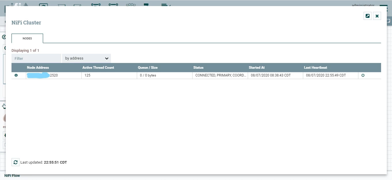

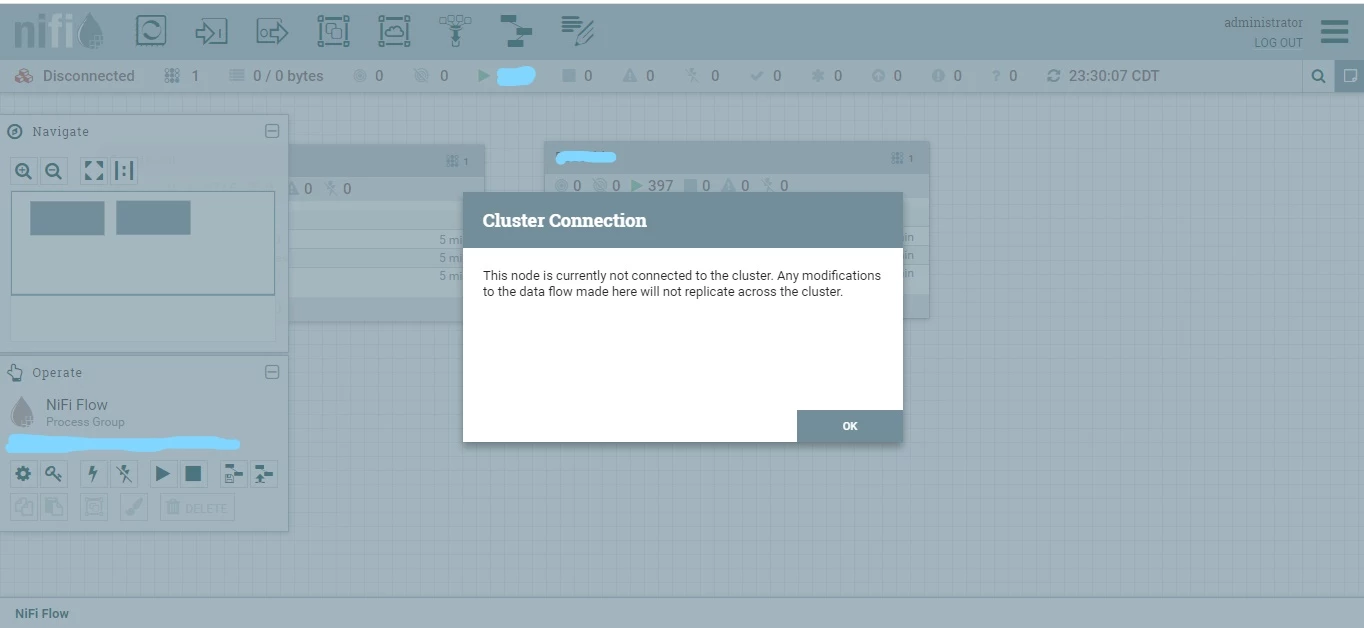

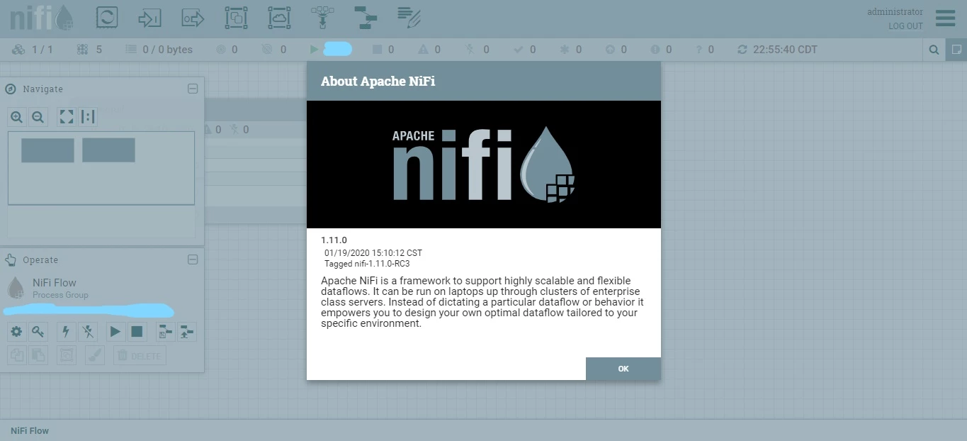

Above are infinite logs and even it will start the Nifi. Once I am trying to access the nifi from the browser then I am getting cluster connection error message. Please see below screenshot for your reference.
Its quite surprising for me. As If I am starting the server with in cluster with single zookeeper string, I am able to start without any issue. Single node is getting into cluster properly.

Just to give few more details to above my reply. Below is the version of the Nifi I am using for clustering,
Also if you can see in the screenshot, this nifi is in clustered with below entries in configuration file,
nifi.properties
nifi.zookeeper.connect.string=192.168.0.10:2182
zookeeper.properties
server.1=192.168.0.10:2777:3777;2182
state-management.xml
<property name="Connect String">192.168.0.10:2182</property>
Below below is the screenshot of the clustered node,
These all screenshot which I have shared in reply in my both the comments are latest (like are of same day or day before I am commenting).
