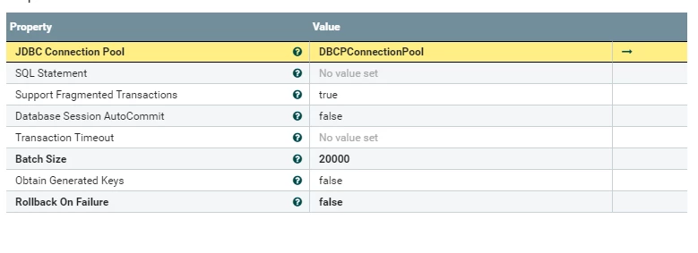

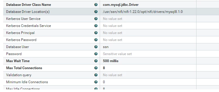

I'm encountering occasional Exception when using PUTSQL processor in apache Nifi.
I have already Increased innodb_lock_wait_timeout But I'm still encountering the error occasionally. How can I fix this error? And what are the optimal configurations when using putsql processor to insert large volume of records into mariadb?
Variable_name;Value
innodb_lock_wait_timeout;300
Error Snippet:
2023-11-24 18:04:45,837 ERROR [Timer-Driven Process Thread-51] o.apache.nifi.processors.standard.PutSQL PutSQL[id=c7255d17-018b-1000-143e-fc839881330c] Failed to update database due to a failed batch update, java.sql.BatchUpdateException: Lock wait timeout exceeded; try restarting transaction. There were a total of 1 FlowFiles that failed, 14 that succeeded, and 0 that were not execute and will be routed to retry;
at com.mysql.cj.jdbc.exceptions.SQLError.createBatchUpdateException(SQLError.java:224)

The reported behavior with Lock wait timeout in Mysql/MariaDB is not in control of NiFi PutSQL, You have to check your DB Table for possible issues.

@ckumar is Correct.   For large volume ingestion into the receiving host, you need a maria db host that can handle 1000s of transactions per second.   Nifi can easily exceed default configurations for total connections.   With a well tuned highly available mariadb,  you can crank up execution time and concurrency on nifi and get 10,000s+ transactions per second.
