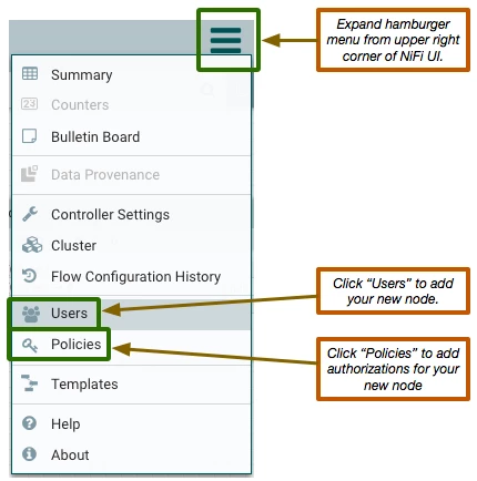

The admin will use the NIFi UI to add additional users and authorize them for various access policies:
Users are managed and Global Policies are applied as follows:
Adding "Users" within NiFi has nothing to do with user authentication. The users you add here are for authorization to NiFi resources only. User Authentication must occur first and can be accomplished using User issued certs load in browser, Kerberos, or LDAP.

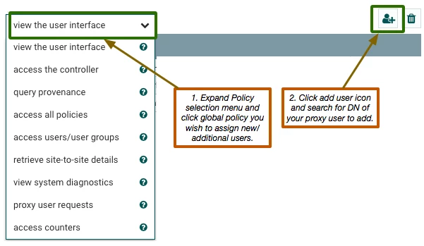

Global access policies include the following:

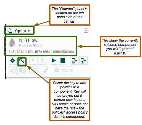

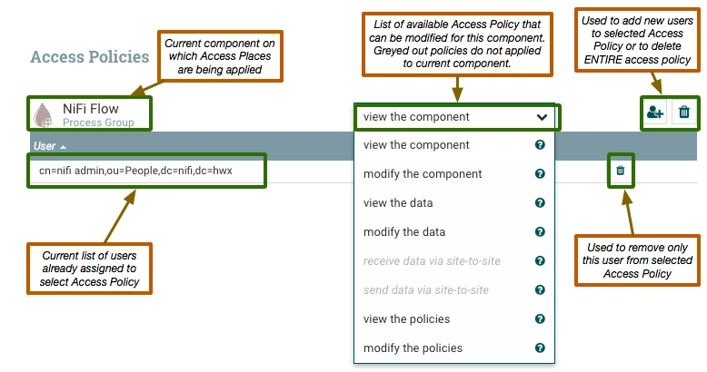

Component (Processors, process groups, and other things on canvas) level access policies are assigned to users as follows:
Component level access policies include:
Some Component level access policies are on available to specific components. If the currently selected component does not support the policy it will be greyed out in the list.
