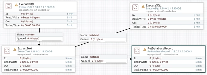

ExecuteSQL --> ExtractContent --> Route "success" relationship twice (once to ExecuteSQL to perform delete ad second to PutDatabaseRecord to write to DB).  Similar to below example:
You'll notice that the "matched" relationship has been routed twice.  When the same relationship is routed twice, NiFi clones the FlowFile (original goes to one connection and clone goes to the other.  Both FlowFiles reference the same content claim (which remember is immutable). When ExecuteSQL (delete) the executes on one of them it does not impact the content in the other one that is going to PutDatabaseRecord.

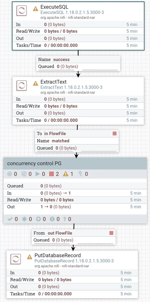

So if there is a dependency that the ExecuteSQL (Delete) completes before the PutDatabaseRecord executes, there is a third option that utilizes the "FlowFile concurrency" and "outbound policy" settings on a Process Group.
The dataflow would look something like this:

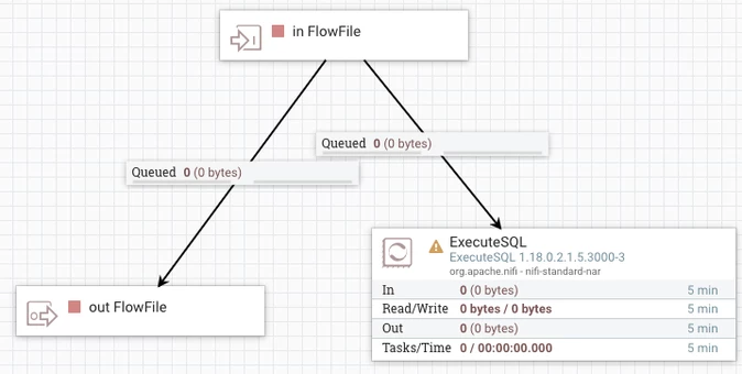

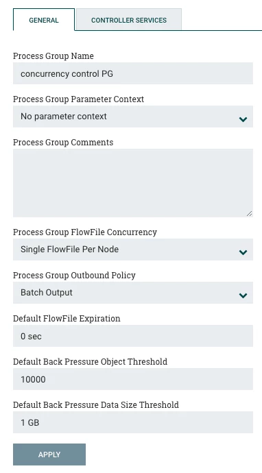

Inside the Process Group configured with "FlowFile concurrency = Single FlowFile Per Node" and "outbound policy = Batch Output" set, you would have this flow:
So you Dataflow only allows 1 FlowFile to enter the PG at a time.  Within the PG, the FlowFile is cloned with one FlowFile routing to the output port and the other to the ExecuteSQL (delete).  the FlowFile queued to exit PG will not be allowed to exit PG until the FlowFile being processed by the ExecuteSQL (delete) is auto-terminated or routed to some other output port.   This makes sure that the PutDatabaseRecord processor does not process the FlowFile with the original content claim until your ExecuteSQL (delete) was executed.

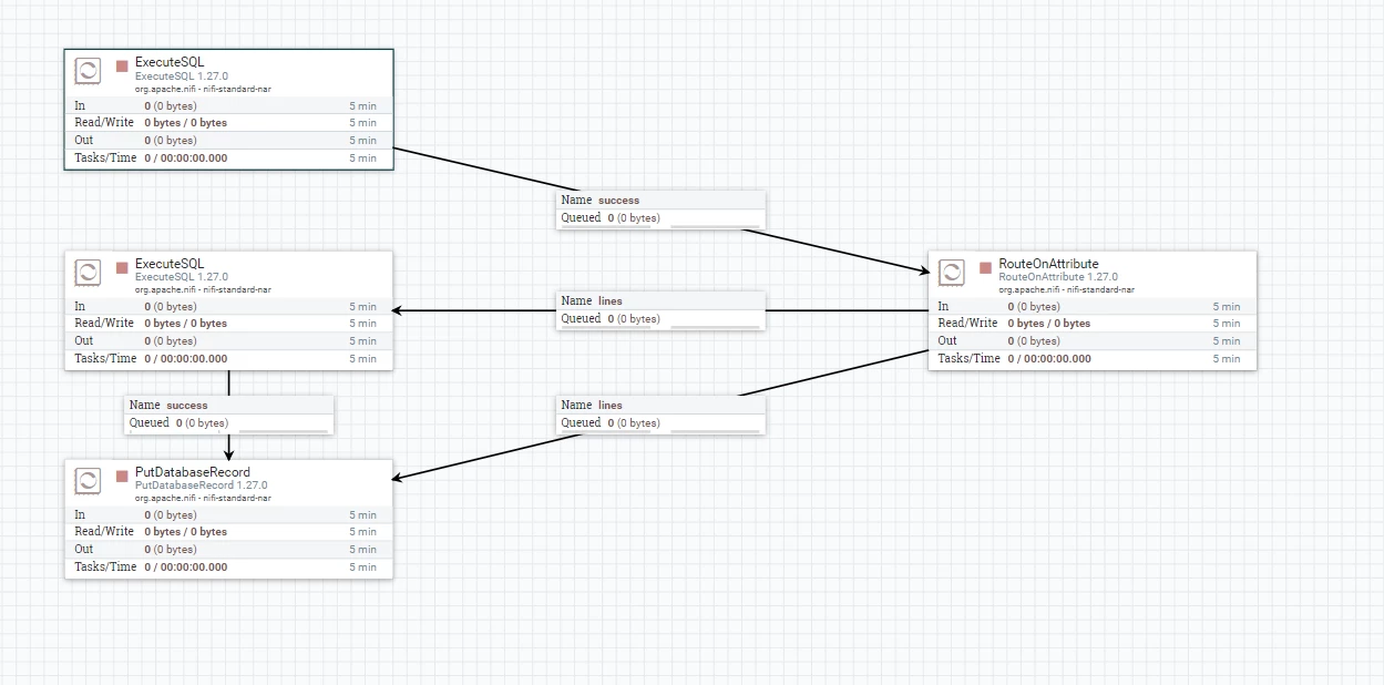

Good afternoon MattWho, so I'm going to attach an image, maybe it will be clearer, your answer was very enlightening, but if I clear up those doubts about my question, your answer will be even clearer.
Well, I'm doing the process of deleting data from a local bank, and inserting the entire database again, but why am I consulting the value before deleting? why do I need to check if the query returned values, if it didn't, I can't delete the database, that's why this order of processors that I explained, in short the process I would like to execute would be ExecuteSQL (query data in source database) -> RouteOnAttribute (if there are no lines, it will follow another path) -> ExecuteSQL (deletes the data from the local database, i.e., destination) -> PutDatabaseRecord (insert the base again into the destination database).

Your shared dataflow image shows:
1. ExecuteSQL (query data in source database) -->(produces a FlowFile that contains 0 or more rows) -->
2. RouteOnAttribute (evaluates the "executesql.row.count"? to see if it is "0"?  If so, routes the "0" row flowfiles to the "lines" relationship?.  Or are you auto-terminating within RouteOnAtrtibute if row count is "0" and lines relationship is used only if "executesql.row.count" is not "0"?)
3. I see the "lines" relationship is routed twice.  Once to another ExecuteSQL (deletes the data from the local database, i.e., destination) and another directly to PutDatabaseRecord (since PutDatabaseRecord has to inbound connections that will have a FlowFile, it will execute from both which is not what i think you want to happen.)
Just considering the above, I think option 3 which utilizes the "FlowFile concurrency" and "outbound policy" settings on a process group would handle you timing needs.  Where your RouteOnAttribute goes in place of the ExtractText processor and you feed lines into the child Process Group.
