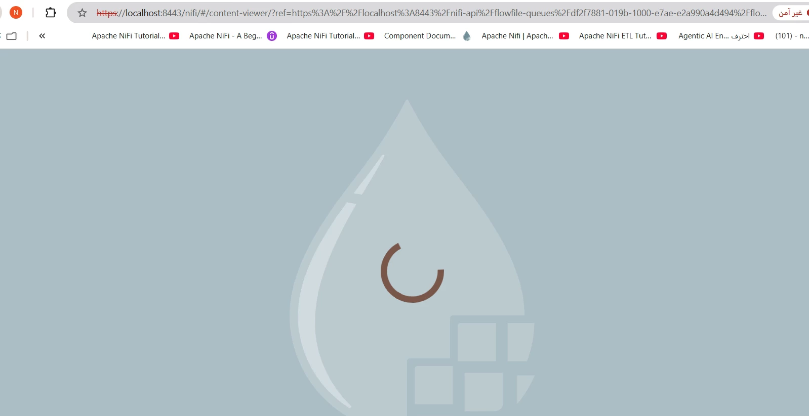

Question
Apache Nifi - Unable to communicate to Nifi when trying to view the file content of Generate FlowFile
I am new to Apache. I have generated files using Generate Flow File processor but when I try to view the file content it gives me UI error "Unable to communicate to NiFi" I think there is a problem with content file viewer in NiFi.
I am using https and port 8443 and also when I download the file the content in the file appears all okay just that it's not working in the browser!

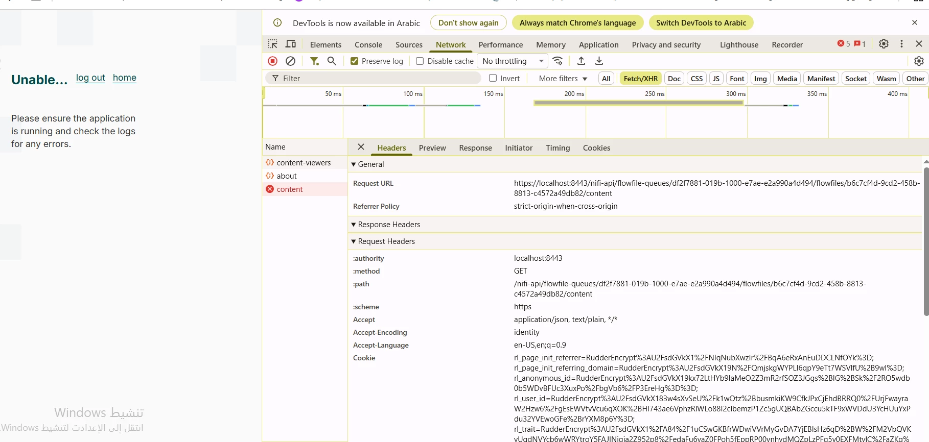

When you try "view content", it should open a new browser tab where it would load the content viewer.  I assume this new tab is being opened where you then see the exception?
Try opening the "developer-tools" available in your browser.  Then try to refresh the tab and you see the requests and response made.  Somewhere in that you should see your exception being thrown as a response.
That info may give more insight into what your issue is loading the content viwer.

Runa27
Runa27Author
Gold ⭐️
Jan 24, 2026 4:01 PM UTC
@MattWho
1. I am using java version 21
2. Using Windows 10  Version number (22H2)
3.  I am using Chrome. Tried to use Mozailla it's still same problem.
when I click "view content" it open a new tab with request "https://localhost:8443/nifi/#/content-viewer/?ref....." then immediately it changes to "https://localhost:8443/nifi/#/error" I have opened the DevTools and tried to see the response but nothing appears in the response tab  . I am trying to solve this from last week
Translate
