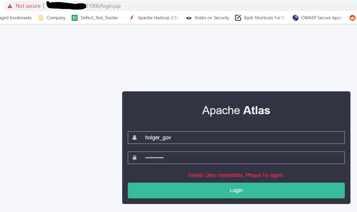

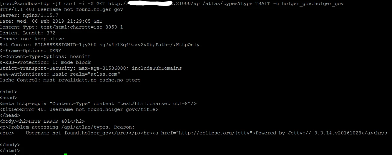

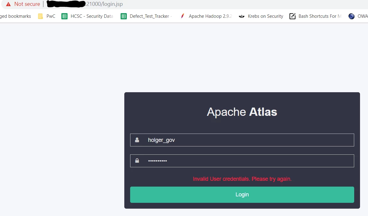

I am working on HDP sandbox and trying to login into ATLAS UI with user holger_gov and same as password however it give me invalid credentials. Looked for a solution on this community however it did not fix my issue
chnaged the authorizer to simple and restarted but did not work so changed it back to ranger and tried again.
I see that atlas user is in the OS shown in screenshots
Some of the screenshots detailing my situation are shown below

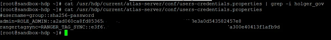

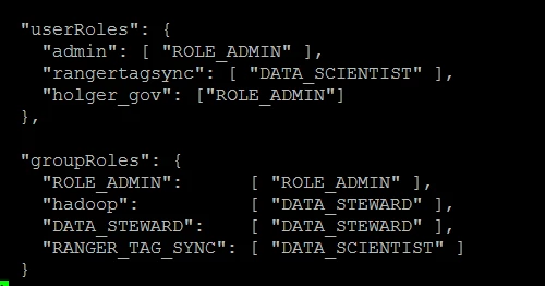

@dhieru singh can you please check if user holger_gov exists in users-credentials.properties stored in directory /usr/hdp/current/atlas-server/conf/
Translate
dhieru
dhieruAuthor
Gold ⭐️
Feb 11, 2019 10:33 PM UTC
@Nixon Rodrigues Thanks for the response, appreciate your help
No there is no holger_gov in the users-credentails.properties file.
Attached is the image
how do I add the user holger_gov in here?

Another question? Do I also need to cretae and add policy-store.txt , as of now I do not have any such file in the directory/usr/hdp/current/atlas-server/conf/.
Do not add policy-store.txt for HDP3, Please check if atlas-simple-authz-policy.json present, if not add atlas-simple-authz-policy.json and edit the JSON file to add the role for your user holger_gov or its group.

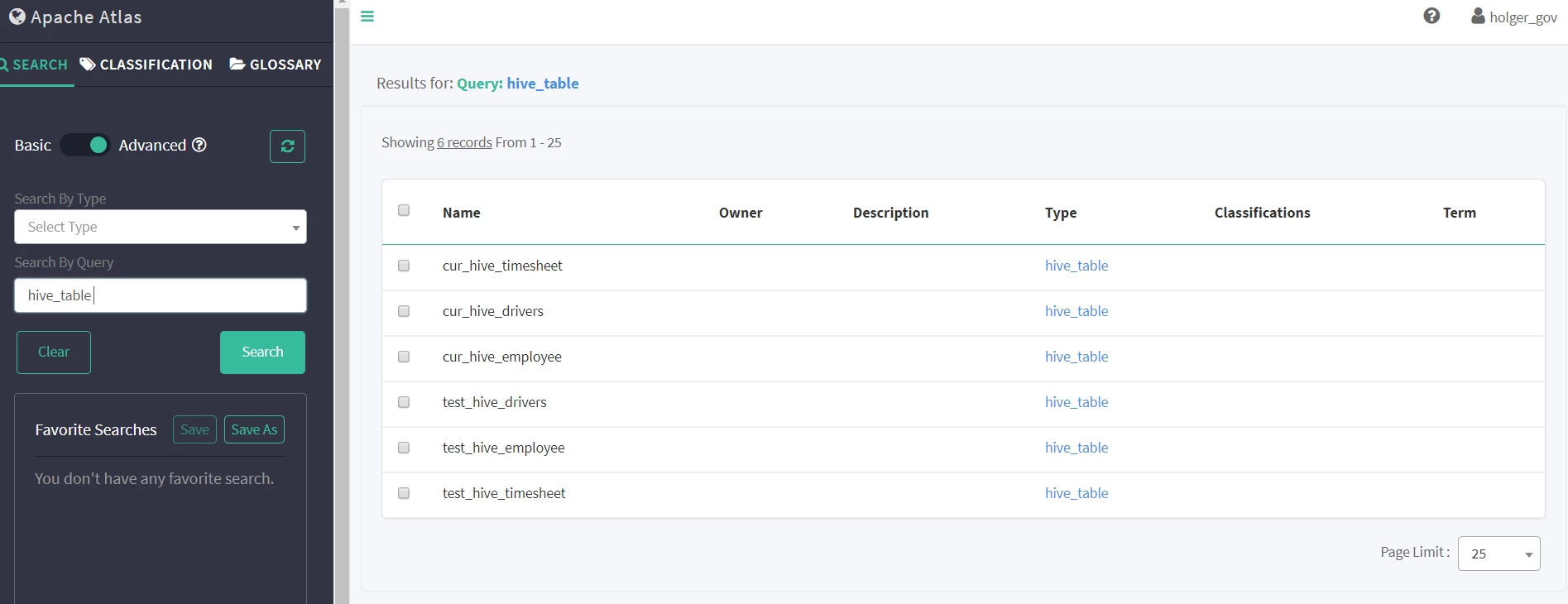

@Nixon Rodrigues Thanks a lot for the help yes it did help I am using HDP3.1 sandbox.
I went ahead and added the user holger_gov in the userRoles section as shown below
however I am not able to see the metadata of hive tables and lineage in Atlas UI. The Atlas UI looks like below

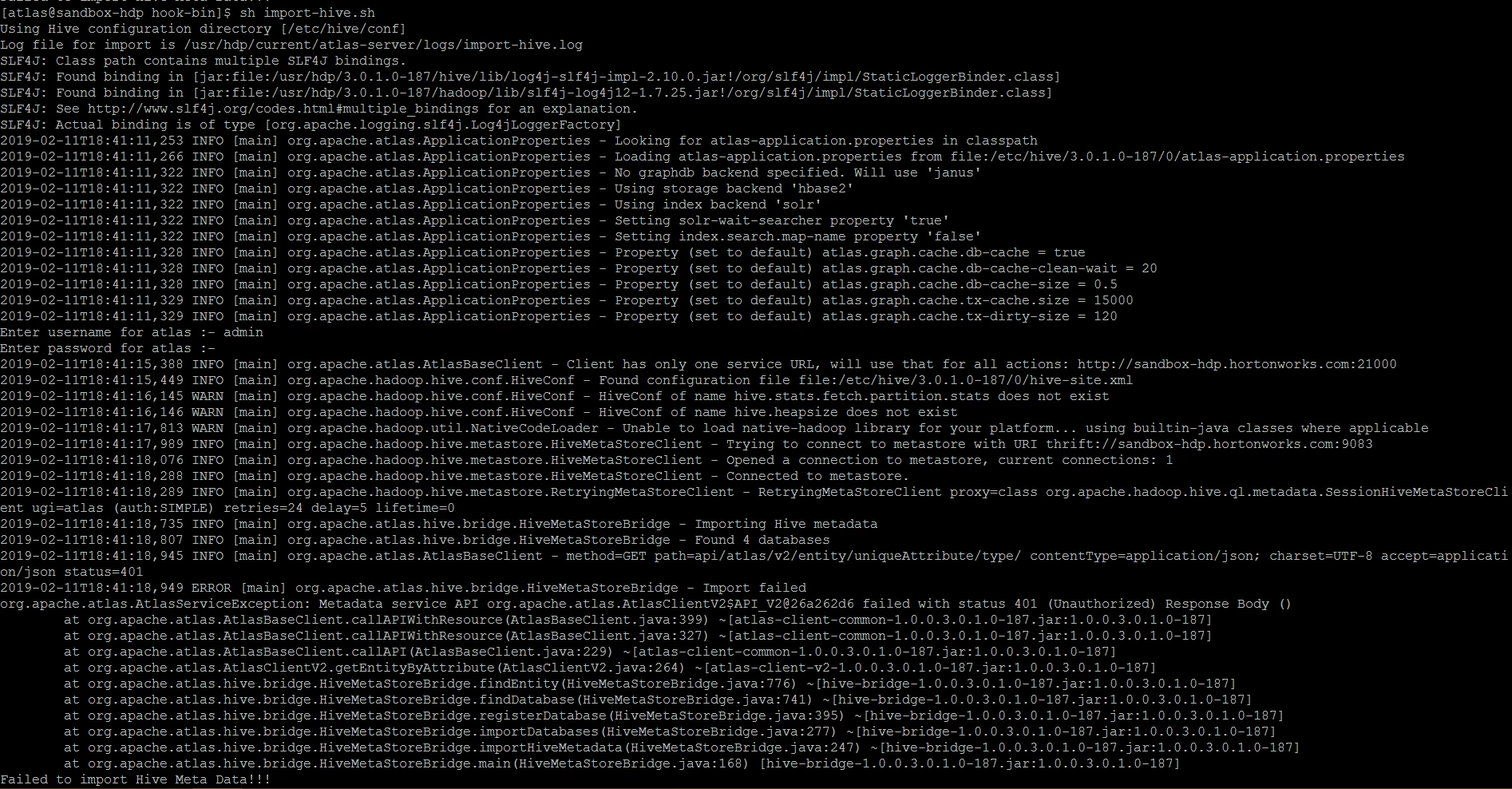

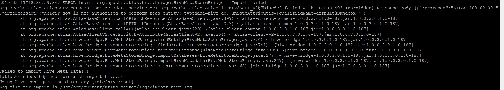

In addition when I searched in this community, they advised to run hive-import.sh, when I did that, I receive the following error using "holger_gov" as user
using "admin" as user

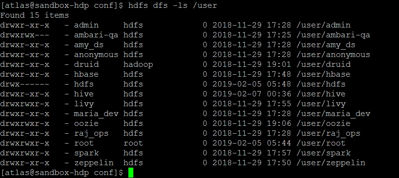

Is this related to ranger? when I to hdfs dfs -ls /user I do not see holger_gov user, but then admin is there so admin should work.

@dhieru singh, If you enable atlas .authorizer.impl = ranger, then you need to add policies in ranger admin for atlas service.
You can close the thread if above answer have resolved the issue.

@Nixon Rodrigues I have tried adding ranger policies for atlas service however there is something I am doing wrong, probably I will ask as a different question. Thanks a lot and appreciate your help.
