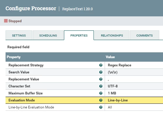

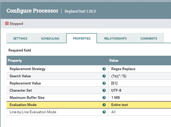

Not sure if there is a reader\writer that can work semi-structured data. You can develop your custom reader\writer but that will be an effort. Since you are getting your input as multiple json records lines you can either use SplitText processor to split each json record into its own flowfile and then process each record independently, or convert the input into Json array using two ReplaceText processors ( see screenshot below), then use QueryRecord & UpdateRecord with JsonTreeReader\Writer.
First ReplaceText: replace line break with comma
2ed ReplaceText: Surround the entire text with []
