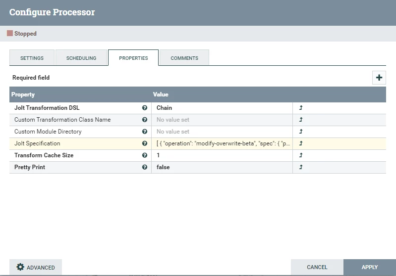

You have a few options here. Replace text could do the trick with some regex expression but it can get quite complex. I would suggest you use the JoltTransformJSON processor.
The follow JOLT Specification will work for you considering your flowfile have the title, id, and contact-name attributes. Replace accordingly.
"operation": "modify-overwrite-beta",
"spec": {
"parameter": {
"Title": "${title}",
"ExternalId": { "Id": "${id}" }
"spec": {
"UnregisteredContacts": { "[1]": { "ContactName": "${contact-name}" } }

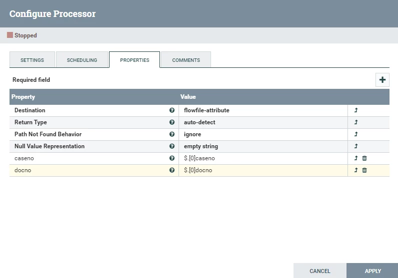

As for the properties, I'm assuming you meant attributes. The JoltTransformJSON supports Expression Language (EL) with Variable Registry and FlowFile attributes. This means you can access any attribute in your flowfile with EL syntax, as
${attributeName}
If your flowfile (that reads the XML file) Content is a JSON, you can extract values from the JSON and turn them into attributes with the EvaluateJsonPath processor as below:
Then you can use these attributes in the JoltTransform with the syntax written above.

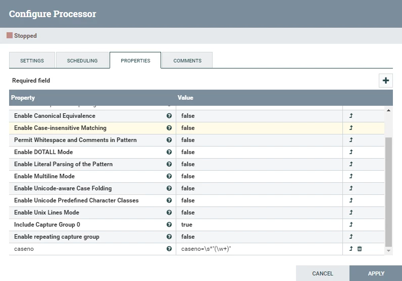

However, if the flowfile content is not a JSON and EvaluateJsonPath does not serve the purpose, you can try extracting the information within the FlowFile and turn them into attributes using the ExtractText processor.
Let's say teh XLM FLowFile content is:
<property1="FieldValue1">
<caseno="foobar">
<property2="FieldValue2">
You can use the syntax below to extract the caseno field and set it as an attribute in the FlowFile
caseno=\s*"(\w+)"
