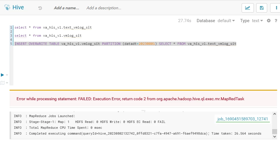

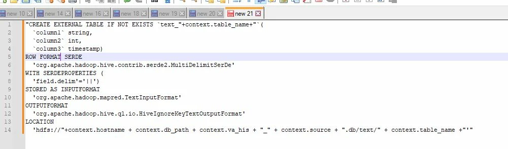

After Multi Delimiter Issue is solved. I got an error with data insertion.

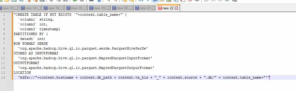

So, after the data successfully inserted to text file format table with rowserde hive.contrib.serde2.MultiDelimitSerDe. Then i need to insert those data to parquet format table.
But when i ran the query to insert data, it failed.

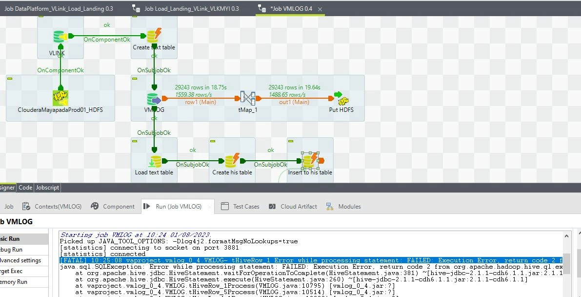

Error message: "[FATAL] 10:25:08 vaproject.xxx tHiveRow_1 Error while processing statement: FAILED: Execution Error, return code 2 from org.apache.hadoop.hive.ql.exec.mr.MapRedTask".

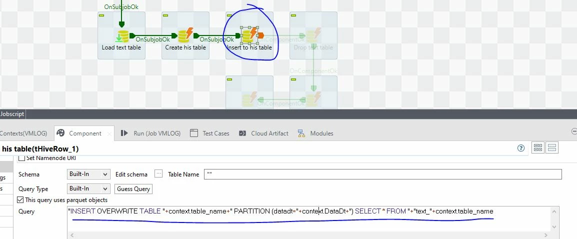

I used this script:
"INSERT OVERWRITE TABLE ParquetTable PARTITION (datadt=dateint) SELECT * FROM TextFileTable"
What is wrong or what am i missing? Please need your help. Thank you.

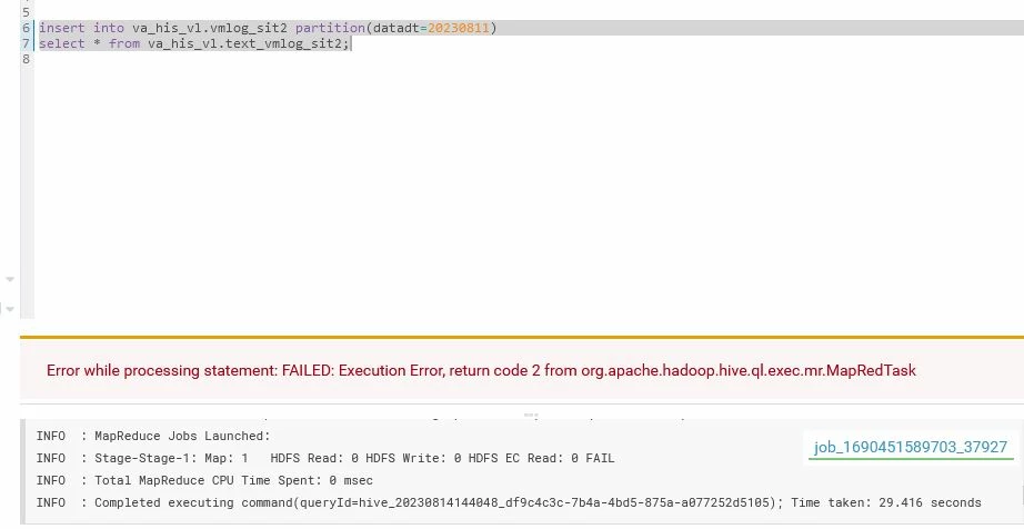

Sorry took a long time to reply,
I couldn't find that application_id anymore. So i try new task, just simply data insertion query with application_id = application_1690451589703_37927
In log file i think i found the error. It is written
"Caused by: java.lang.RuntimeException: Map operator initialization failed
at org.apache.hadoop.hive.ql.exec.mr.ExecMapper.configure(ExecMapper.java:137)
... 22 more
Caused by: org.apache.hadoop.hive.ql.metadata.HiveException: java.lang.ClassNotFoundException: Class org.apache.hadoop.hive.contrib.serde2.MultiDelimitSerDe not found
at org.apache.hadoop.hive.ql.exec.MapOperator.getConvertedOI(MapOperator.java:326)
at org.apache.hadoop.hive.ql.exec.MapOperator.setChildren(MapOperator.java:361)
at org.apache.hadoop.hive.ql.exec.mr.ExecMapper.configure(ExecMapper.java:106)
... 22 more
Caused by: java.lang.ClassNotFoundException: Class org.apache.hadoop.hive.contrib.serde2.MultiDelimitSerDe not found
at org.apache.hadoop.conf.Configuration.getClassByName(Configuration.java:2409)
at org.apache.hadoop.hive.ql.plan.PartitionDesc.getDeserializer(PartitionDesc.java:170)
at org.apache.hadoop.hive.ql.exec.MapOperator.getConvertedOI(MapOperator.java:292)
... 24 more

Sorry i cant share the log file.

@itdm_bmi We are still seeing the error "java.lang.ClassNotFoundException: Class org.apache.hadoop.hive.contrib.serde2.MultiDelimitSerDe"
This means, you have not uploaded the "hive-contrib" jar to Hive classpath as mentioned here.
If you are on CDP(>7.1.5 onward) then, we will not have to upload hive-contrib jar to the class path. This serde class is already added to Hive native serde list.
You just need to alter the original table, and change the serde(Note: only applies to CDP version > 7.1.5)
ALTER TABLE <table name> SET SERDE 'org.apache.hadoop.hive.serde2.MultiDelimitSerDe'
If you are on an older version, do consider uploading to hive-contrib jar to hive classpath by uploading this to aux jar path location.
