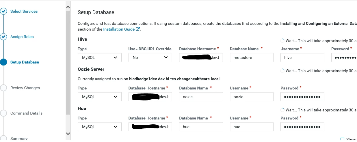

Hello All,
    I've installed CM manager 6.3.0 and agents in my 7 node cluster. While setting up the CDH 6.3.1 installation, i'm stuck at setup database step, where the test connection is running for more than 2 hours, with only info found in Cloudera manager log given below.
There is no error or any other information. I can successfully connect to my databases from command line. But CM is unable to verify the connections.
Any help will be appreciated.
2019-12-11 21:48:41,016 INFO scm-web-93:com.cloudera.enterprise.JavaMelodyFacade: Entering HTTP Operation: Method:POST, Path:/dbTestConn/testConnection
2019-12-11 21:48:41,036 INFO scm-web-93:com.cloudera.enterprise.JavaMelodyFacade: Exiting HTTP Operation: Method:POST, Path:/dbTestConn/testConnection, Status:200
2019-12-11 21:48:43,071 INFO scm-web-93:com.cloudera.enterprise.JavaMelodyFacade: Entering HTTP Operation: Method:POST, Path:/dbTestConn/checkConnectionResult
2019-12-11 21:48:43,081 INFO scm-web-93:com.cloudera.enterprise.JavaMelodyFacade: Exiting HTTP Operation: Method:POST, Path:/dbTestConn/checkConnectionResult, Status:200

@pauljoshiva
I was reading the following doc:  https://docs.cloudera.com/documentation/enterprise/6/release-notes/topics/rg_cm_631_known_issues.html
Which says "Many Cloudera Manager wizards, including Installation wizards and Add Service/Role wizards, cannot be completed when using Microsoft Internet Explorer version 11.x. To work around the issue, use another supported browser.
Can you try with a slightly different browser to see if it works.

@pauljoshiva ,
What browser are you using? Are you using IE?

Yes i'm using IE

@pauljoshiva
