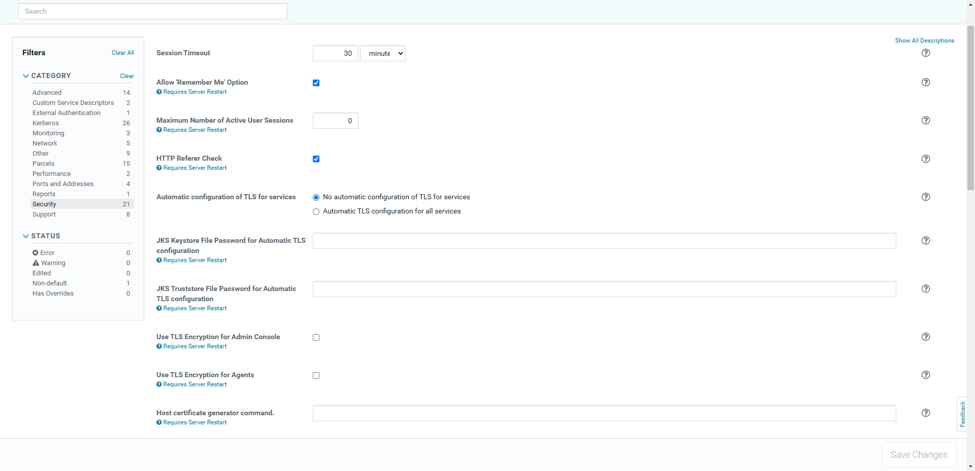

I don't this is a Auto-TLS issue at this point. As use_tls=0 which means TLS is not enforced from the agent level
Could you please check /var/log/cloudera-scm-agent/cloudera-scm-agent.log to check this further
Also which TLS are you using on CM is it Auto-TLS or Manual TLS? If this is Auto-TLS, are the certificates signed by CM (Auto-TLS usecase 1) or your Custom CA (Auto-TLS use case)?

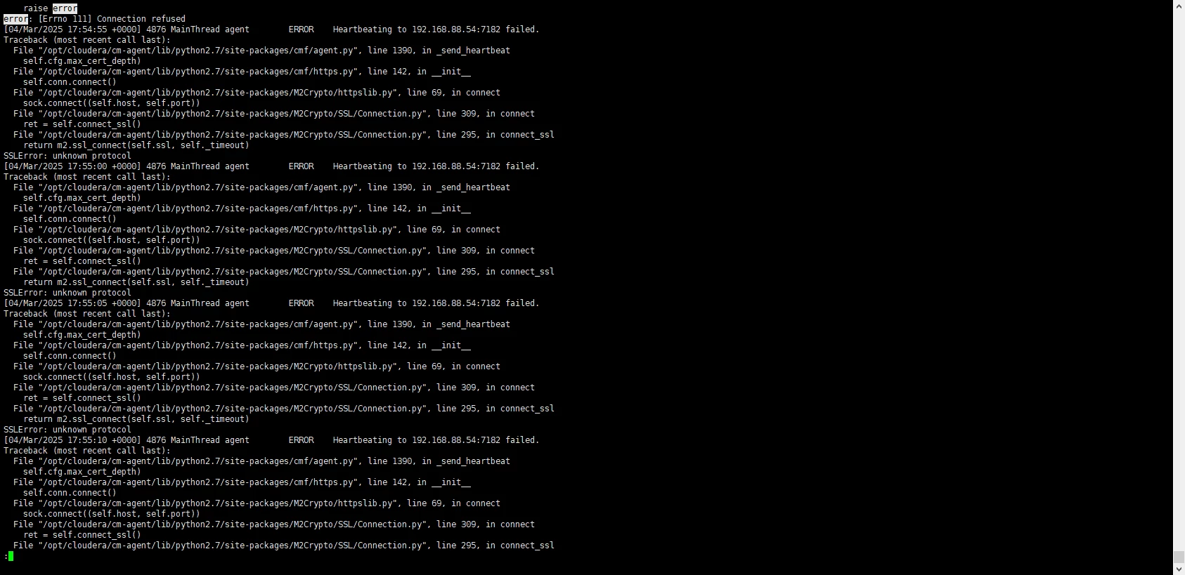

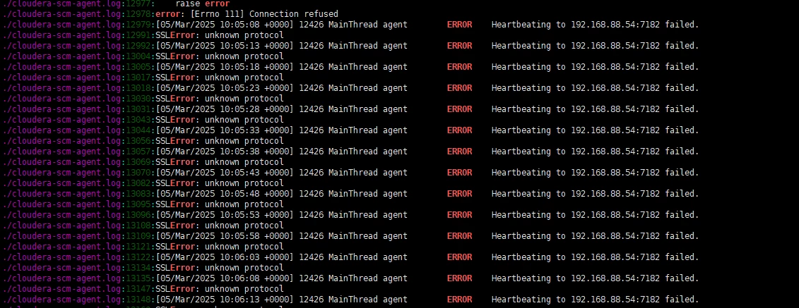

hello @upadhyayk04
Thanks for your reply, I did not enable tls. The following is the error log of /var/log/cloudera-scm-agent/cloudera-scm-agent.log. This is my first attempt to deploy this, and I hope to get your help

Can you please confirm is 192.168.88.54
I think is getting an SSL from somewhere. Can you go to CM UI >> Administration >> Settings >> Click on Security and check if TLS is enforced on the agent from CM UI
Translate

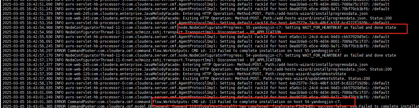

c) Except for the error information in the following pictures, other logs do not contain error information
d) /var/log/cloudera-scm-server/cloudera-scm-server.log No error is displayed. Only one agent fails to be deployed
