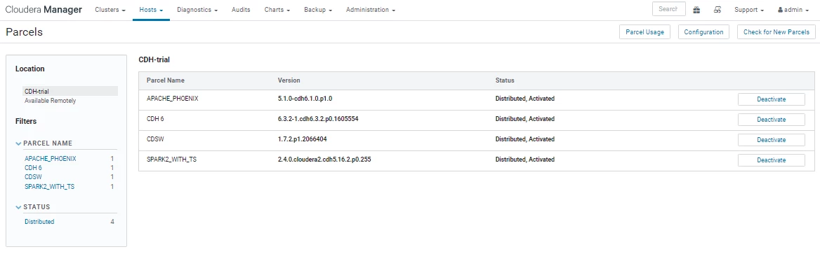

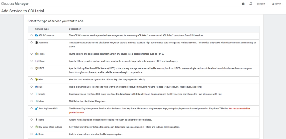

Trying to add to a CDH 6.3.2 cluster (managed with CM 6.3.1) a CDSW 1.7.2 trial on two new hosts (master and worker). The CDSW parcel is downloaded, distributed and activated. Unfortunately the CDSW service is unavailable in the cluster's "Add Service" list.

Attaching also two screenshots.

The *.jar file is already in /opt/cloudera/csd/ and have restarted the CM server. Otherwise I would be unable to distribute and activate the CDSW parcel, isn't it?
Let me say it again – the problem is with the CDSW service after the parcel distribution and activation. I do not see the service in 'Add a Service' window, as outlined in the installation guide:
