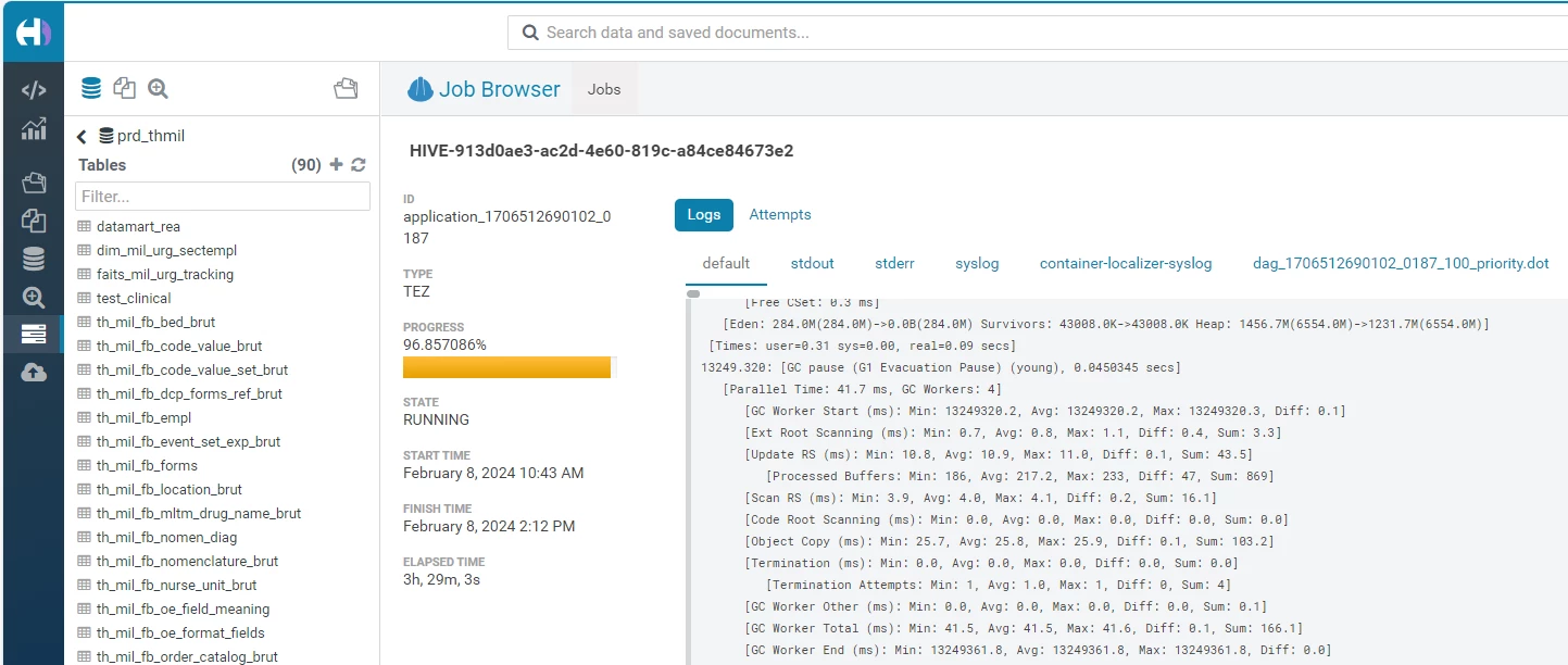

We are running Cloudera CDP 7.1.7 and Cloudera Manager 7.4.4 but when we access Hue UI we can only browse Jobs :
2024-02-08 14_32_24-Hue - Job Browser et 1 page supplémentaire - Profil 1 – Microsoft​ Edge.png
Do we have to follow links given in the article ?

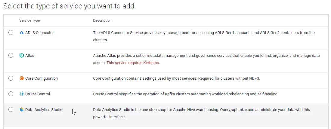

Because when I look for adding a new service to our cluster, I can add DAS :
2024-02-08 15_21_39-Add Service to Cluster SAS_Cloudera du CHU de Nantes - Cloudera Manager - Profil.png
but Query Processor is not listed :
2024-02-08 15_22_03-Add Service to Cluster SAS_Cloudera du CHU de Nantes - Cloudera Manager - Profil.png

Solved : As we are running Cloudera Runtime 7.1.7, DAS is not deprecated so we have to use it : https://docs.cloudera.com/cdp-private-cloud-base/7.1.9/runtime-release-notes/topics/rt-pvc-deprecated-das.html
