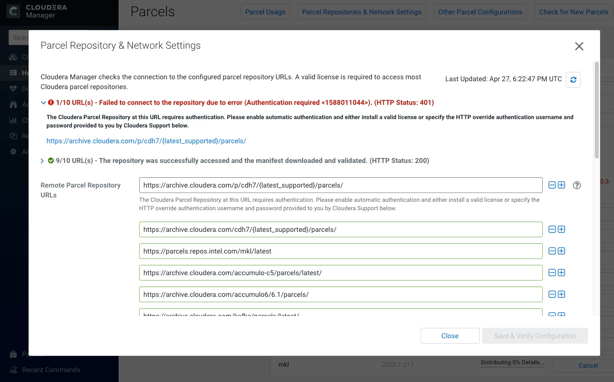

I am installing Cloudera 7 Data Center on AWS m5.xlarge (as a single node cluster) and ran into this problem - logs from /var/logs/cloudera-scm-server
020-04-26 16:26:28,355 ERROR ParcelUpdateService:com.cloudera.parcel.components.ParcelDownloaderImpl: Failed to download manifest. Status code: 401 URI: https://archive.cloudera.com/p/cdh7/7.0/parcels/manifest.json
2020-04-26 16:26:28,355 ERROR ParcelUpdateService:com.cloudera.parcel.components.ParcelDownloaderImpl: Could not retrieve repository info for repo https://archive.cloudera.com/p/cdh7/7.0/parcels/. Got HTTP response code 401
2020-04-26 16:26:28,454 WARN ParcelUpdateService:com.cloudera.parcel.components.ParcelDownloaderImpl: Invalid parcel in manifest : CDH-7.0.3-1.cdh7.0.3.p0.1635019-stretch.parcel
2020-04-26 16:26:34,884 INFO StaleEntityEviction:com.cloudera.server.cmf.StaleEntityEvictionThread: Reaped total of 0 deleted commands
2020-04-26 16:26:34,884 INFO StaleEntityEviction:com.cloudera.server.cmf.StaleEntityEvictionThread: Found no commands older than 2018-04-27T16:26:34.884Z to reap.
I noticed this error at the web UI - under "Parcel Repository & Network Settings" dialog box / under step (4) select your repository.
Cloudera Manager checks the connection to the configured parcel repository URLs. A valid license is required to access most Cloudera parcel repositories.

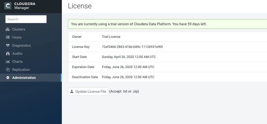

I followed **all those referenced**, went through the links and more!
It bothers me is why am I stuck at this location when this is clearly a 60-day trial version. Let me share two screens that clearly contradict. Parcel is looking for license, Administrator / License says Licensing is okay.
Has anyone installed this version on AWS m5.xlarge (single instance) RHEL 7.6 and not encountered this problem? I have not made any manual modification, configuration changes, tweaking, etc. Disabled SELINUX, set complete hostname with domain, etc., and there are no network (internet) access problems and all AWS settings are okay as well (security groups, NACL, etc.).
Parcel listingParcel listingFrom Administrator / LicenseFrom Administrator / License
